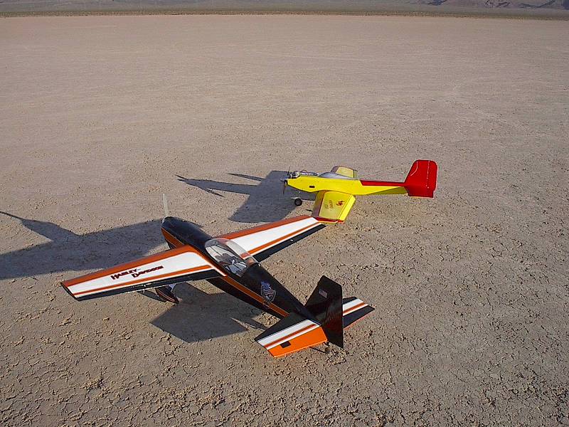

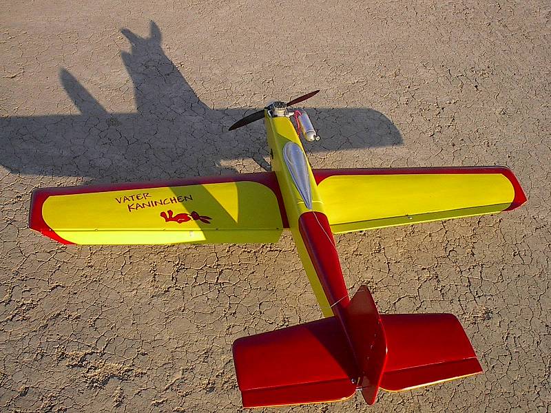

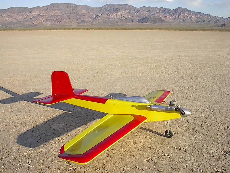

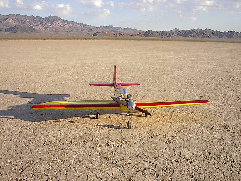

At last, a calm day for the maiden of the Daddy Rabbit, 3mph wind and very warm, it has been 98 all day and I'm lovenit!!
On maiden day Ialways bring out an extra plane or two so today Itossed in my CG Extra. It was a just in case, not in case of a crash, Inever crash
but Ihave had new planes that just didn't work for some small reason? It happens!!
The new Daddy Rabbit is a scratch build from plans, it was the 1966 class three pattern winner at the Nats that year. Ibuilt this little plane as close to the plans as I could, building them stock is not something Ido and this one was hard for me, Idon't build trike gear or ever have an engine sticking up looking at me, it's just really ugly looking and another something Inever do. Trike gear, how girlie!!!
The plane came in at 7 3/4 pounds, it was designed way back in the olden days to come in heavy so it could cope with different wind conditions. Abreak away from ARF thinking!! Iinstalled the SK .91 two stroke engine. This is the first time Ihave ever used this ugly stock muffler too.
Surprise, the SKfired right up, it was in a crash {make that an almost never crashes} last year and just cleaned and tossed under the bench. The surprise was the fuel tank is 8.5 inches away from the carb, that's the front of the tank. Iguess you can say the SK engines really suck!!
The servos are Hitec 5475s for the elevator and rudder and 475s for the ailerons. I used an old HT80 for the throttle and the HT81 for steering. Iused a flex cable for the steering arm to take up any shock to the gear train just in case there is ever an ugly landing. Ihave the steering servo slaved to my rudder, Ifly with an old Futaba 9-C and mixing things like this is very easy.
The big moment, take off roll out, YAWN!!! Straight, maybe there is something to be said for this trike gear stuff?? Lift off, YAWN!! Trim, Four beeps of down elevator. This plane Ihave trimmed at under 1/2 throttle. Most the time Itrim for fullthrottle. Not anymore.
The DR tracks like it was on a rail, Iput it through the Sportsman Know Sequence and it's anti climatic.
Things Inoticed about this plane compared to my Kaos. Any plane Ican remember building was always sensitive to any rudder input, the DR is way different, Ican go from side to side with the rudder stick flying straight and level and it just wiggles it's butt a little?? Itook it up a bit and wonder of wonders it went into knife edge without any drop going either direction?? Ikept playing with the rudder and can't figure this one out. With any of my other planes Iwould have been slipping into a snap roll or some other nasty stunt. The stall test showed straight and level,just sunk the nose down and when Igot the speed back up it just started flying again.
Landings?? Well I'm not used to seeing one of my planes land without bouncing?? This plane only has 1.5 inches of prop clearence and Iflew all morning and still have the same APC up front?? That's not like me at all! Ihave decided that this trike gear makes me look good, take off and landings are straight, turning and coming into my pit is easier then driving a car. I'm liking it!!
The one thing other then the rudderI noticedis how fast this plane is. It is fine as far as take off and landing speed goes but in the air it just hauls mule. Iknow all the old school turn around patterns planes were fast but this one will smoke my Kaos!! Iwill be testing props next time out and may go to a three blade for a little extra breaking?? That;s the fun part of a new plane, all the testing and little trimming to get it to fly like the perfect machine.
I'm happy with it. It lacks that smoothness of an Extra or Yak but what the heck, it's old school pattern!!!
Gene

Looks like a field that I have flown at. about 10 miles or so south of Vegas right? I love that place, it just costs to much to do everything I want out there between the quads, RCs, guns, and gambling I don't think that I could spend more than a week at a time there. BTW beautiful plane.

Ido an outstanding covering job on my planes but in this case it was painted. Itried something different this time. Idid the finish just like Iwas glassing with water based Poly U but left off the glass. That is a no no, from now on Iwill always use the 1/2 ounce glass, it comes out just so much smoother. That and it doesn't get hanger rash as easy. If you saw it in person the paint job really sucks. The Lustercote yellow didn't like the enamel primmer, I used enamel yellow on the wing bottom, that was OK. Iused very OLD Skybrite enamel red but the thinner made it flash off as it was coming out of the gun. It's OK looking if it was my first paint job, but it isn't! From now on Iwill just hold off and use/buy the Klass Kote paint!
That is the El Dorado dry lake bed just down the hill from Boulder, there are DLBs all over the place but this is the one you have seen in magazines. A super group of guys fly out there, very few of the Bennett putzes show up. The gun club is just above the LB, Trap, Skeet, Sporting Clays, 10 stand, rifel and pistol ranges. Nice club, very hard targets!!!
Cross winds are not a problem but we do get them. When the area has the normal ammount of pilots there we can't just land anyplace we want, the trucks and vans tend to get in the way. We set up our pit area so we take off and land north or south so it's usually a head wind. Cross wind landing is something we instructors teach so our students can go to any field and not have problems.
Dead sticks or other problems though are easy to handle without any pucker factor, it's hard to miss 7 sq. miles of runway.
It's not as smooth as it looks though and the off road people seem to think we need the rutts and bumps in our runway. Buttheads like to drive around our area after a good rain. Why anyone would bother going out there to ride is beyond my thinking, Iraced bikes and Buggy's and flat was never much fun? Iguess if that's as good as you are then that's where you go?
