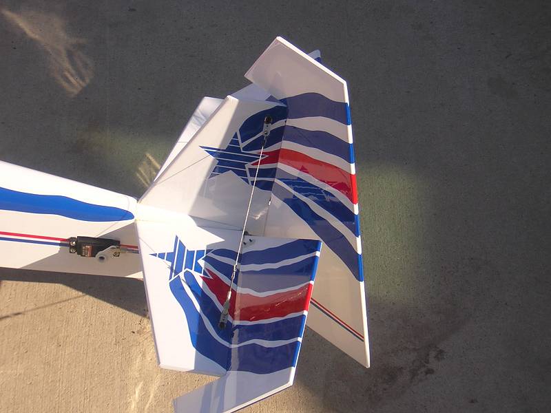

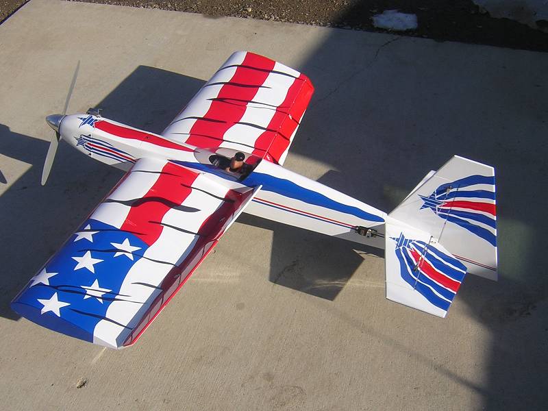

I use flaperons on my blue one, but the RW&amp;B one has actual flaps, and they are kinda fun to play around with, and mix insane stuff into. But my blue one is about 8 ounces lighter, and more fun to fly.

Randy - You did one special job on the RW&amp;B - settin' a standard. I've got my throws reduced to barely "low rates" as I'm currently playing with pattern stuff. My first (RIP) had counters on the elev &amp; rudd like yours and its roll rate was spectacular to say the least (until one wing decided that it didn't want to play with the rest of the plane). After I build my current project (Killer Chaos) for pattern stuff I'll return the SSE to play-time specs.
