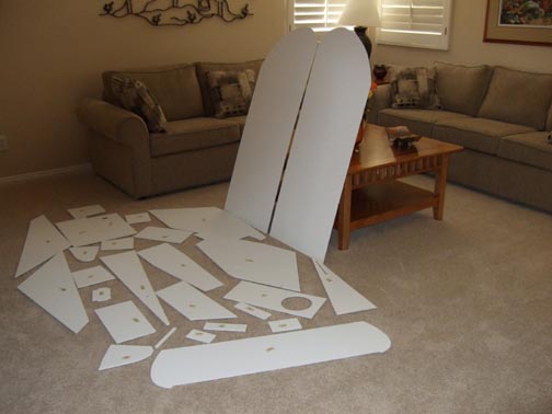

This plane is built primarily of 3/16" foam board. It is huge (108" wing span) and is a weird looking bird. Mine will be powered with an RCS SV-17 17cc gas engine. So far I've:
1) Purchased a semi-kit and plans from Mud Duck Aviation.
2) Cut the foam board parts from three (3) 40" x 60" sheets of foam board. I am in Henderson, NV and I found the form board at Office Max.

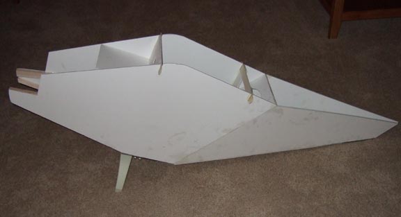

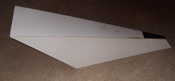

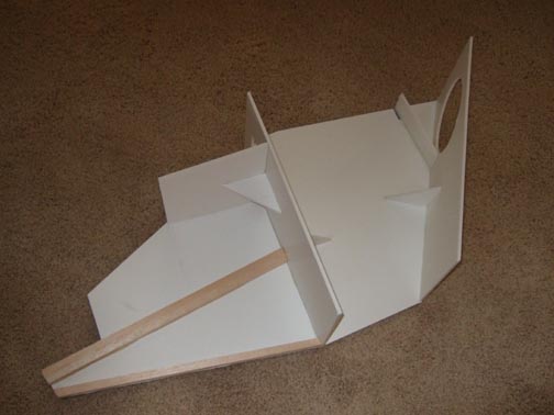

Beginning fuse frame up. I opted to use 5 minute epoxy to glue the foam parts together. I used wood glue to bond the two 1/2" sq pieces together.
I used a screen spline tool to make the creases. It works great.

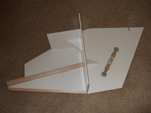

Front fuse ready for left side.

Oversized popsical sticks installed. Fuse is coming along nicely.
I think I'm going to use an Evolution 26GT2 for power. It's a little overkill, but fits nicely.

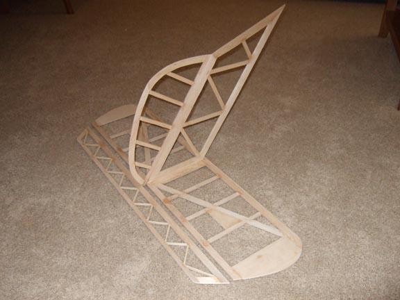

I guess anyone who scratch builds likes to personalize, at least I do. Change #1 - I fabricated tail feathers rather than using the foam core. Don't have to deal with sealing the foam. Probably about the same weight. I'll cover them with Coverite and then paint when I paint the "Duck". I'm also going to add struts to give a little more stability. Have to work the rest of the week so probably won't get much done until the weekend. Anyone esle started theirs?

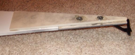

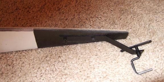

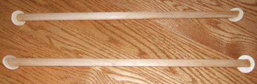

I installed an Ohio Tail Wheel on the fuse bottom. I laminated some .080 carbon fiber plate to 1/8" plywood. Then 3/16 plywood that overlaps the foam board.
I'll use a pull-pull sytem for the wheel and the rudder.

I'm going to use the same technique for the landing gear. I'm using a DuBro Super Strength gear.

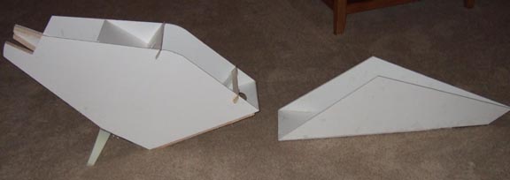

Mounted landing gear and strut clips on fuse. Built the rear fuse section and mated it to the front fuse.
I'm going to use 1/4" DuBro axles with ball bearings instead of the dowel axle. Waiting for a couple parts so I can build the wheel bearings.

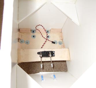

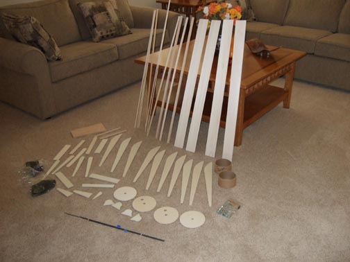

Installed the servo and pull-pull cables for the tail wheel and built the wheels. I fiberglassed the cardboard tubes and the plywood and primed them.

Fabricated the struts for the tail feathers.

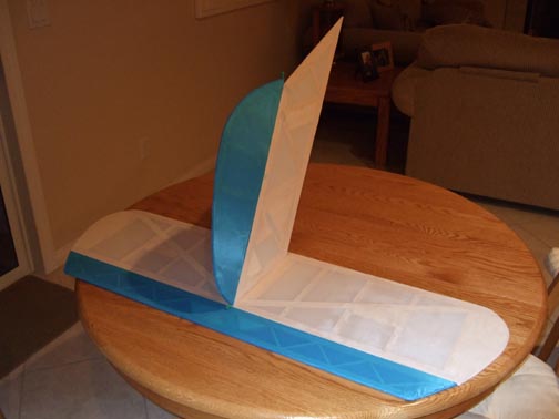

Old 08-31-2009 | 09:27 PM
My Feedback: (219)
Joined: Oct 2003
Posts: 117
From: Henderson, NV
Default RE: Mud Duck MKII Build
Tail feathers covered with Super Super Coverite and ready to mate to the fuse.

Finished the wheels and painted them. One of the tubes that came with the kiit had a huge buldge when I inflated it so I have to get another one.

I just happened across the latests posts here just now. The innertubes you ordered are about to get dropped off at lunch today. You should have let me know you had one with a bulge, I would have just sent a replacement out for you. I will provide a partial refund for the order you just placed.
On a similar note, it was common that you could inflate these to 10", the quality has been slipping among all the inner tube manufacturers (it doesn't matter inside a tire like they are intended to be used, but it shows when just an inflated innertube). I recommend inflating them over a ruler until you get to 9" diameter, I haven't seen any lumps/bulges in my tubes under 9". At that point you can go a 1/4" at a time on each tube and double check for any areas that look like they are going to get swelled up and stop or even let out a bit of air. If you over-inflate the tube and cause a bulge, it will likely be there somewhat even if you let air out, so it is important to inflate in small increments after 9" diameter and do both tubes at each increment. You could feasibly have one tube that makes it to 10" perfectly and the other which will start showing some tendency to bulge at 9.5", if you let out the air from the 10" tube to match the 9.5" tube you will probably notice the tube you let the air out of being "softer" or less "firm" as the smaller one. Inflating them stretches them like you would stretch a ballon to make it easier to blow it up.
