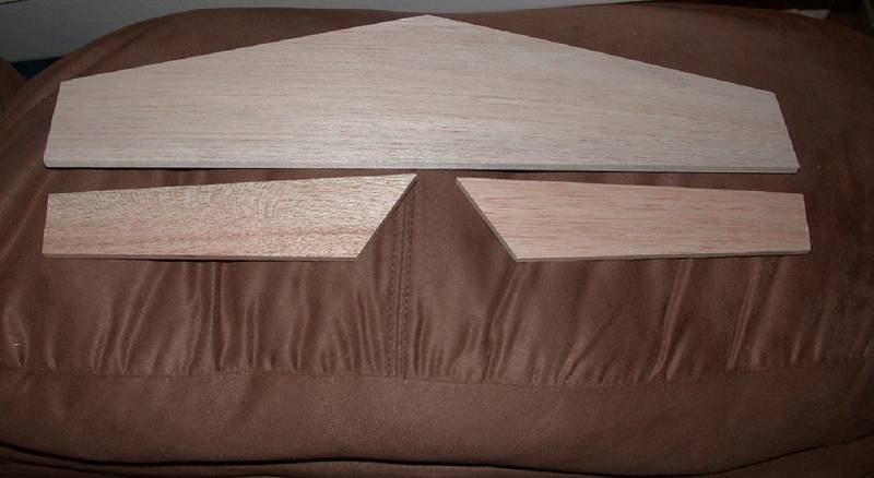

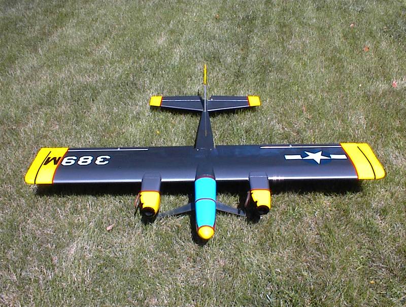

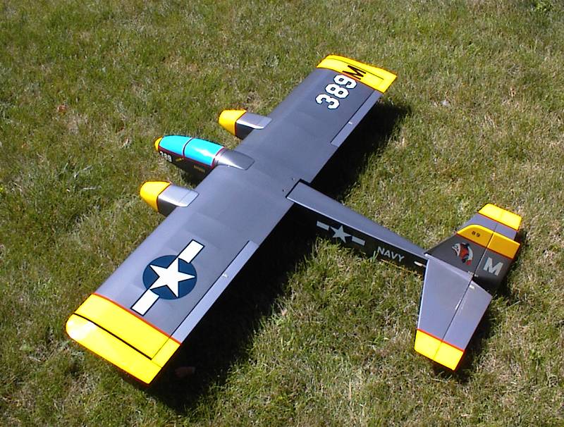

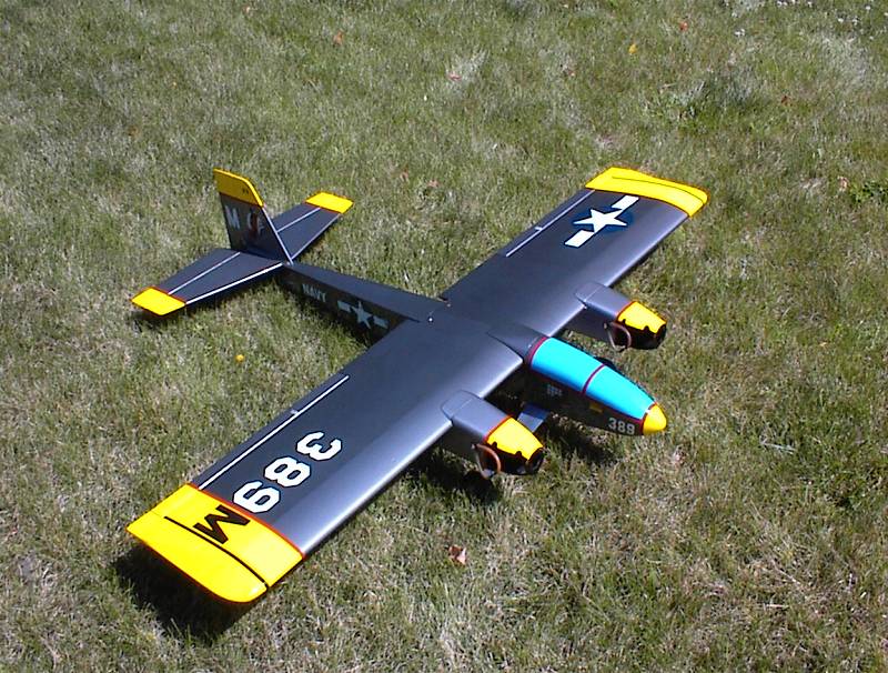

I bought this airplane at an estate sale along with a Coverite Black Baron Special. Both airplanes appear to have been built by an expert builder; a man who insisted on doing things correctly. However, I do not know if the pictured airplane is a scale model, a sport flier, a bashed kit, a scratch built model or simply a kit that I have never seen. I hoping someone here can give me a lead on its identity.
The plane appears to be built for two .25 or two .35 two strokes.

Default RE: Please help ID this airplane
Not a scale airplane. Looks like a 4 star 40 that has been bashed.
they left off the turtle deck...., look at the tail feathers. A nice bash in my opinion

pics include a 4* 40 fin/rudder and stab/elevators, the above is not a 4* modification.
Well, if it is 4*, the only thing they kept was the tail section as the 4* is a LOW wing plan and this is not. Also no dihedral in the wing. No turtle deck.

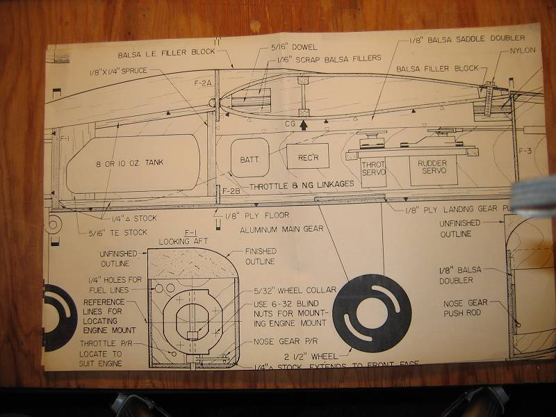

Thanks for your comments and opinions, guys. I think the airplane is closer to the Gemini that it is to the Jetfire in final form, but I have to admit that the Jetfire is a serious candidate for the base kit.
When I bought the airplane I also got a bunch of other items, and some plans and partial plans were included. The only plan that come close to being the basis for this airplane is a partial plan that I found. The builder had made several copies of the wing/fuselage mating area, and I'm attaching a copy of that partial plan. I'm thinking that this is the kit that he bashed to come up with this airplane. Unfortunately, there were no more clues as to the name of the kit. Take a look and see if there is anything I missed.
That looks like a Strikemaster plan.
That is without a doubt, a portion of a Jetfire plan! I think we solved the mystery.

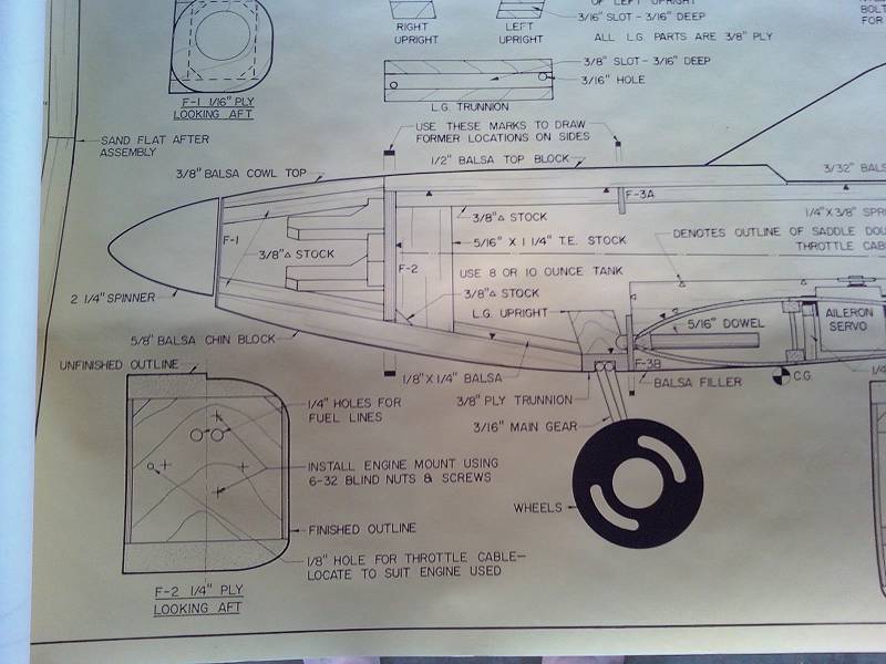

Here are a couple shots of a GM Precision Sunbird plan...Gary Moline (GM) produced the kits for Airtronics...Note the similarities of the plans...Obviously drawn by the same guy....So yes the plans are those of a Jetfire but is the plane a twin Jetfire? Looking forward to comments!
-Johnny-
Johnny, both plans were definitely drawn by Gary Moline; there seems to be no doubt about that! Thanks for nailing that! I had my doubts about the airplane being a bashed Jetfire, but this kind of points to that theory being on target. I thought it was definitely a modified Gemini, but now I don't think so.

Larsen:
You called this one correctly! I have checked the partial print against Aerosphere's copy of the Jetfire 40 print. The partial is the same as the Jetfire 40. The airplane is therefore a bashed Jetfire 40. There is no longer any doubt.
