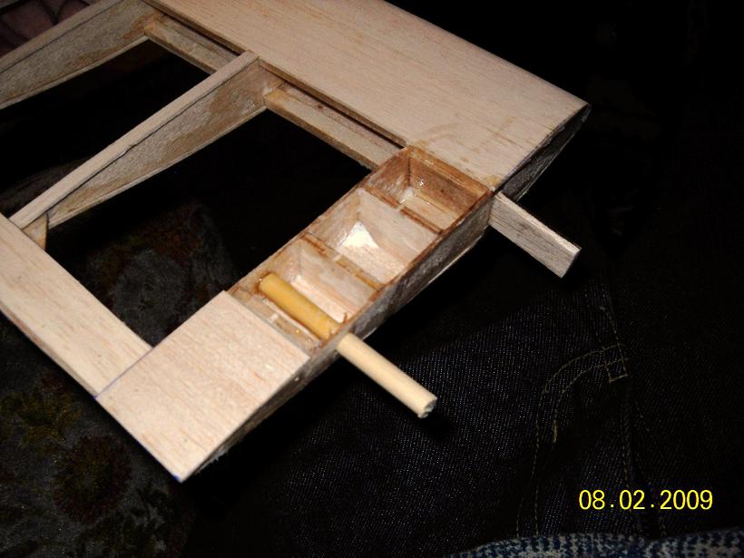

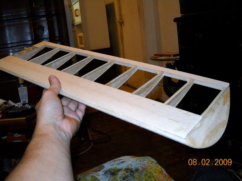

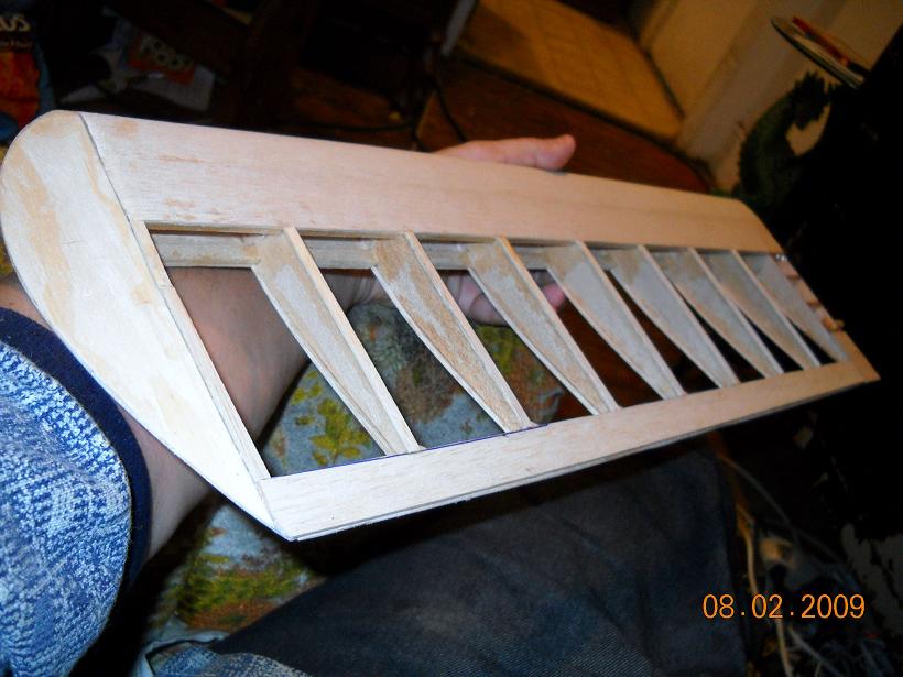

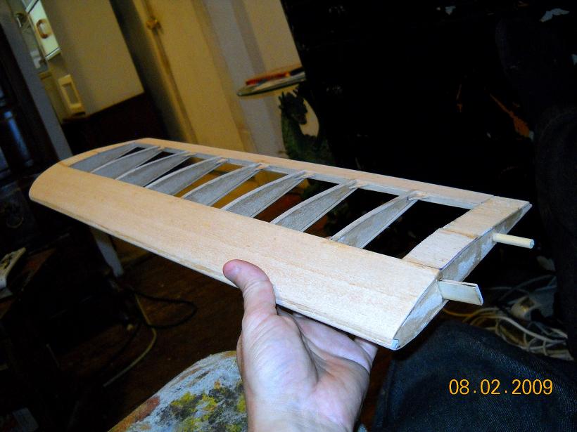

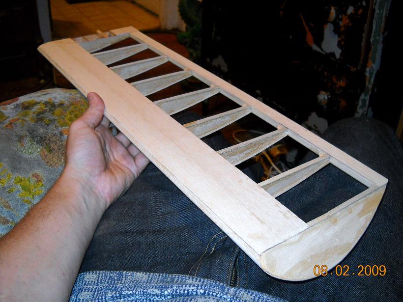

Gene has asked me to post this thread of his Mini Telemaster that is being converted to a .10 size glow, with my help.
One of the modified wing panels is complete. He wanted a stronger wing as it will not be electric powered.
Mods:
sheeted wing
cap strips
joiner brace doubled in width
additional dowel joiner at rear
He has decided he wanted the O.S .10 LA, 2oz tank, with Hitec HS-81 servos, and a 4.8V 350Mah NiMh
