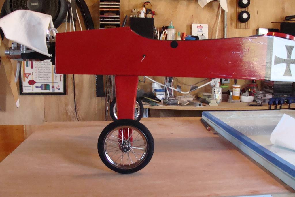

Scott,
Here's my forty size with a Saito 82.
Pure Fun,
Bob

hi bob - your ugly looks really cool - i notice you've put the elevator or is it the rudder servo at the rear underside - and where did you get those cool wheels?
Old 08-24-2009 | 06:58 AM
Joined: Oct 2005
Posts: 1,993
From: Deland, FL
Default RE: Ugly Stick modifications
Hi Scott,
The rear servo is for the tail wheel and the
wheels are from Top Flite.
Bob
