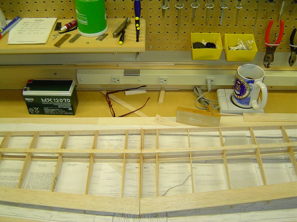

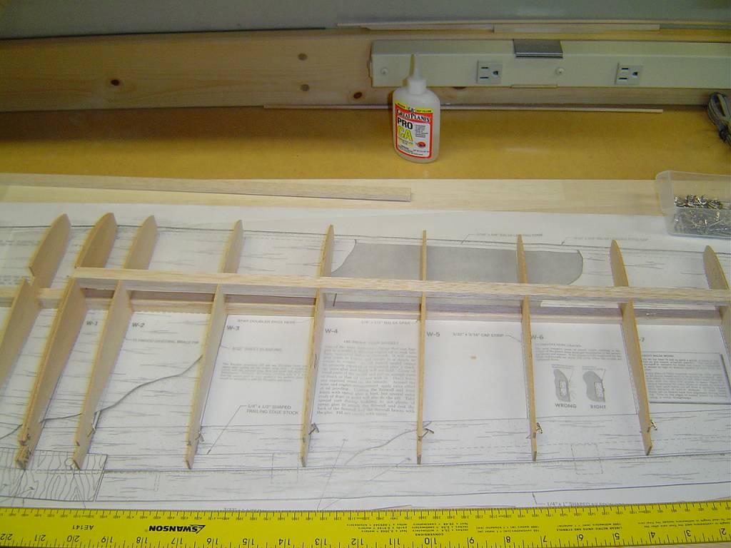

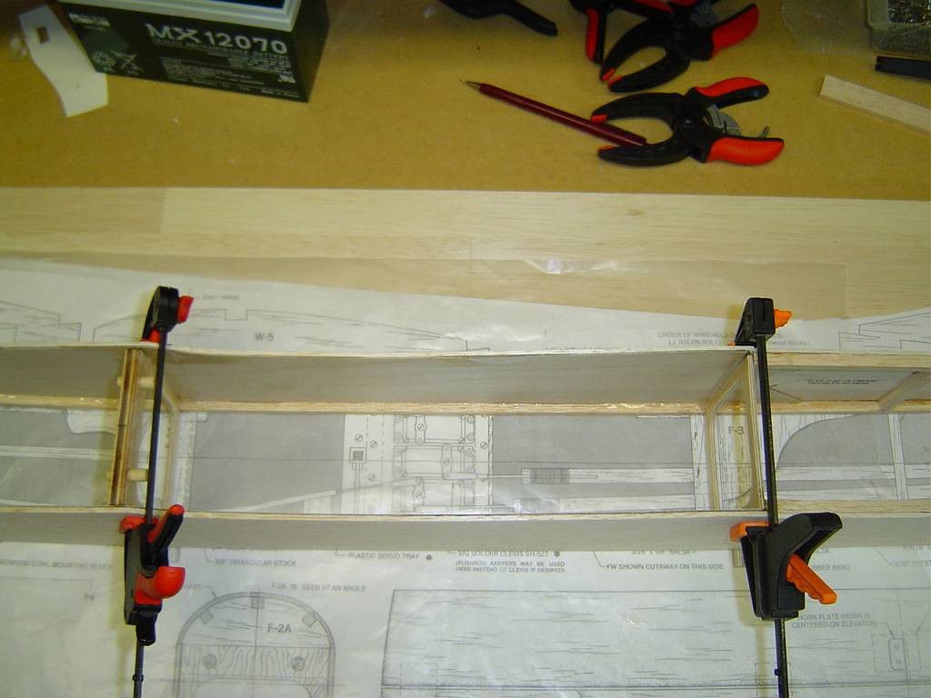

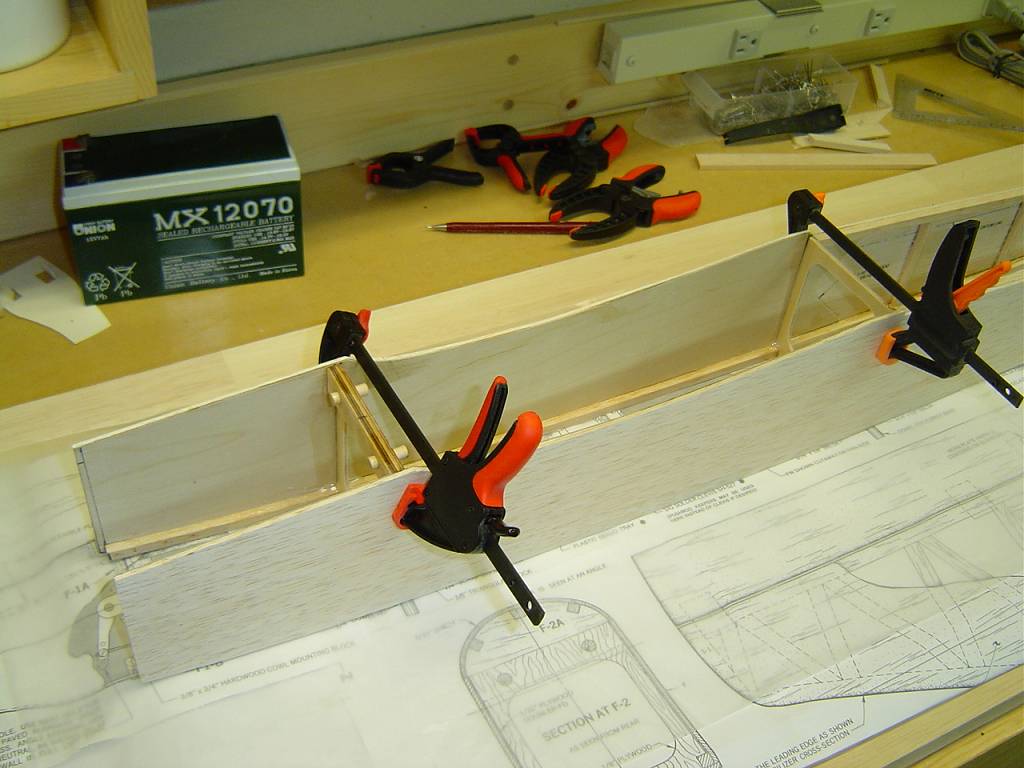

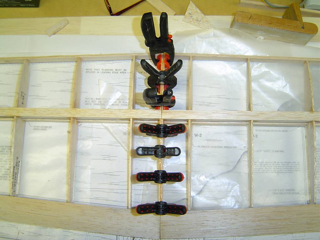

I finally got around to posting some pictures of the build. The wing is now about 50 percent complet and is going together nicely. Hope to get her done by the time the snow flies.

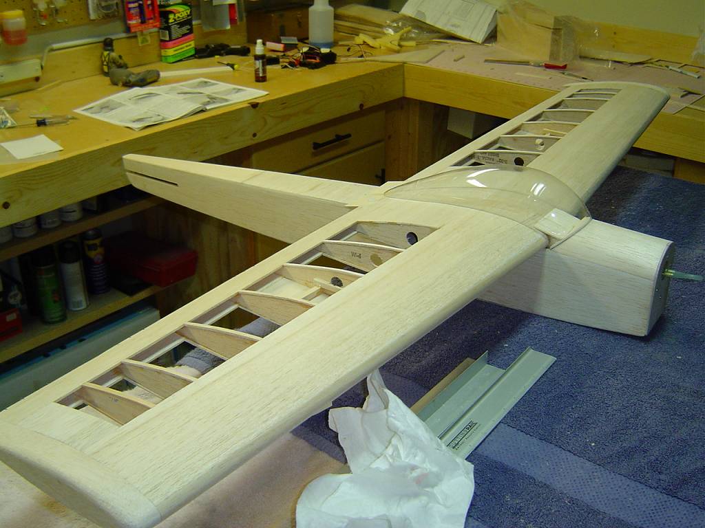

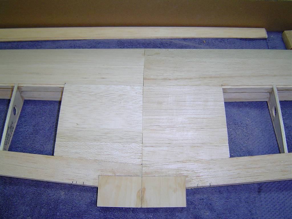

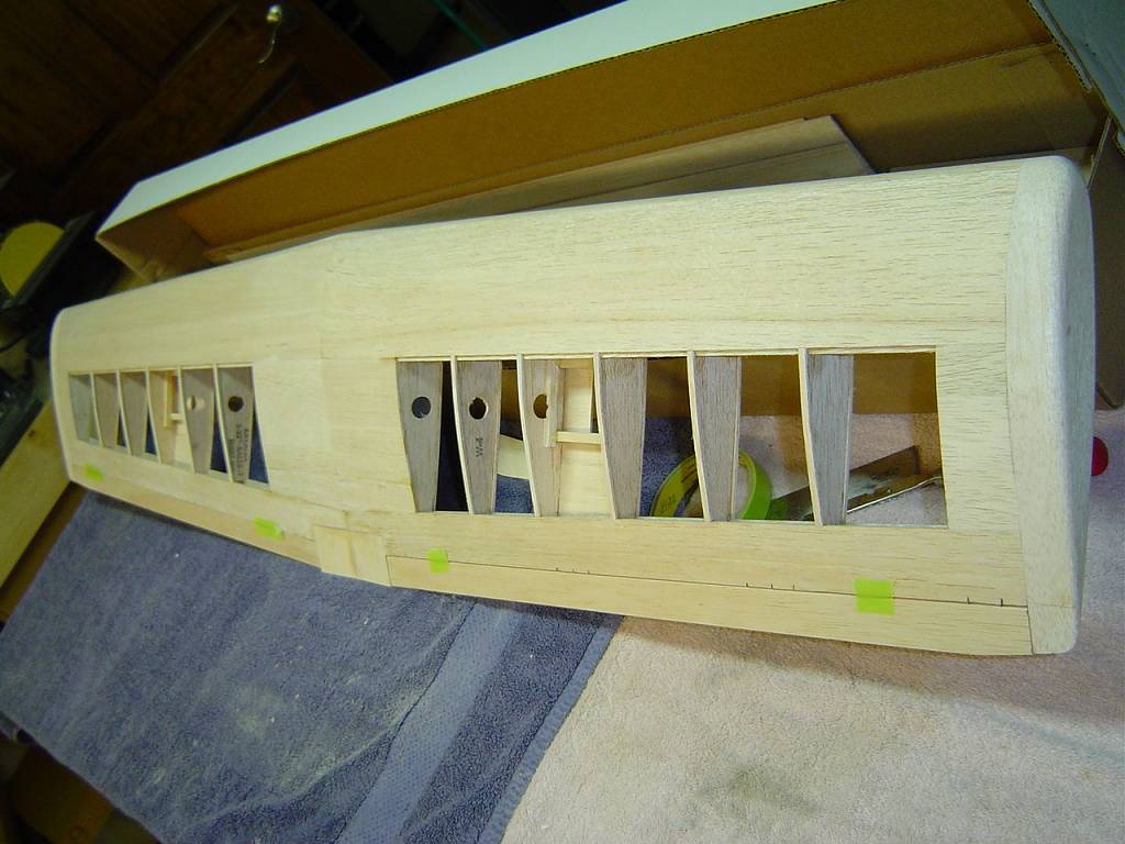

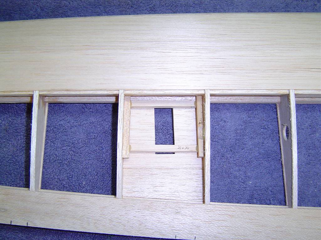

I have made some more progress on the wing. It is now finished for the most part. I did make a few changes detailed in the attached photos. I located the aileron servos in the mid-wing section and plan to mix in some flaperon. Not that this kit really needs flaps, but to help introduce the use of them to my son Collin prior to flying his first warbird. Second, I extended the wing-tips to fair with the trailing edge of the ailerons. This should help reduce turbulation at high speeds and minimize the possibility of flutter.

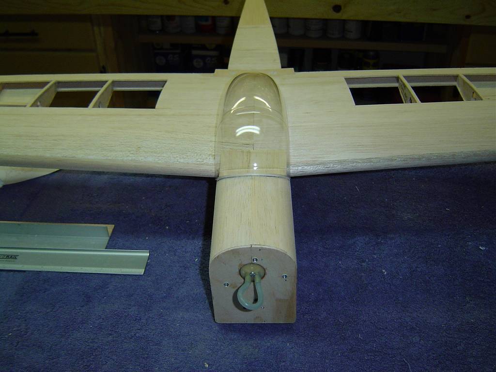

More Progress.

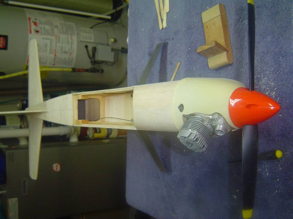

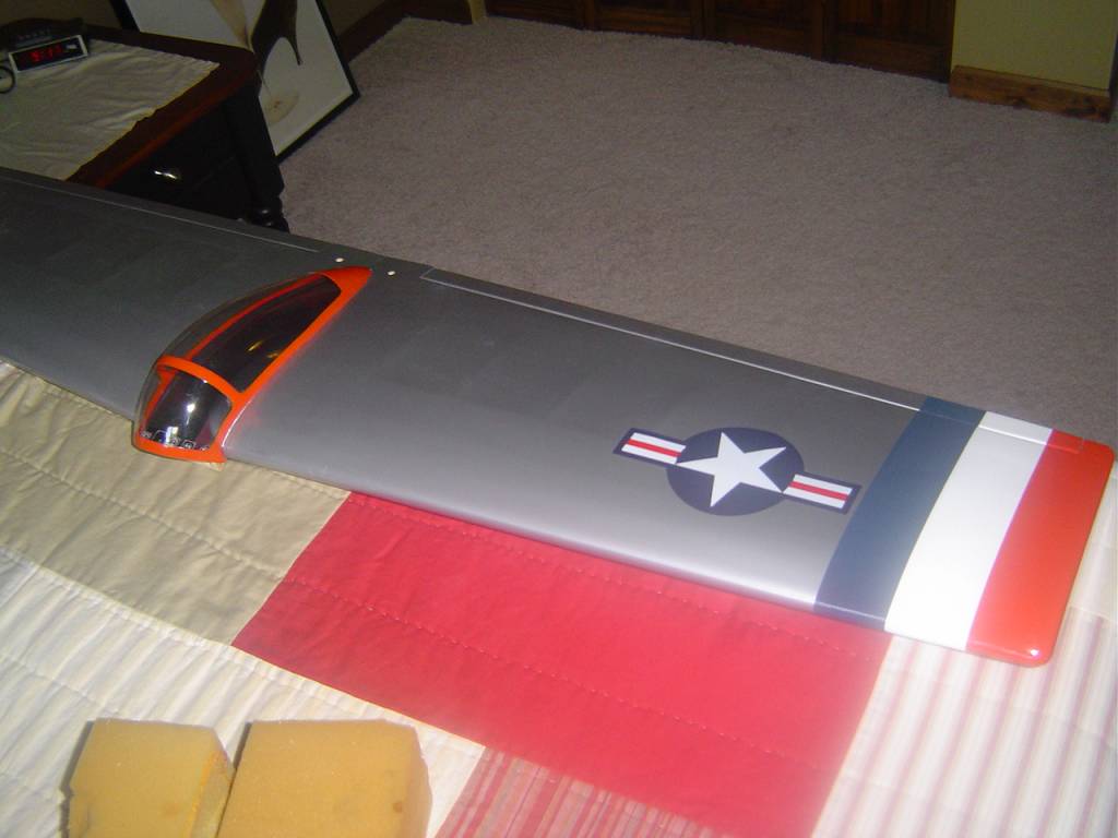

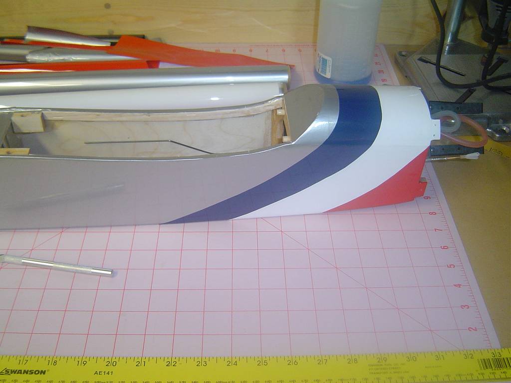

Progress so far: Wing is covered and ailerons installed. Canopy glued up. Fuse is in the final stages of covering. She is starting to look pretty nice. Too bad I didn't meet my goal of having her maidened before the snow flies cuz that already happened yesterday. Will post pix today.

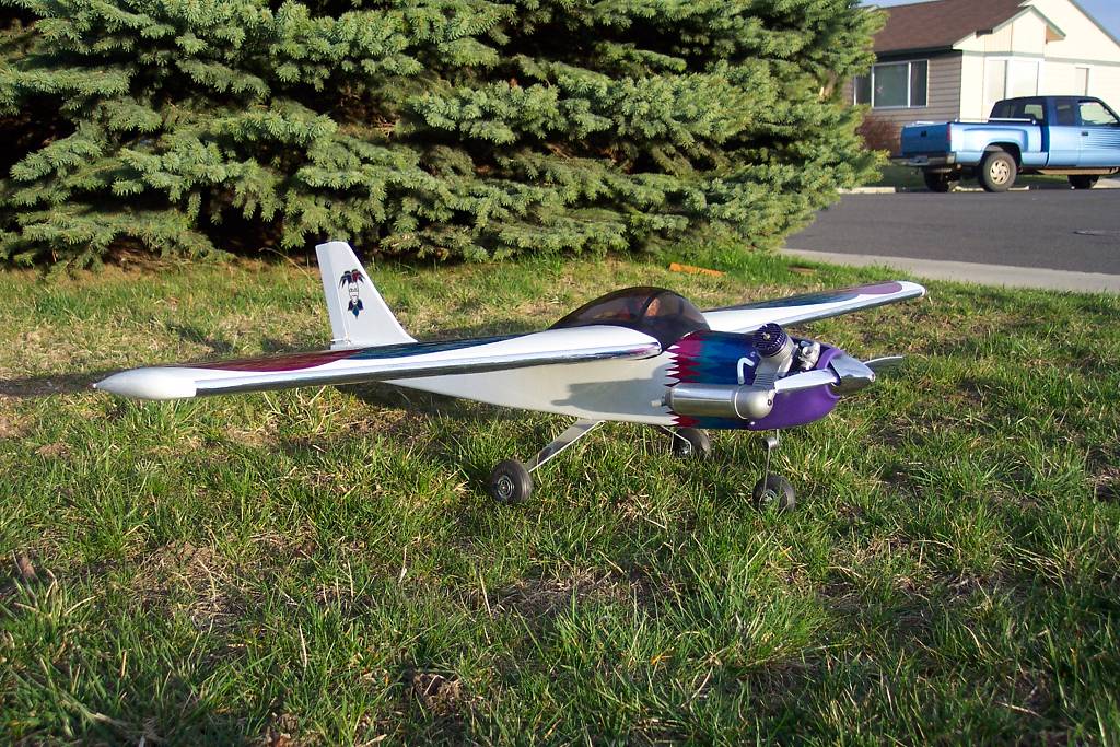

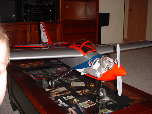

I heard great things about the Kavalier as well. So much so that I went out and built one. I managed to get it up for a short flight to trim it out. The second time going up it climbed out nice and easy with a slight roll. When I was ready to level it out I realized I no longer had control of it and it slowly roled over on its back and took a nose dive into the ground. The fustrating thing about it is to this day I don't know why it crashed. One day I might try and build another one.
Enjoy,
Brett

Oh Brett, that really is a shame. That is perhaps the best covering job I have seen on one. All the Kavs I have built were for the racing class so the covering was very basic, I only did one nice covering job for one fellow, he wanted his to look like the one on the kits box, that was OK looking. I have lost two planes due to radio problems and I never solved the why of it?? One of the great mystery's of life!!

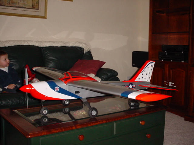

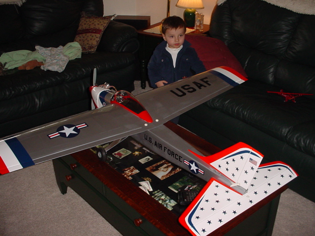

Mission Complete!!!! Well, I finally finished the KAV and she is flight ready. Hopefully we can get her up before Fall ecapes winter. All up weight is righ at 5 pounds. This should bring the wing loding in at around 20 oz per sq ft. It should be a spectular flyer for my son. He is pretty darn proud of it! Enjoy the pix. Sorry about the size, not sure what happenned there.
Chris
