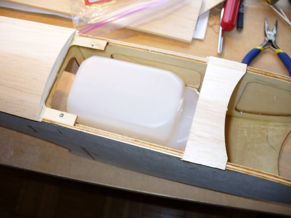

I'm building an older low wing kit where a hatch was not used and access to the tank area was through the opening in the bulkhead located at the wing leading edge. I prefer to install a hatch for complete access. I wanted to put the hatch on the bottom per the pics as the top has a rounded deck with canopy partially attached in what would be the hatch area. I have made a tongue in front and am looking for ideas to secure the rear. I don't mind a single nylon bolt in the rear or any other type arrangement. I'm just looking for ideas and wonder what others may have done.
I plan to have the tank sit on a platform so the hatch area would not be supporting any weight and wouild only need to hold itself in place.

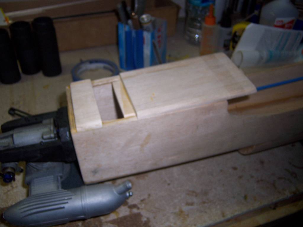

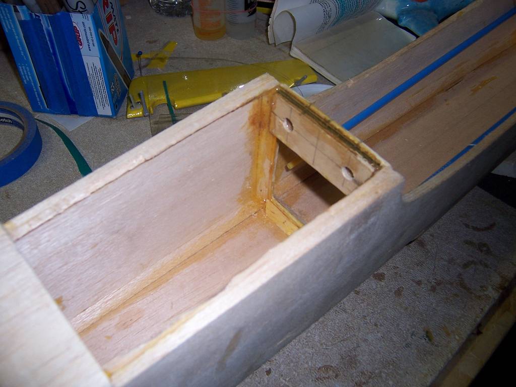

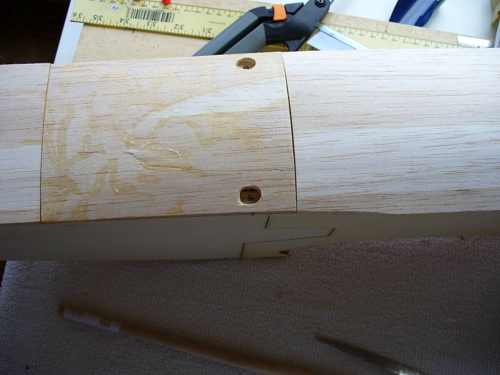

Here is how I did mine on 4*60, its not the best but it works.
Its harder wood dwell with epoxy not to crush the balsa.
I covered it <u>all</u> and then used screws.
its sealed so there is no leaks in but there is not much access either - if I need to access the tank for some reason then cutting through the covering and apply covering again is minor.
