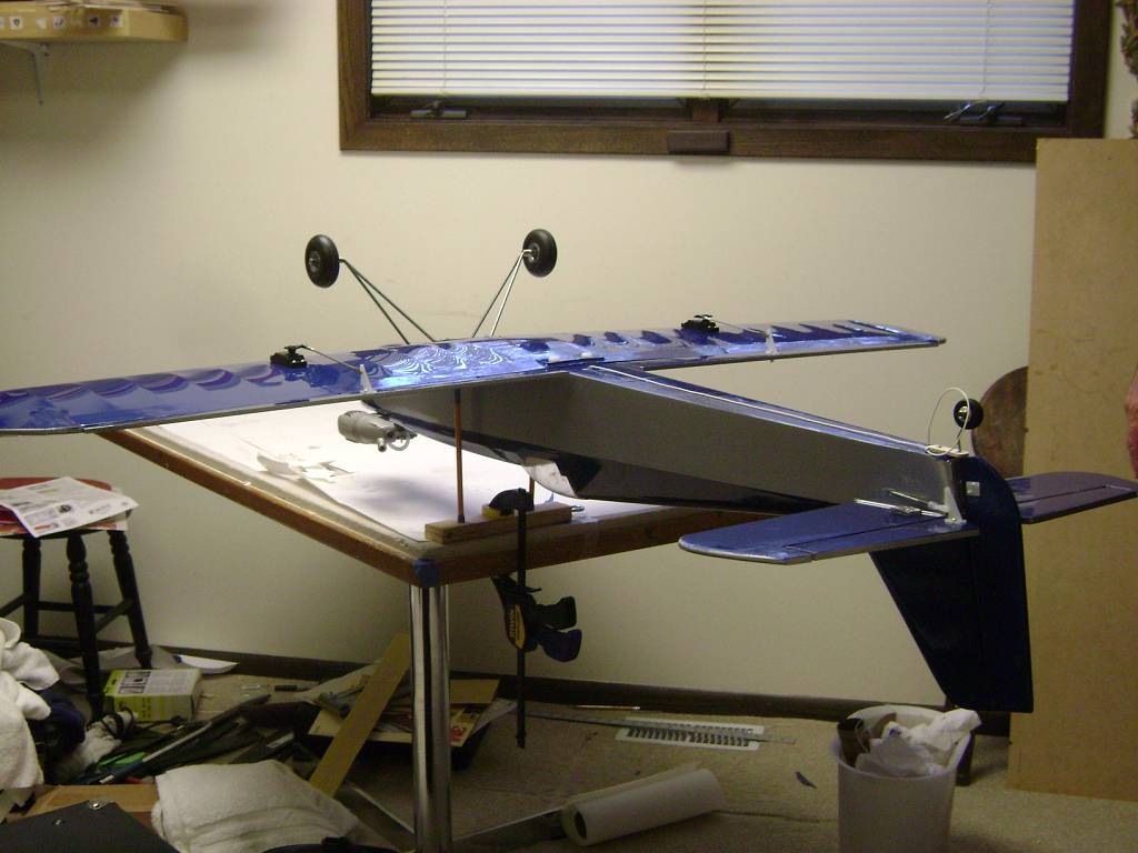

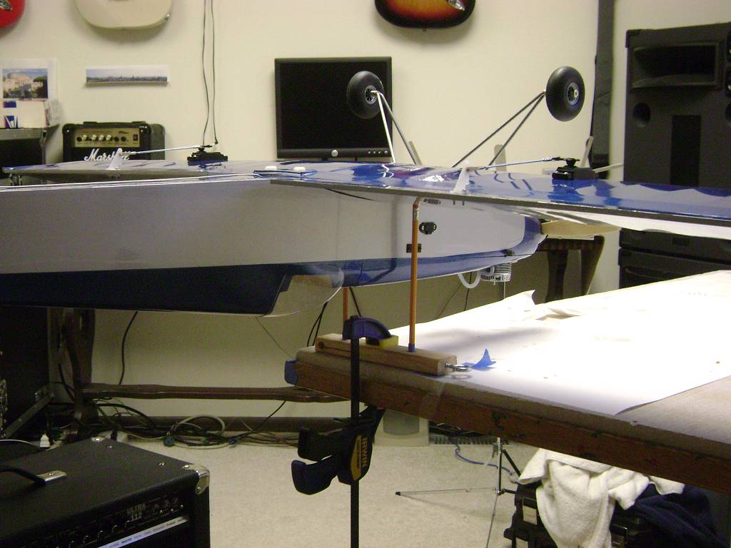

Ok, how's this one.
No Vanessa rig, pencils supporting the plane at the CG as marked on plans, inverted. No leveling devices used, 35g lead on tail (based on the Vanessa rig trial). I thought maybe for the maiden I'd take off 7g to ensure that the plane is nose heavy, how does it look?

It looks as if it is balanced and ready to fly. You might want to make it a shade more nose heavy and test fly it. You can always remove the nose weight if you need to. Good Luck, Dave

Scratchie,
This is indeed the best balanced plane that has ever been maiden!!!![sm=wink_smile.gif]
So,......did the Vanessa and the pencils agree about locating the actual CG, as they should?
Level as it is is just fine; however, I would reduce that throw in the elevator that the picture shows, it seems too much for maiden.
Also, check that the clevises at the elevator's servos don't get overstressed at full deflection, because they could brake due to fatigue.

Scratchie, I can appreciate your apprehension but if its balanced per plans and toward the front of the CG range you shouldnt need any "slightly nose down".
Besides, putting 10 ounces of fuel in the tank will give you all the nose down youll need. And as long as you dont fly her dry youll still have a couple extra ounces of nose weight in the tank.
The nice thing is that you now know that you can trust Vanessa.

Vanessa and pencils were exactly the same, each indicating 35 grams of weight in the tail. Vanessa used a level to ensure the plane was perpendicular to the plumb line. No leveling (except for eyeball) with the pencils. I meant to laterally balance it and completely forgot - thanks. I'll be charging the batteries tonight and flying tomorrow morning unless work/weather gets in the way. I'll post before and after pics - my goal will be the same as with my trainer, get it up and down in flying condtition.

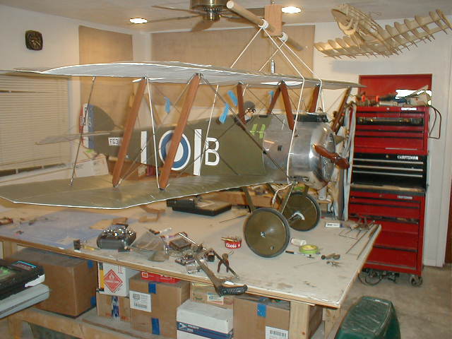

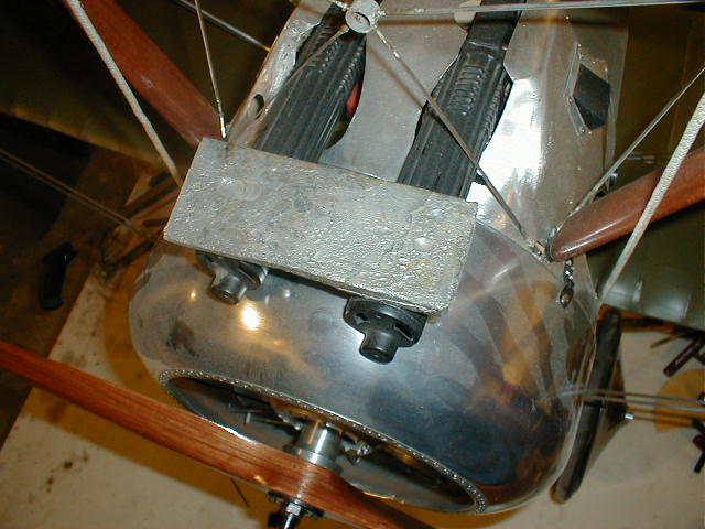

when your planes start getting to this size pencils and the 2 finger method no longer works. 1/3 sopwith camel. have not weighed it yet but near 40 lbs
