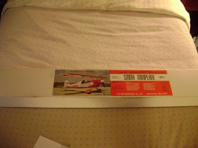

HI All need help. Today I found this this plane Smith MiniPlane by Sig in a LHS in Cumberland Md where I have been working. The owner of the shop sold me this plane for 90.00 tax and all. Very happy Been looking in the forums trying to find a build thread on this plane, not doing very good. Could someone help me please.
Can't wait to get home to start building.......

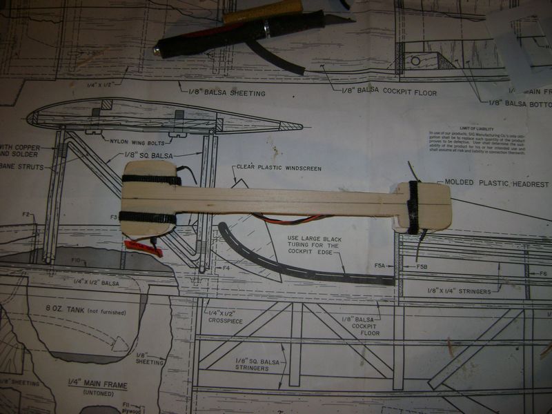

Some where on I seen a tool that helps you with this, would like to find it a gain. Would like to pick up. Thanks Berta for the help. I will check out.....

This is what you want:
http://www3.towerhobbies.com/cgi-bin...LXET66&P=7
You can buy one, or check with the guys in your club to see if someone will loan you theirs

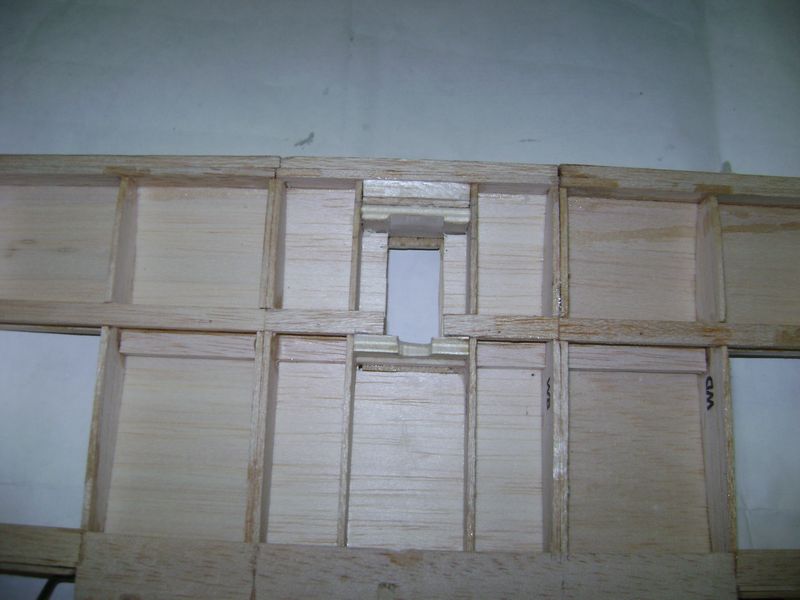

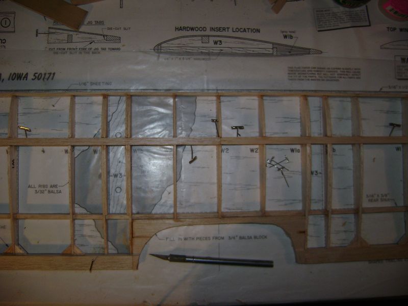

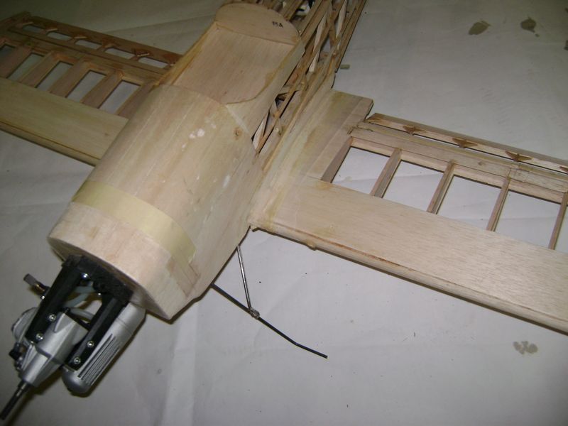

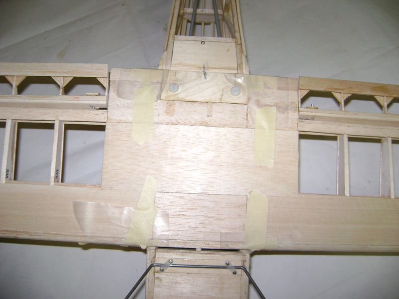

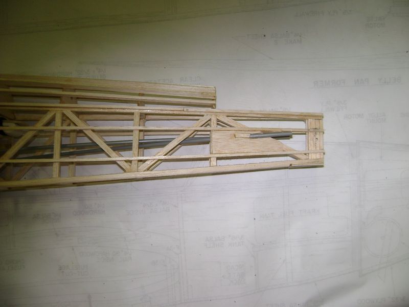

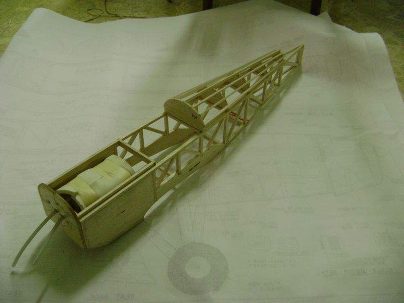

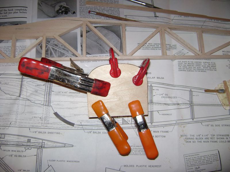

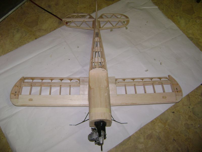

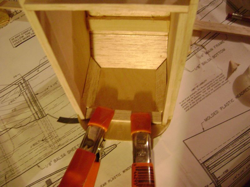

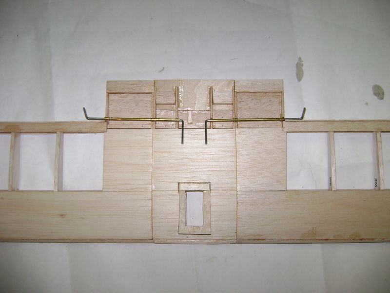

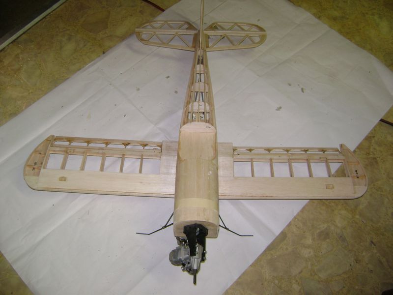

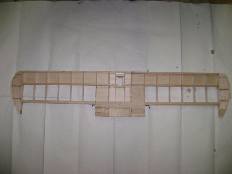

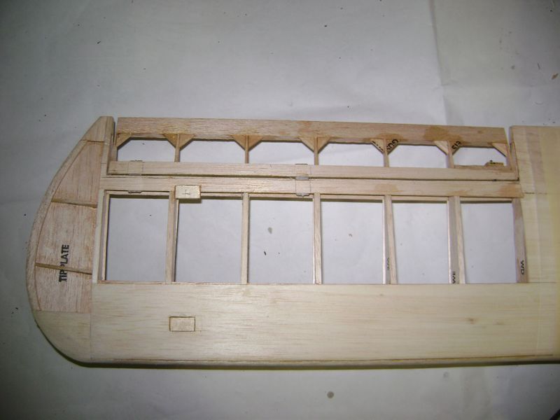

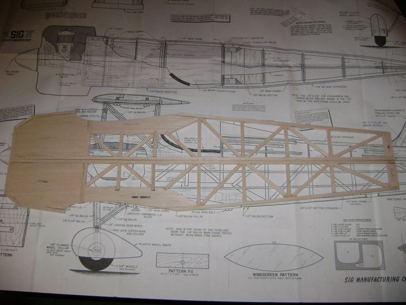

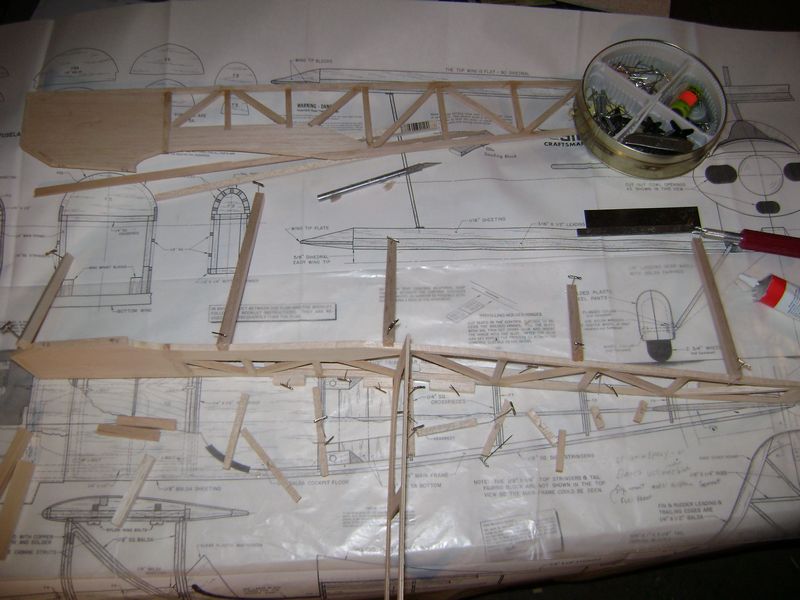

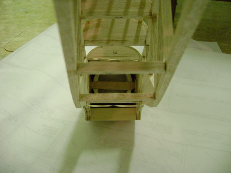

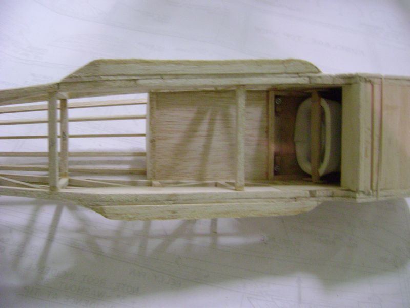

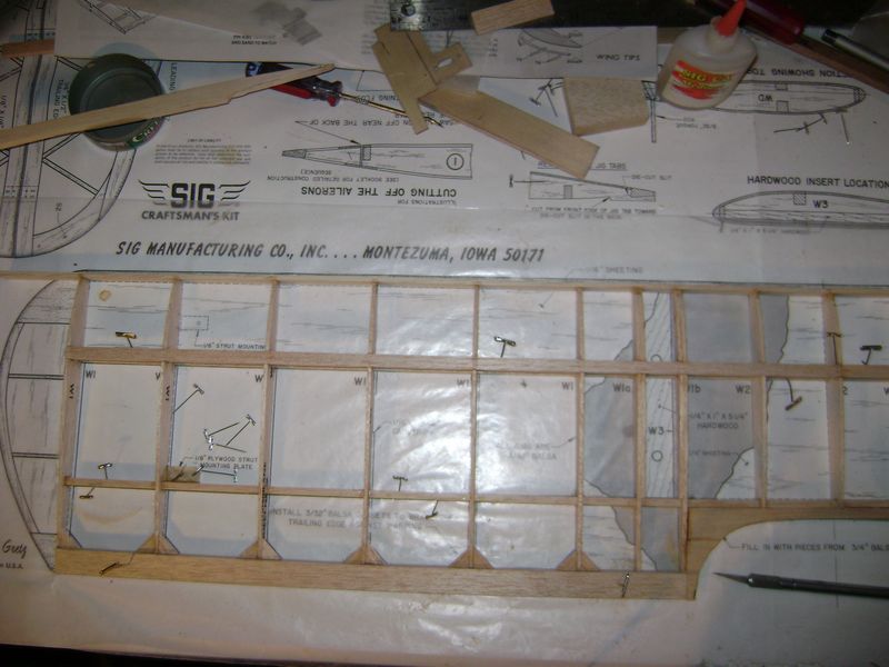

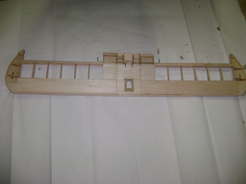

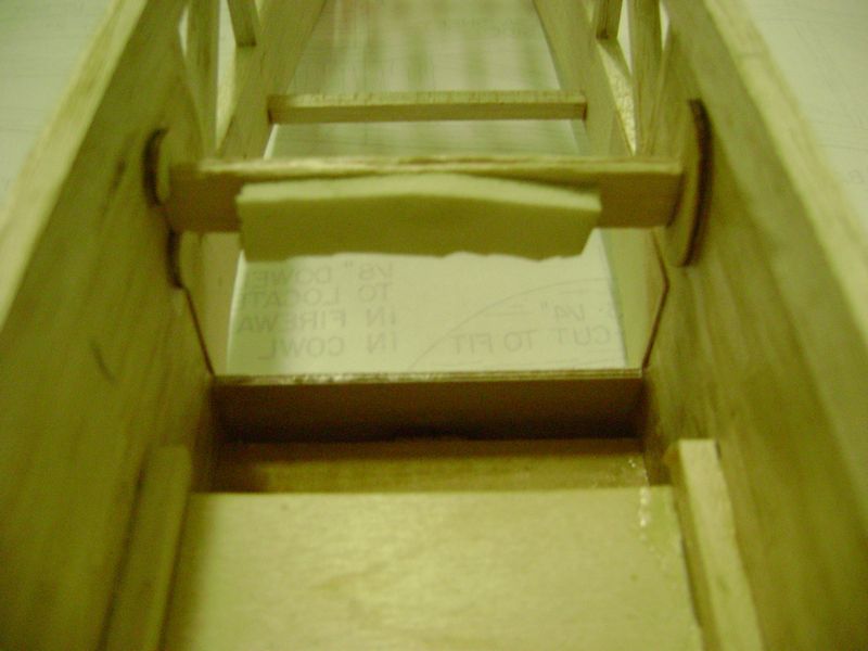

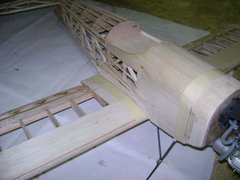

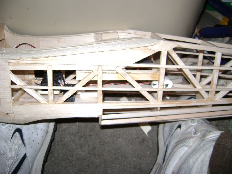

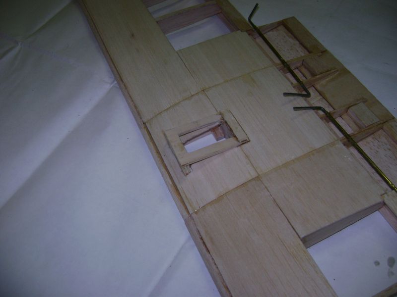

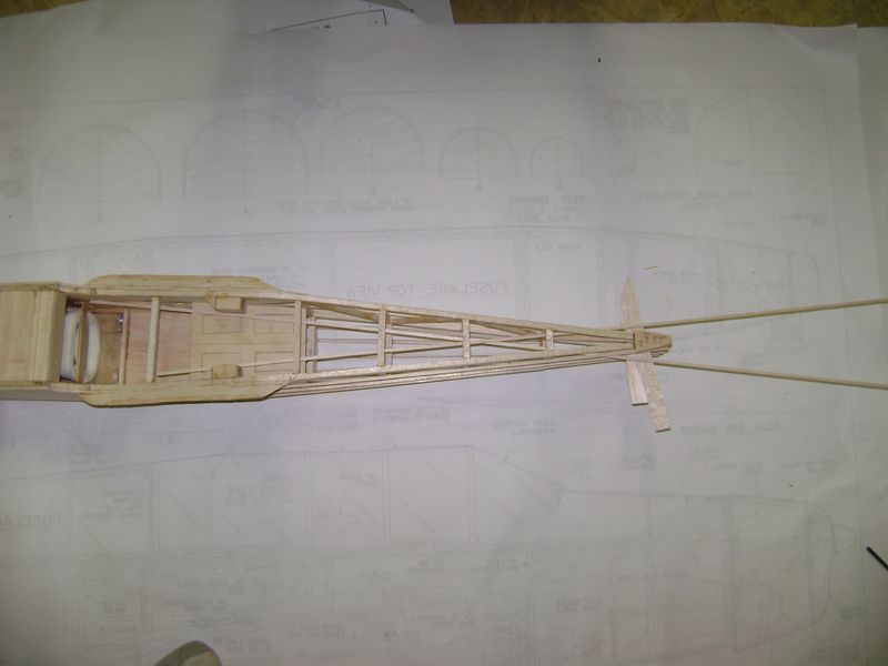

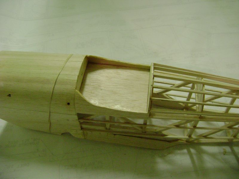

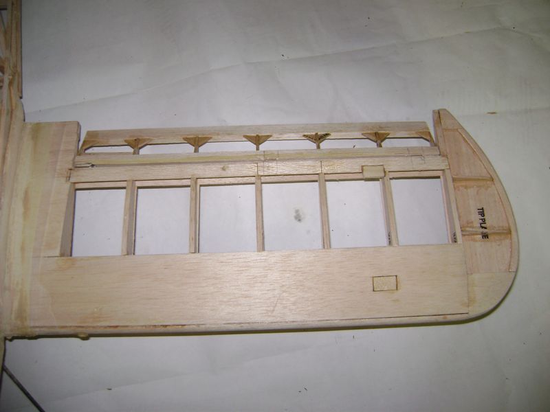

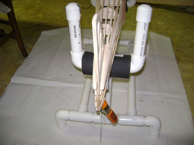

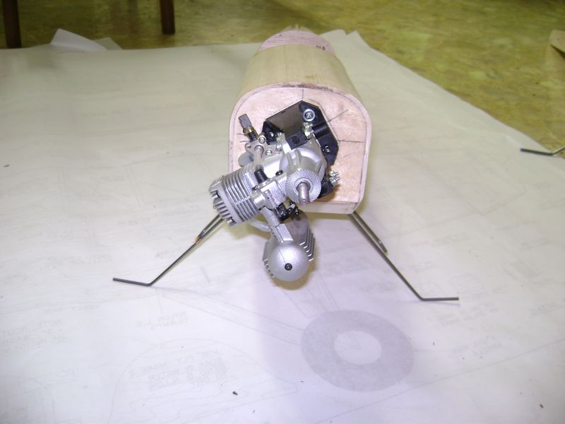

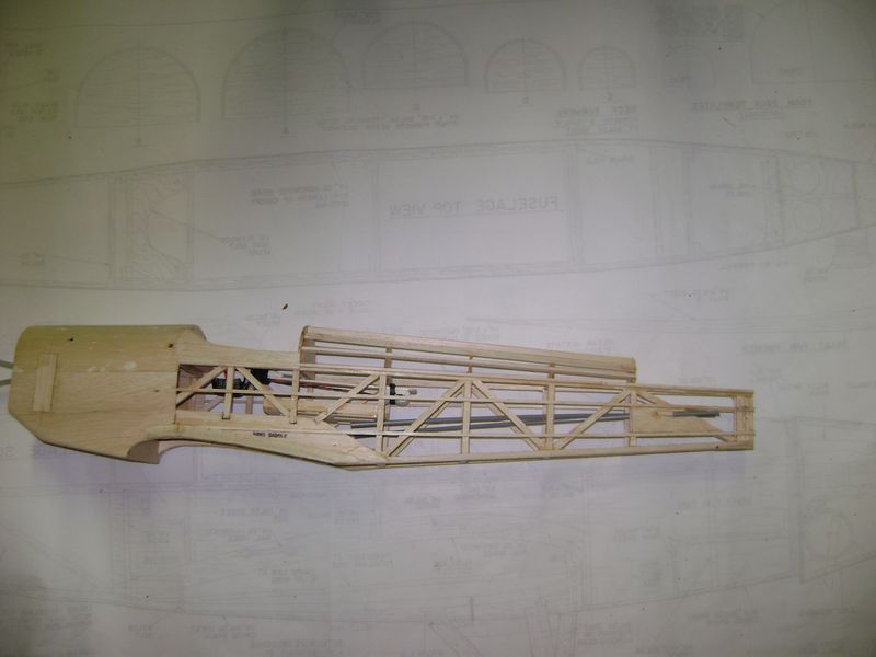

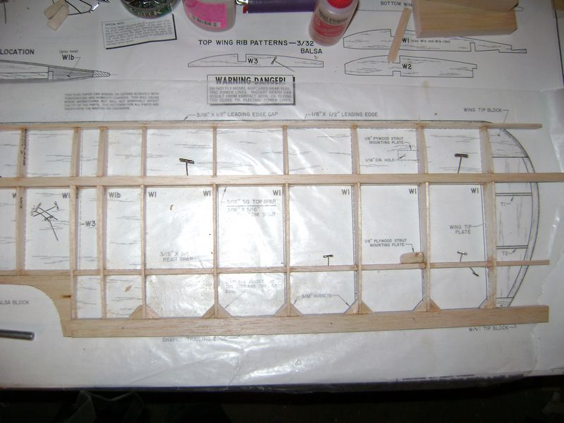

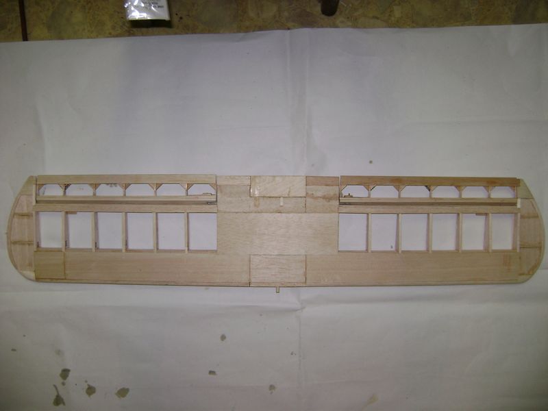

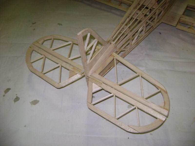

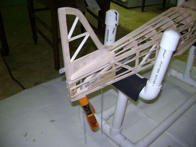

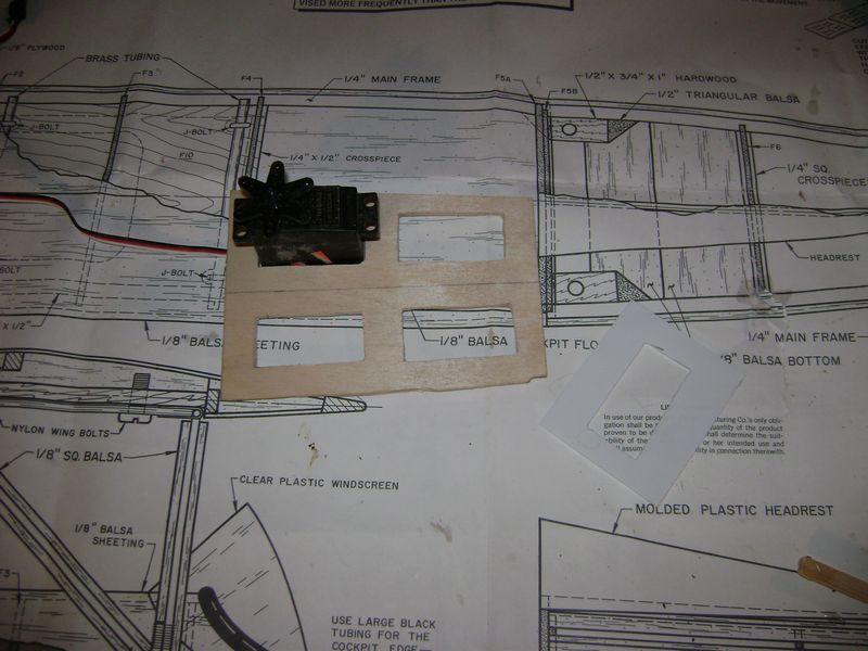

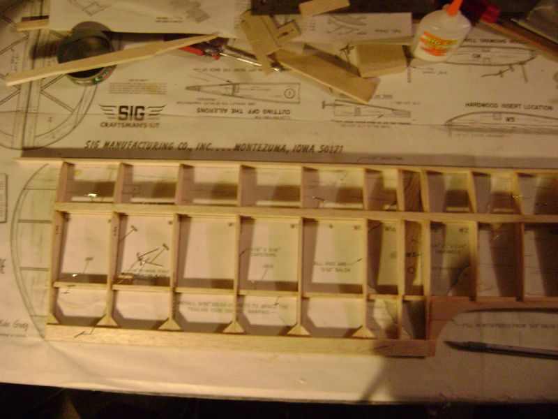

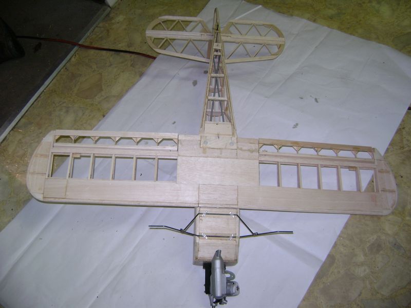

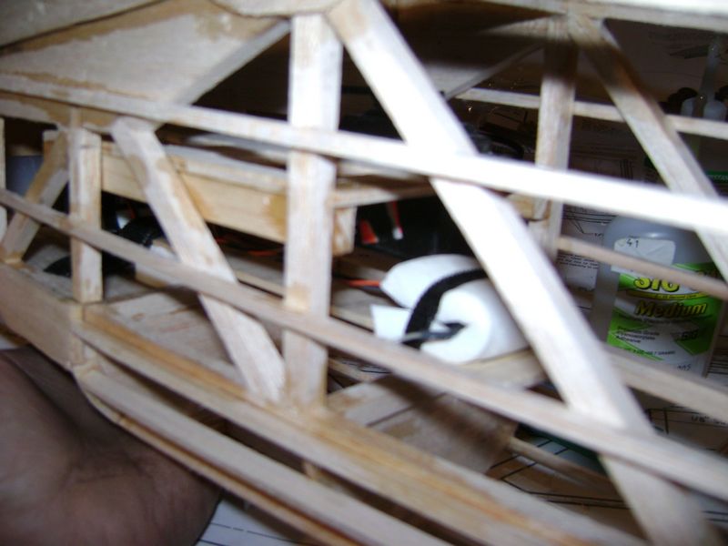

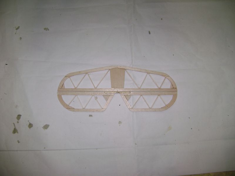

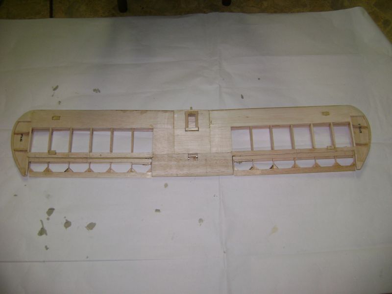

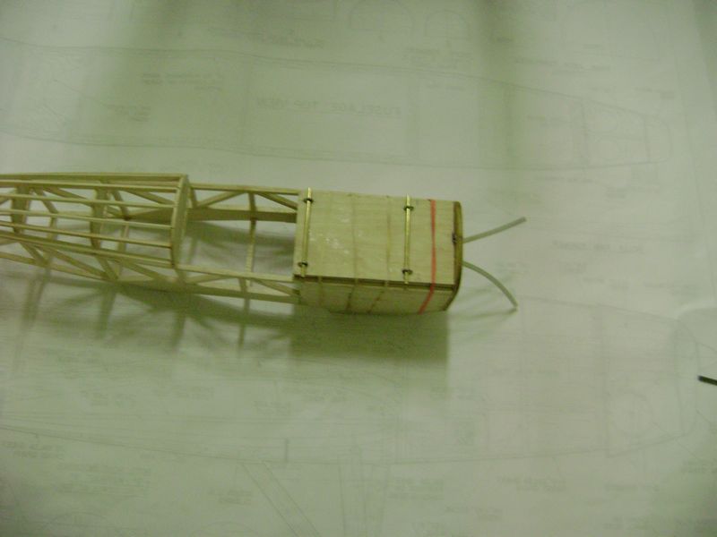

Hi All just wanted to share photos of my build. Feel free to post coments.

Looks great flystright! Looks like it took some time Nice work. One day I hope to build a plane like that.

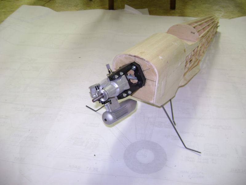

Welcome back to your thread. What engine is that???
Old 10-19-2009 | 07:57 PM
flystright's Avatar
My Feedback: (13)
Joined: Jan 2009
Posts: 307
Received 2 Likes on 1 Post
From: Rush, KY
Default RE: Has anybody built this plane
ORIGINAL: Gray Beard
Thanks. It is a OS 46LA. Do you think it will be ok.

Spend a few more dollars and get a bearing engine. You will be so much happier with the performance. The build looks great.

Looking good . Stick builts look so cool when they arein thebare bones/uncovered stage. Thanks for posting lots of pics.
The 46 LA will fly it but not with much gusto . And they run o.k. upright but the airbleed carb can be a nightmare when mounted on their side or inverted . { my 2 cents } Go with a good bearing engine .45 to 55 or a .70 4stroke would be hard to beat in .40 size bipe.

Hi got to work on my plane friday. Here are some photos of my progress on build.

Hi just wanted to post some photo of my progress.

As suggested pay attention to the wing incidence. You may want to add in a little negative horizontal stab incidence as well. Mine is set at 0 and needed a large amount of down trim to get level flight. Makes it a little touchy, but it's a blast!!
Mine flies spectacular with a Magnum 52 4s. Perfect power, and as far as it being heavy, mine came in at 5lb 4oz, balanced and RTF.
