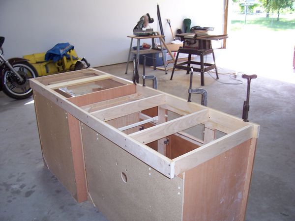

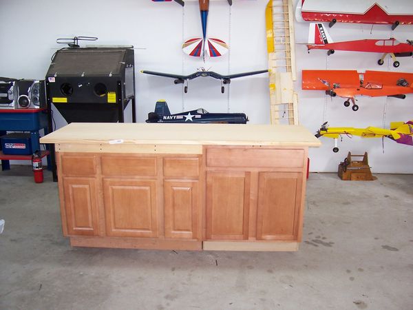

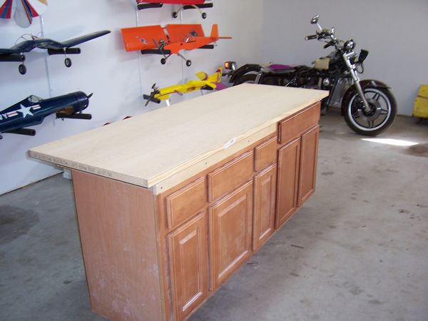

Default RE: Building Surface
Mines cost me a dollar . My wife pick up the cabinets for free and the door cost me a dollar at Home Depot.
