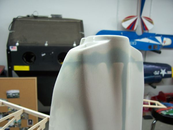

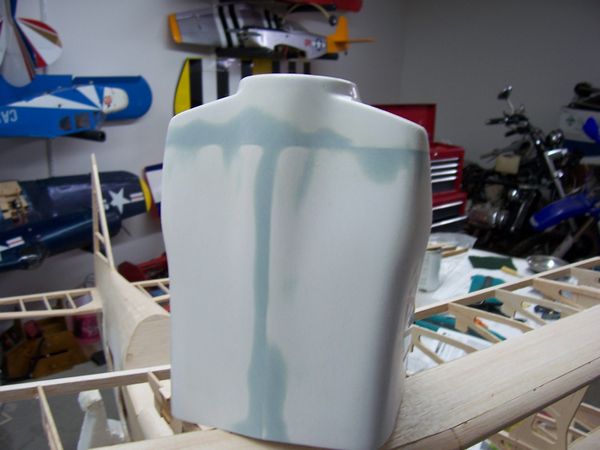

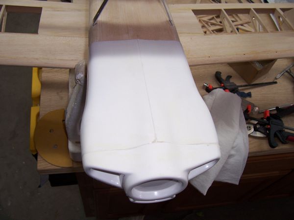

I CA the sections together and use lite weight body filler to cover the seams.
