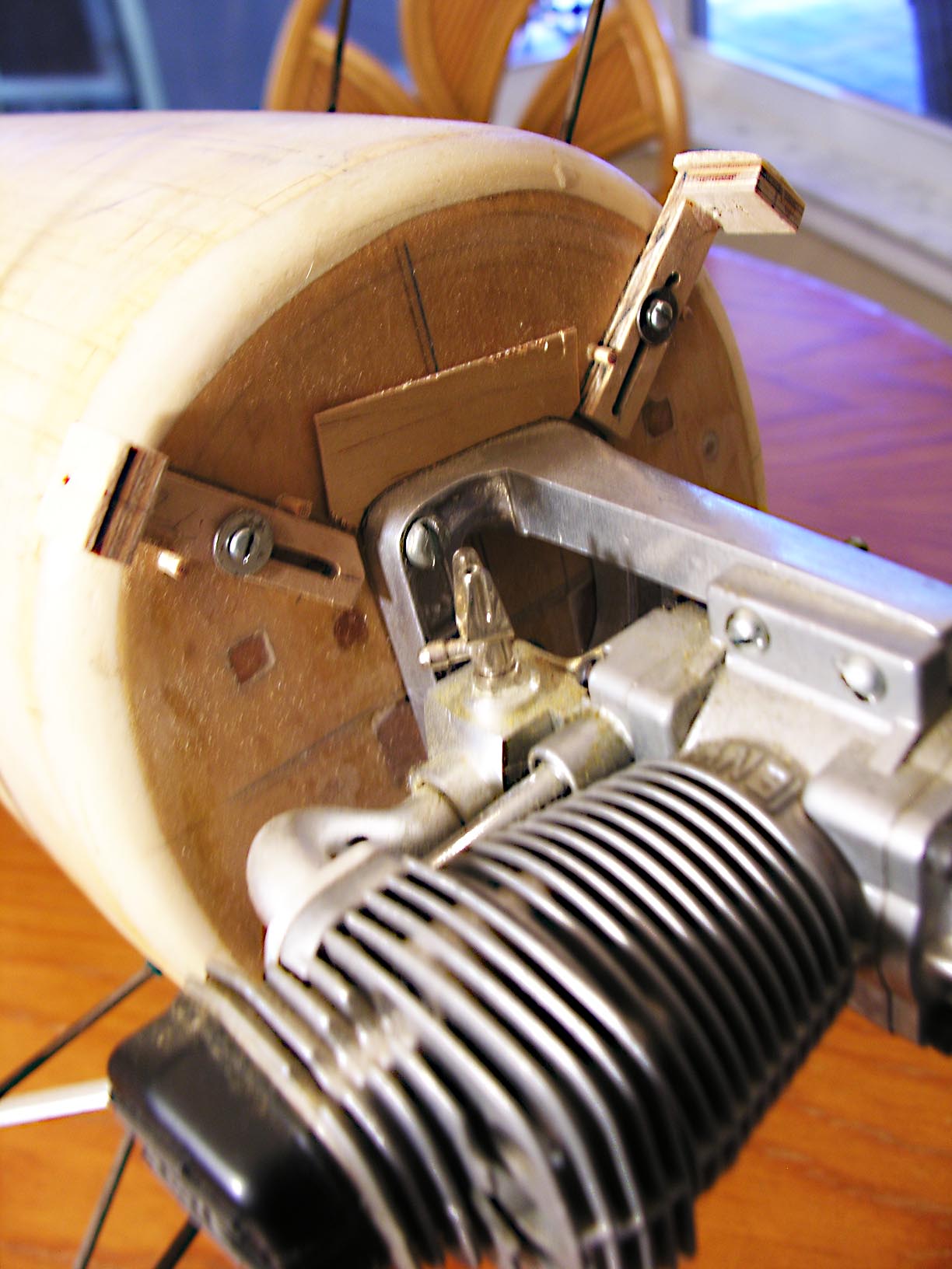

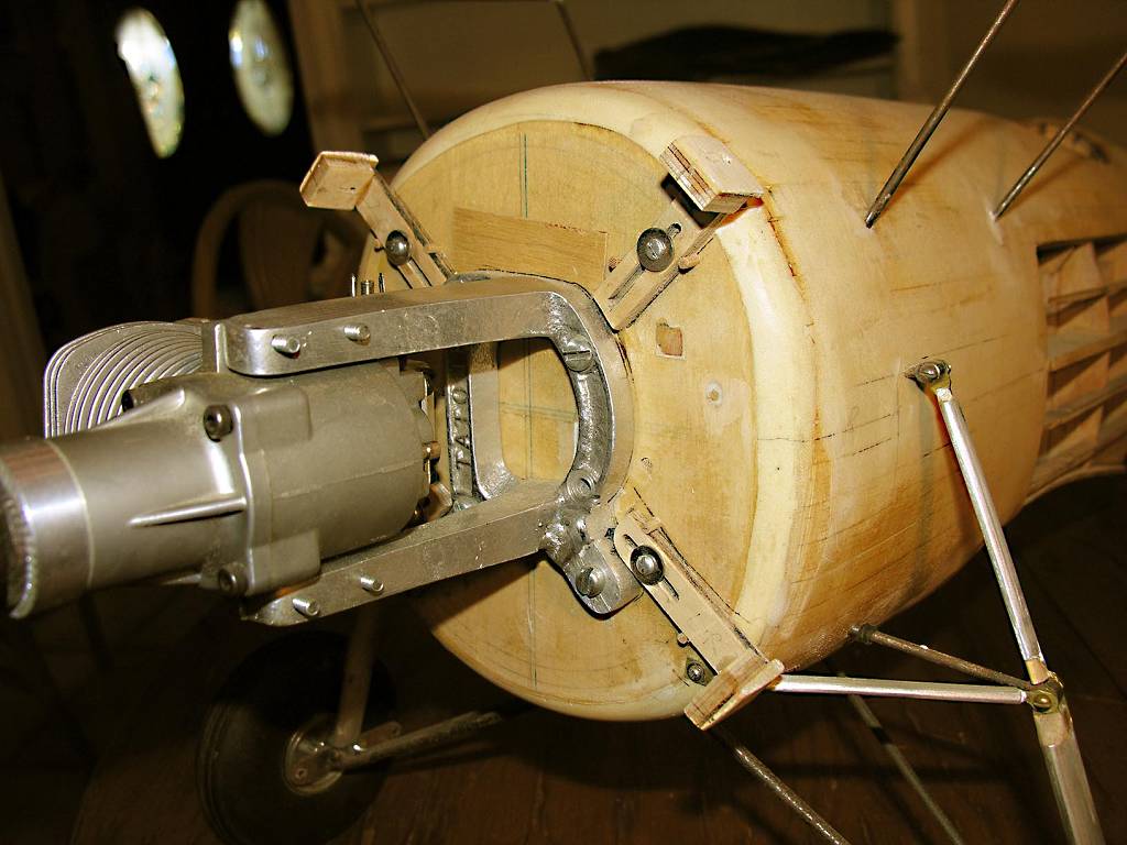

I have the Sterling one framed. The mods I did to it are free! Still a Sterman but a different airplane.

Another thing I just noticed. An aluminum motor mount. The last time I did that, the first crash I had (and yes, if you fly you will crash, it is just a matter of time) the motor mount was stronger than the engine, and the crash tore the mounting bosses off of the engine, along with part of the engine case. Needless to say, no more aluminum motor mounts for me.
