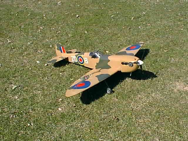

I have built this kit and flown it as well. I am in no way an expert at this, as this was my first kit to build. I built is as per the plans, only changes I did was add additional sheeting the the wings, and fill in the wing tips with ribs and sheating to make them more round instead of flat. I have an MDS .48 powering this plane. It does build light as one on the earlier posts mentioned. I covered mine with sky blue mirror finish Monokote on bottom and dull finish desert camo on top. My first flight was quite....exciting! I only wanted to do some taxing down the runway, when she jumped into the air! I guess its time to fly! A little bit of trim adjustments and it flew great! A couple problems I have run across. One the plastic cowling has cracked all to h__l! I have replaced that with a Stan's Fibertech fiberglass cowl for 28.00. looks real nice. Second the Hobico retracts spun around on me on one of the landings, loose adjusting nut I didnt see. I have a WM Mustang that just wont snap roll at low speads, this Spitfire will! Been there done that. On my 3rd landing of the first day, I was coming in with about a 8 mile and hour headwind, I was a little long on my landing so I went back around. On my next final, I had forgot I had set back my idle trim
. As I came in over the runway, I was about 15 feet up, looking pretty, nice glide path....than WHAM! She spun around the prop and dropped straight down into the ground! Man I was a little shocked and a whole lot of pissed. I go over and pick her up, and she only had a scuff mark on the right wing tip! I looked around and could see the airplane gods smiling down on me
Anyways at that point I realized at least I used enough glue!
Other than that day, I have about 30 other flights on it, and she flies wonderful. Sorry about the novel here, but if you all have any other questions feal free to drop me a line. I am now building a TF Focke Wolf 190 D9, cant wait to see her fly!
