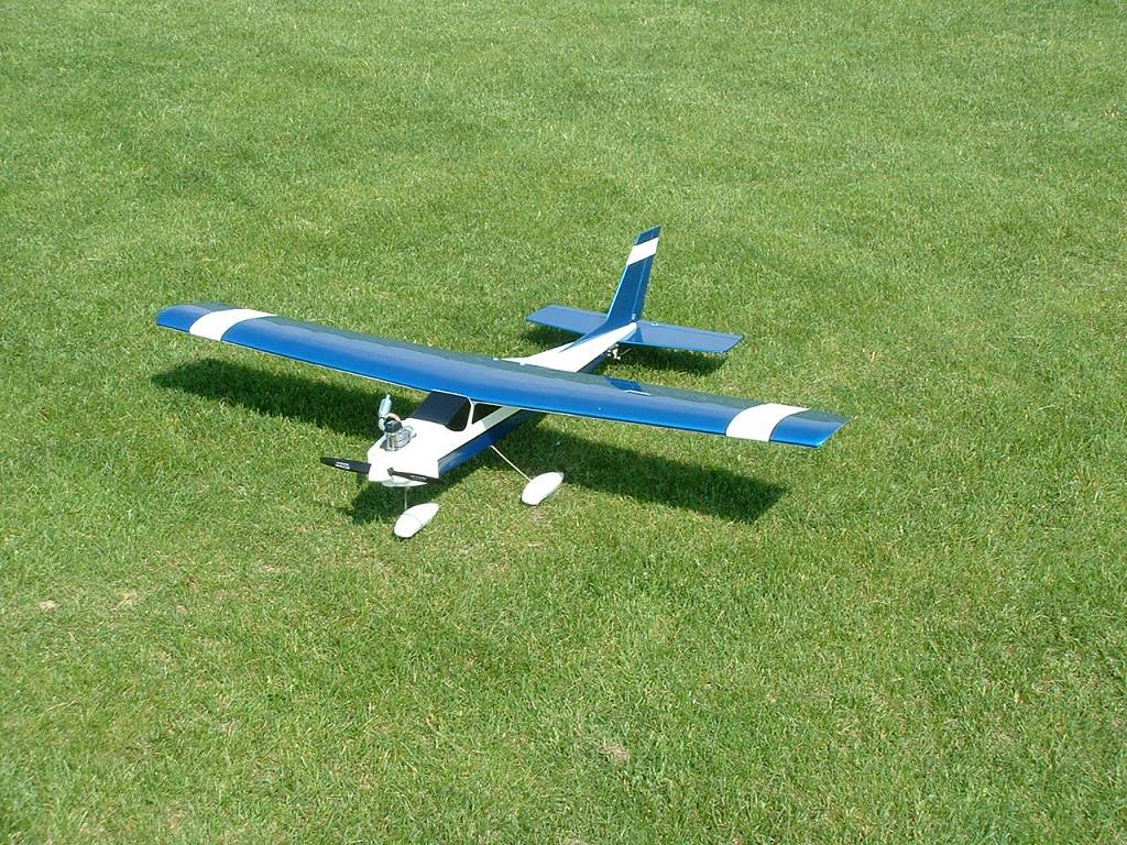

Old 12-02-2009 | 10:53 AM
Joined: Apr 2007
Posts: 1,111
From: Lancaster, WI
Default RE: Four Star 30?
Gary-I too "had to have" the OS 30 with no plane. A friend of mine suggested the goldberg "Freedom 20", so i built it, and it is the perfect plane for the engine. Even though it's a high wing, it is quite a performer. Perfect Lawn chair plane, landings are fun coming down on two wheels. Power is plenty with great vertical perfomance. Just an idea-good luck.
