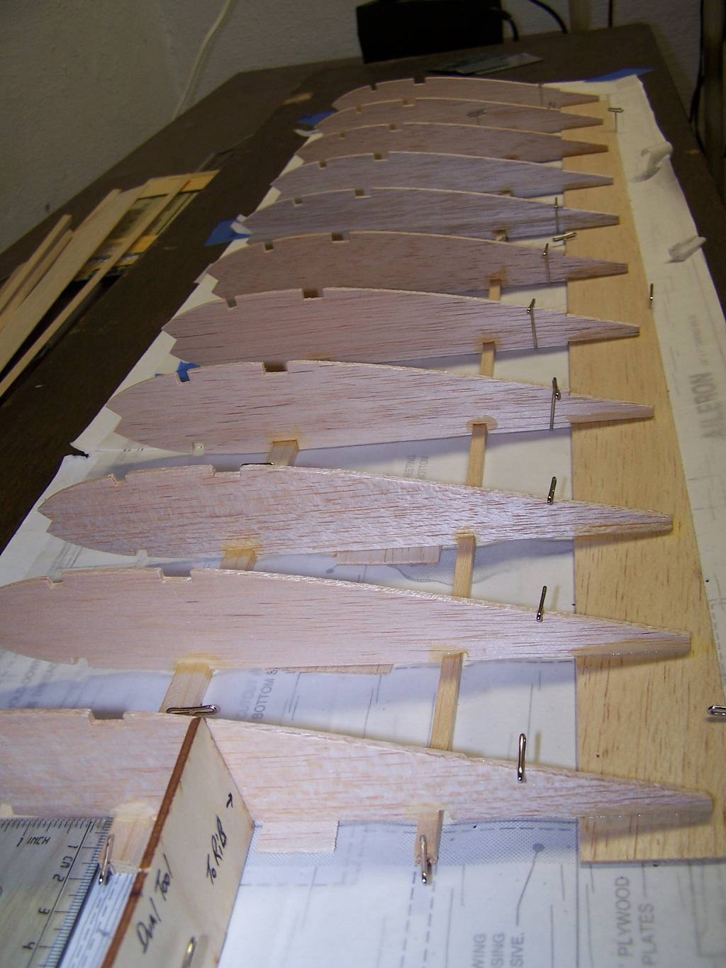

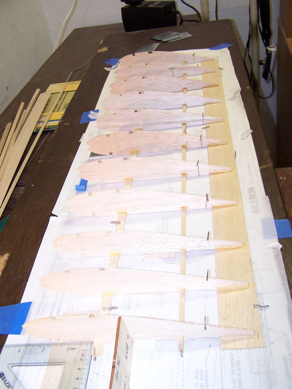

Hello guys,
Finally glued all of the ribs...
I'm thinking of building it 100% stock but that's subject to change...
So far I'm having a great time building my first kit, however I'm hoping to speed up the whole process

Old 11-30-2009 | 09:25 PM
  #32
mclina's Avatar
Joined: Dec 2006
Posts: 1,809
From: Westford, MA
Default RE: first kit Sig Mid Star 40- Build Thread
ORIGINAL: mxaexm
Hello guys,
Trust me, you don't. These things build so fast that when you are done, you'll wish you were still building. I have to force myself to slow down and enjoy my builds, because they are always done too soon. That's one of the reasons I quit using CA. That, and the burning sensation in my lungs.
Take your time and enjoy the process.

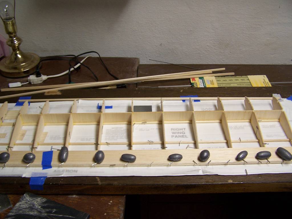

Pictures of my progress....still having fun.

Old 12-17-2009 | 09:54 PM

I was doing the leading edge sheeting and something didn't seem right, the sheeting would overlap the leading edge sq. balsa stick. Looks like I used 1/4" sq for the leading edge and 5/16" for the trailing edge. I know that there is not much of a difference but I decided to start from "Scratch." After work I'm planning on going to the hobby shop to pick up some balsa stick and sheets and will cut the ribs for the right wing and will build it one more time.....lesson learnt.
Old 12-18-2009 | 02:17 PM
  #40
Alex7403's Avatar
Joined: Jun 2004
Posts: 1,594
From: New york, NY
There were three ribs for each wing that are smaller than the other ribs, these smaller ribs should be at the wing center for sheeting.
see if that is the case and you will not be surprised with six smaller ribs for the other wing.
another issue to check is if all the rib opening for the LE are even and on the same line.
if you used the right type of ribs - 3 small at the center and still have them too big maybe to sand them off a little bit where they meet the LE and sand of the sheeting too.
another idea is to add an angled piece of balsa from the inside so when sanding you will not create a hole.
