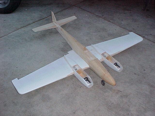

I glassed my Pica Duellist and used 2 oz for the wing center section and .50 oz for wing and fuse. It was my first time finishing with glass. It was more work than I anticipated but once finished will look great.

I used finishing resin (epoxy) it's real thin and goes on great.
Here's a web site with some great info on how it's done. This helped me. I didn't go as far as the "bondo" material he used in Step 19, my finish seemed to turn out OK without having to go that far.
http://www.arts-hobby.com/fiberglassing.htm

hey thanks for your help what plane is that in the pic it looks great thanks

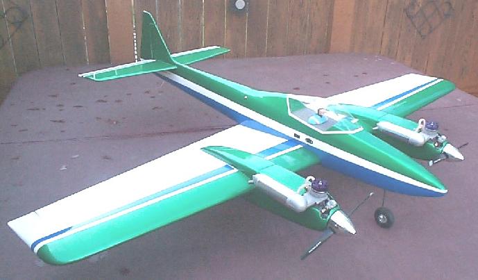

Tim:
The Duellist looks good, you're getting there.
Post your flight reports and pictures over in "Twins," please.
I'll look forward to seeing it.
Bill.
PS: This is one of the prettiest Duellists I've seen, built by Jim Greenwood. wr.
