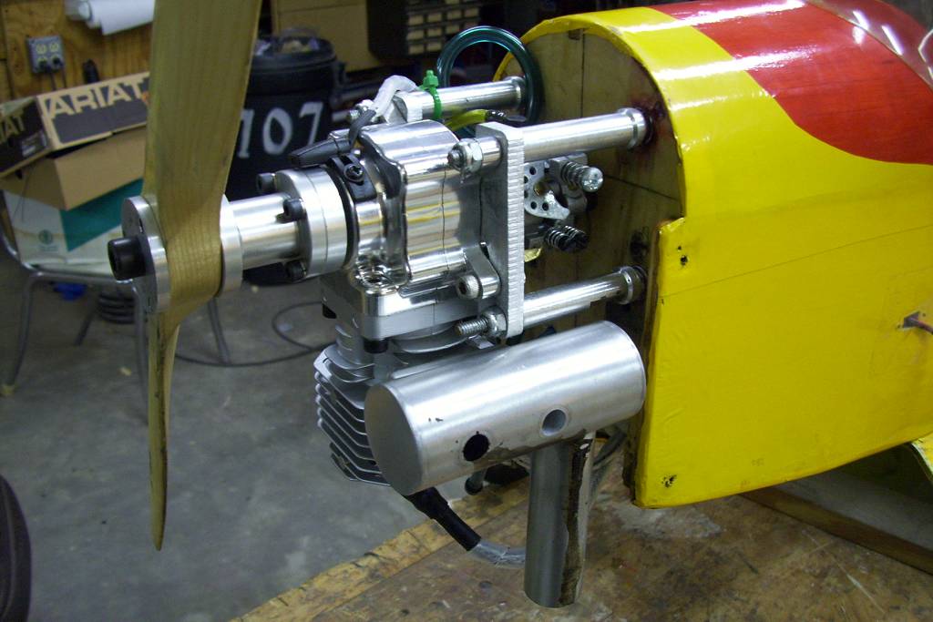

I modified my mount some because the carb needles didnt have easy access. Basically extended the lower standoff about 1/2". Good little engine.
Edwin

Looks like a nice engine close up. Thanks for the pic edwin.
Pat
