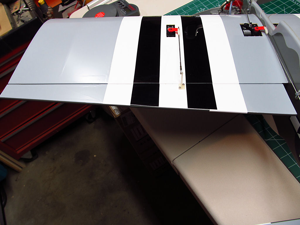

The ailerons covered, installed and control rods made...

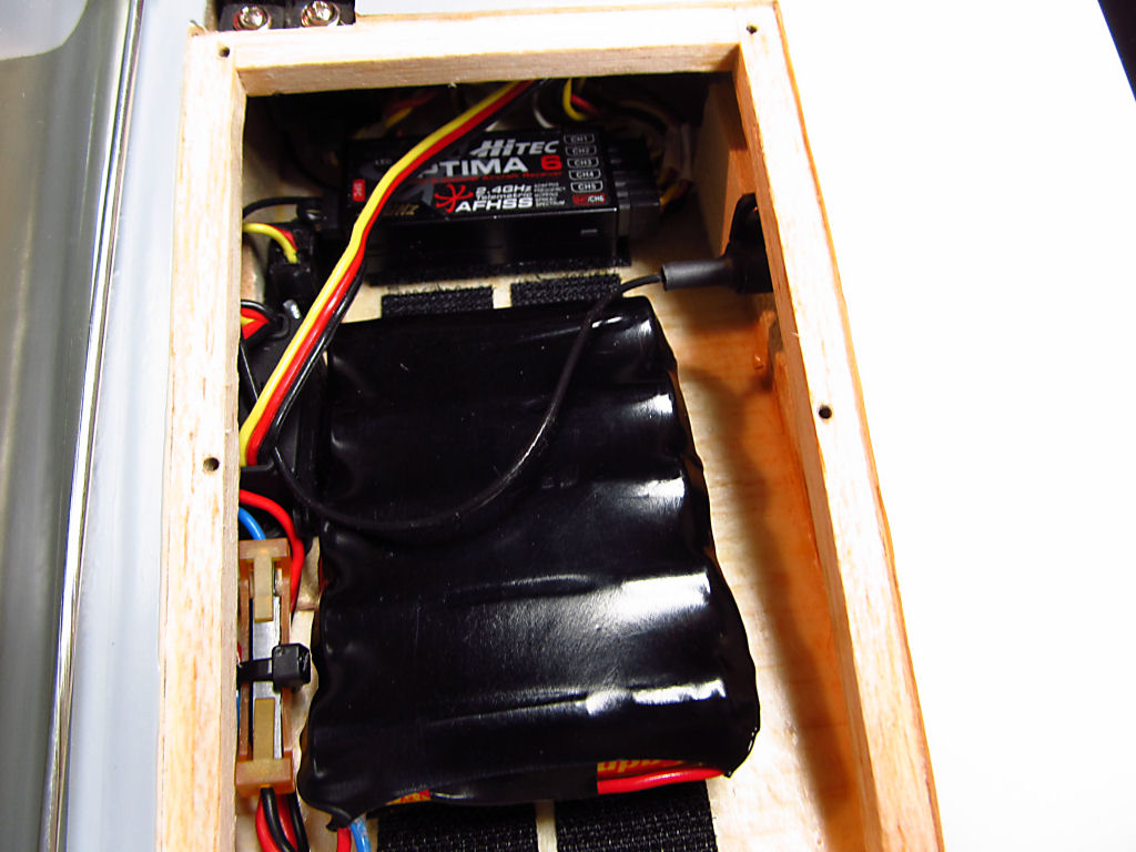

I fiberglassed the bottom of the hatch (top of wing inside hatch area) to make it stronger for attaching the Rx and battery (pic 1). Pic 2 shows the Rx antenna attached to a piece of scrap balsa that I hot glued to one of the ribs. I wanted to get it a reasonable ways from the battery so it has less chance of getting shadowed.

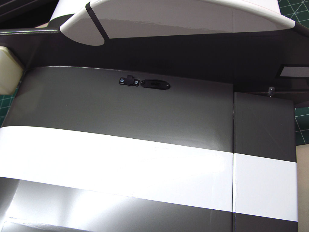

Also mounted the charge jack and switch so they are easily accessible from the top of the airplane (pic 3). I glued a piece of 1/32" plywood to the inside to double the balsa where these were installed.

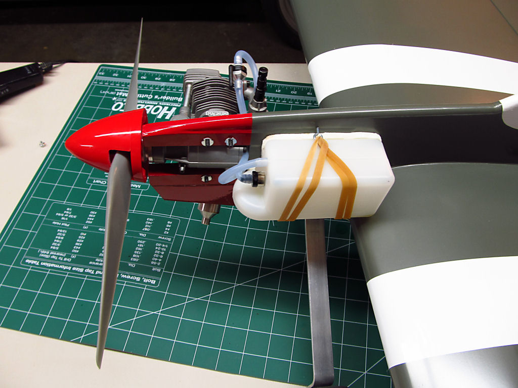

Engine was installed as far back as possible (pic 1), using cut-down pieces of a 2 degree thrust plate under the mounting flanges to get the right thrust correct (pic 2).

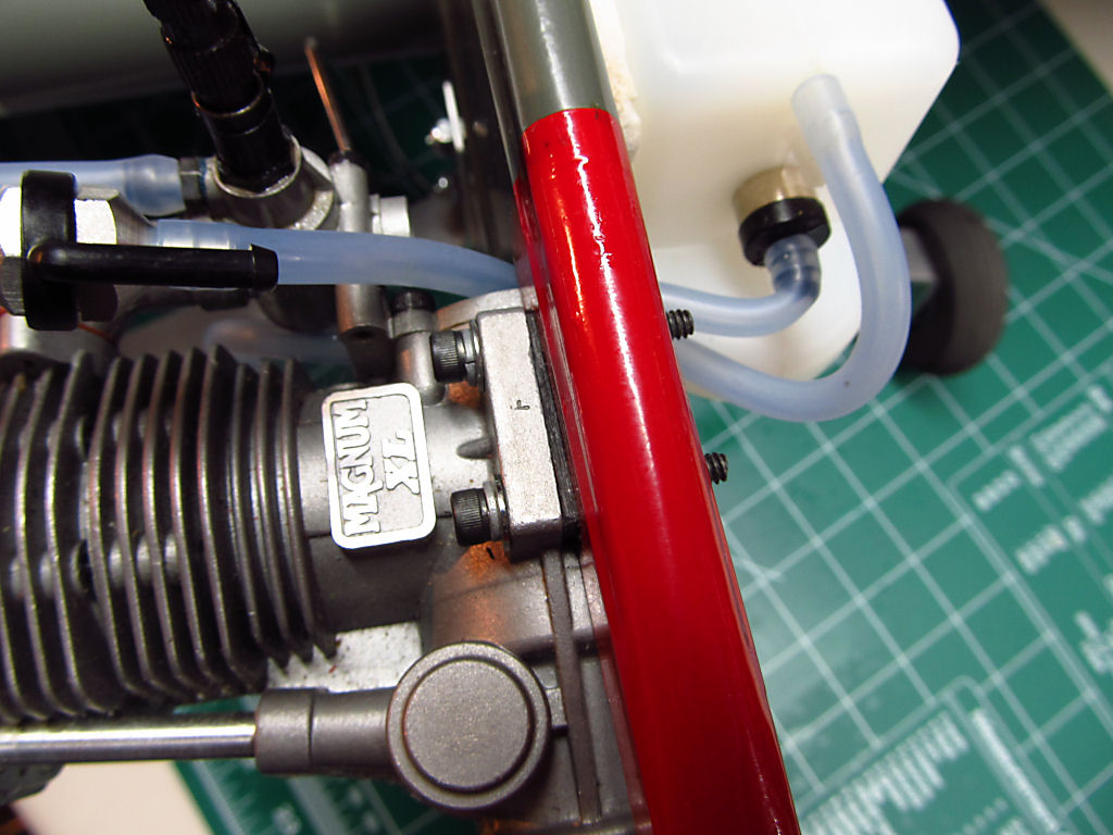

Also installed the fuel tank on the port side (pic 3). I had no choice here since the throttle linkage (see next post) was in the way behind the engine. As it turned out, though, the plane balanced perfectly laterally with the tank around 5/8 to 3/4 full in that position. You can also see in this pic that I chose to use blind nuts for the engine installation - we'll see how that works out.

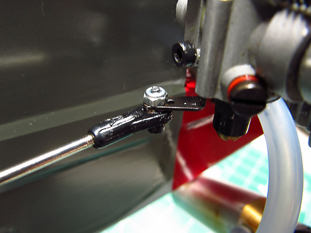

Throttle linkage was made from a used helicopter tail control rod, using my favorite method (so far) of a heli ball link at the carb and EZ connector at the servo (pics 1 -3).

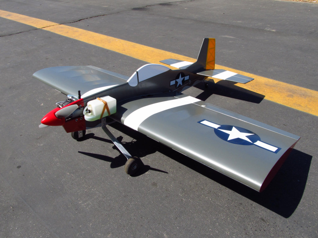

Thanks for the kind words Tom! I maidened the Fun 51 today, and it went well. The elevator was more sensitive than I thought it would be, so took it easy. I'll have to add a little more expo for the next flights. I got a video, but the camera batteries died after a few minutes Roll rate is very fast (the rolls in the video were only about 1/2 throw), it knife-edges with hardly any coupling , and it slows down really well for landing (though it was a bit windy, so the ground speed was really low), and it set down like a feather. Plenty of power with the 52 4-stroke, even though I was running it pretty rich.
Looks like this is going to be a fun plane when I get used to it/dialed-in. I'll try to get a video of a full flight soon...
