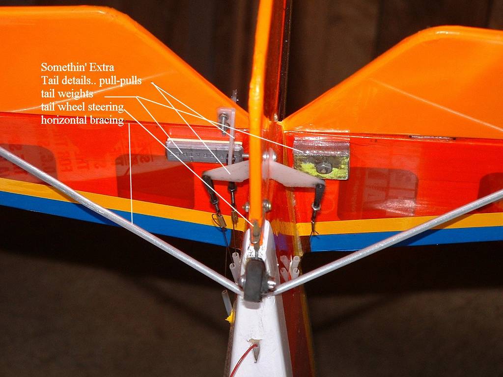

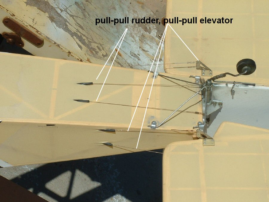

Here's five ways I've used...

In tall paul's 3rd pic that looks like a dubro set up. If it is I have used two of them they work great. It comes with the wheel, bracket, springs, rudder control horn, wires, and all the connecting pieces. I have one on a 4star 120 and one on a great planes Extra 300s 60 size. I also have a pull pull on my 1/5 scale sig cub. I used the supplied parts for it, and it works great. I put it on my cub first and was worried but I prefer that now over the other. I deffinately do not like a tail wheel with out any control. I have seen them several times, and tried to taxi someone elses. They suck!

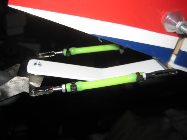

For tailwheel setup here mine ,,,,, See pics......I use Fuel Tubing instead of springs ,It gives better Control...
For Info on A " Pull-Pull Setup " check out Don And Judy's Book on Giant Scale Setup { It also works well on very Small planes )..[sm=thumbs_up.gif] .

Very interesting hardware and fuel tube use... never seen that before; thanks for the pictures. Great to see!!
