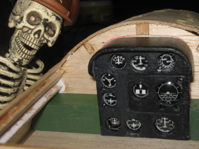

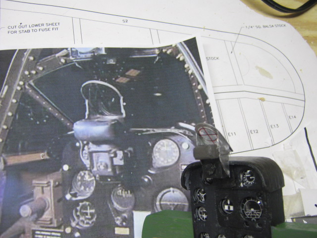

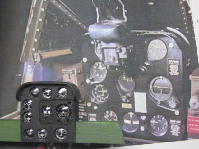

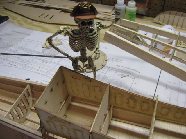

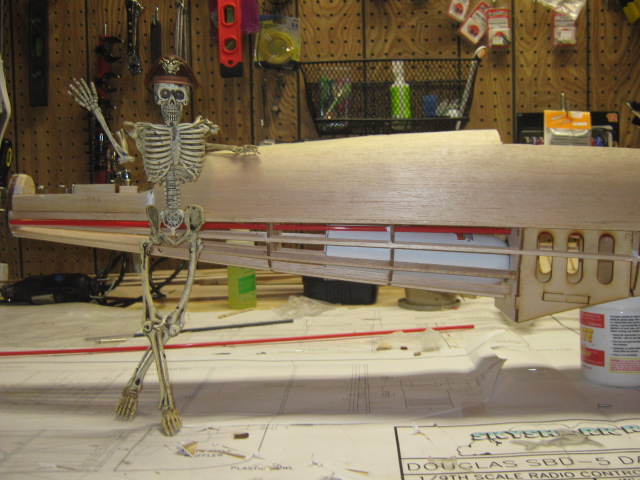

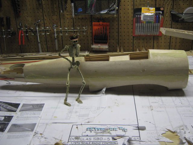

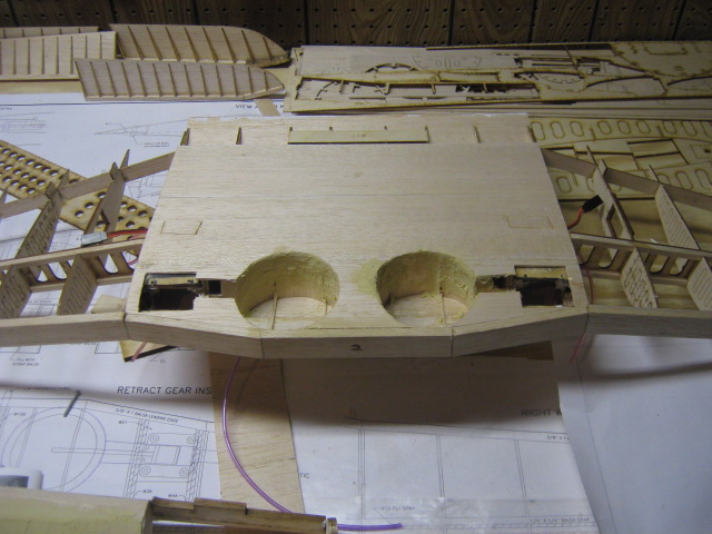

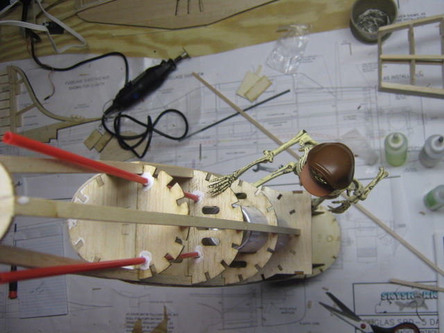

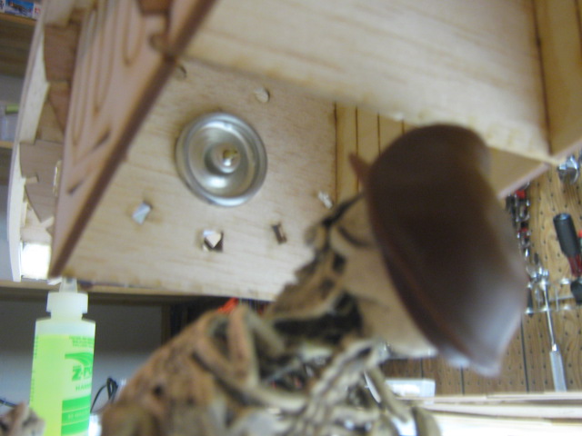

WOO HOOO well everyone just got an email from skyshark they are firing up the kit production again....so lets support them i have the hellcat and avenger those are in the shop and waiting to be built after the dauntless...
OK onto the build again im on the wing still and the fuse i just got done covering the bottom wing and gluing the firewall into place ((this is going to be the time i fix up the blind nuts for the mount im overpowering this bird with a super tigre 60 or a g-51 dont know yet but i will know by tonight what do yall think? well here some pics any questions please ask

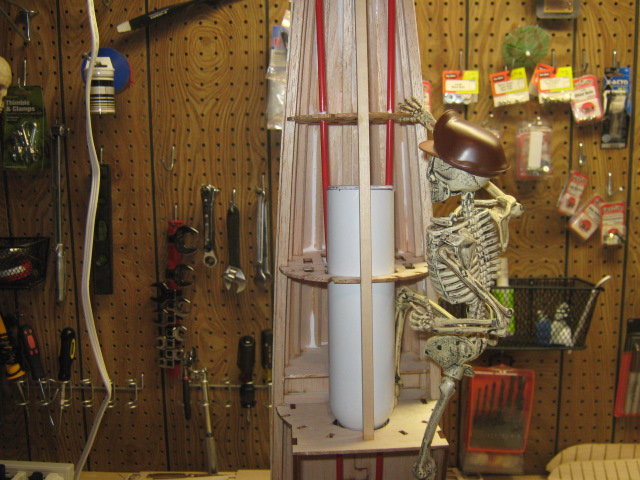

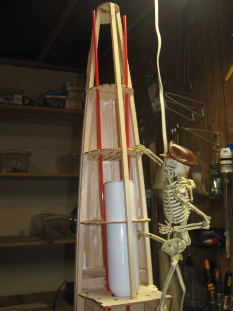

well late last night started on the wing saddle and the bottom aft fuse.. if you plan on building pay close attention to this part after i framed up the saddle and did a fit test the angel of the offset on the firewall off sets the saddle so just a quick hit with the sand paper and walla! also installed the air tank for the retracts going to try and get some more done in the next few days gonna be a lil slow with working 12hr shifts building should pick back up this weekend!

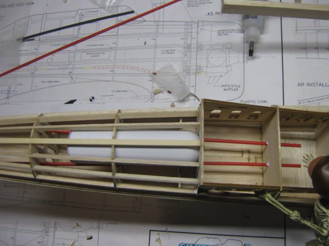

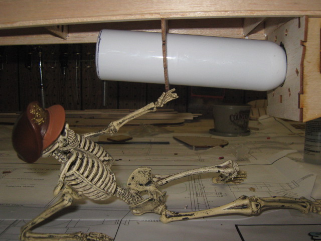

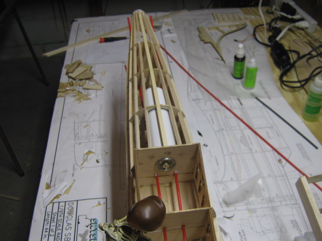

luv the skeleton , adds a nice touch. you mite want to add a hatch so you can get that air tank out, if you need to.

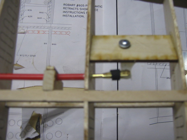

Please forgive me for the delays! [&o] .. my work schedule keeps changing but as for right now should stay the same till new year.. i have been in a holding pattern as stated above but all my lil trinkets are coming together got the SECRET add on and will share later when its properly working should not be more than two weeks until i am able to finish the frame to where it can be installed ..but since then i have dabbed at working in the cockpit well the panel for right now.. here are a few pics more tooo coooomeeee!!!!!

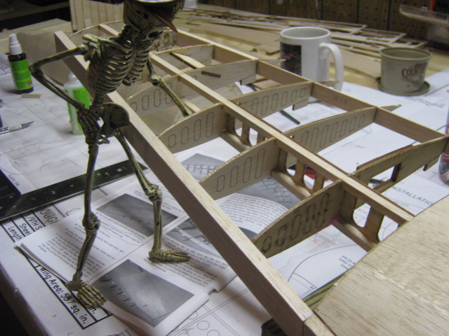

Are you suppose to leave the wood in the lightning holes in the ribs?

No I'm leaving them in due to fat finger breaking syndrome! I'm doing a few add ons in the wing and don't want to keep gluing the ribs back together! They will all come out just before bottom sheeting is started..
