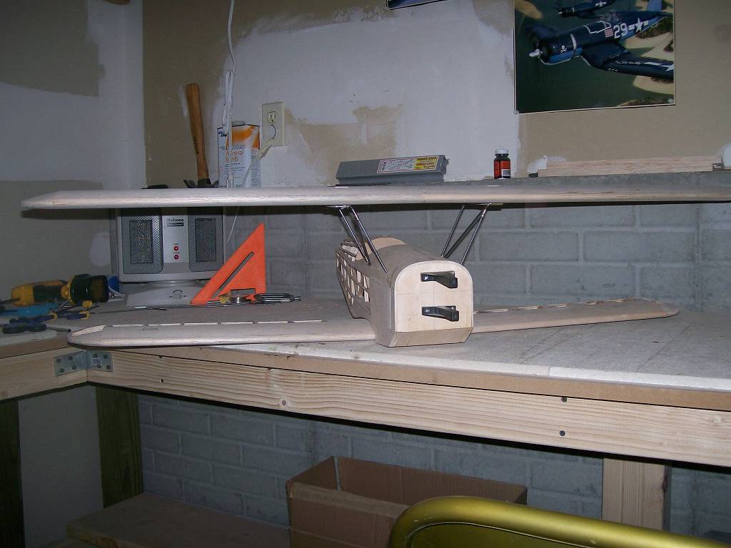

Here's some photos of my Smith Miniplane framework. What a challenge! I just assembled the cabanes today. I'm having trouble soldering the brass straps to the 1/8" wires. Any suggestions?

Just rough up the music wire and brass with 220 grit sandpaper, then clean the surfaces with rubbing alchol then apply the flux and tin the music wire first, tinning is putting a surface coating of solder on the wire first, before joining. Then put flux on the brass strap and position in place, heat the two parts and add a small bit of solder to allow it to flow out between the two joints. Your done, if your worried about burning the ply plate, you can make a mock-up set that holds the straps in position until the solder joint is done, then install the real plates after the straps are done. This is what I did on mine, it saved the wood from being destroyed and made the sealing and painting much easier, since it wasn't chared from the soldering iron.
EDIT: Silver solder is great, but the temps to melt true silver solder are so extreme that in this application, it requires a mapp gas torch or a acetylene turbo torch setup to flow-out, which means you'll surly burn the ply plate between the straps. If you want to silver solder the brass straps, buy the bernzOmatic low content silver solder with thier flux this is all you'll need to make a secure joint, and yes, I know the properties of silver solder before anyone flames me, I'm a HVAC service tech that solders, silver solders, brazes and welds for a living, so please don't start.

Thanks for th advice. Last night, I took the straps off the wire and decided to start fresh. First, I'm gonna take a break from working on this. Been messing around with this all day!

Well, I decided to go to the Hobby shop and get some equivalent thickness brass, rather than clean up the mess I made on the first try. This morning I was successful using the method Planebuilder66 suggested. I post pics later when I'm finished epoxying the plywood in place.

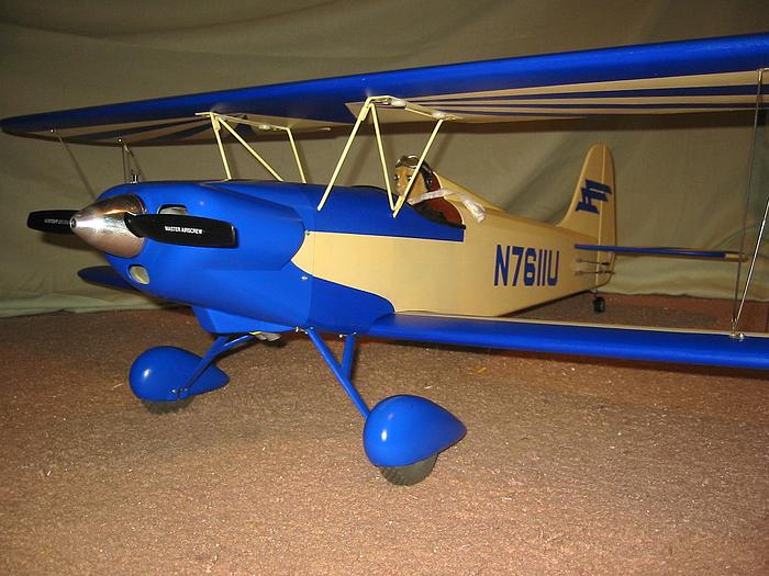

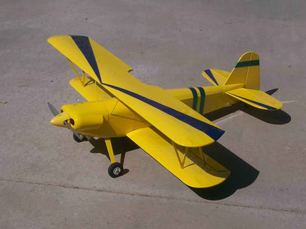

Old 04-17-2010 | 07:43 PM
Joined: Mar 2009
Posts: 51
From: Lincoln, NE
Default RE: Miniplane Progress
Well it's been a while since I submitted a post. I finally finished my Smith and flew it today for the first time. Everything I've read in here was true. I'm glad I payed attention. Here's some pics
