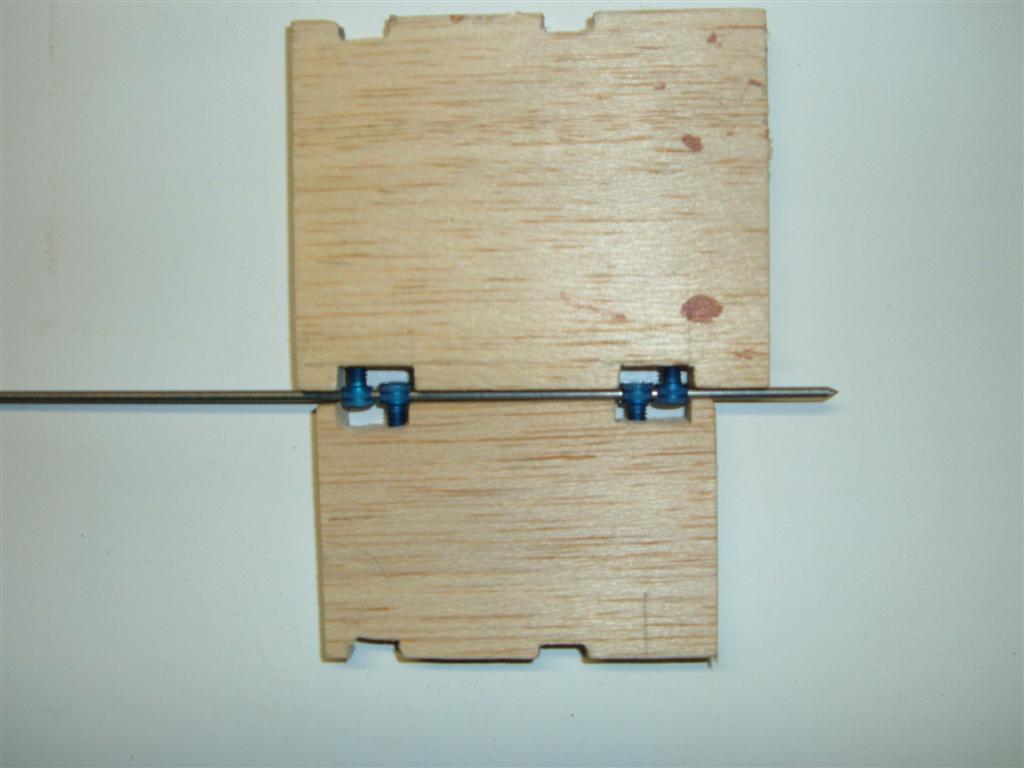

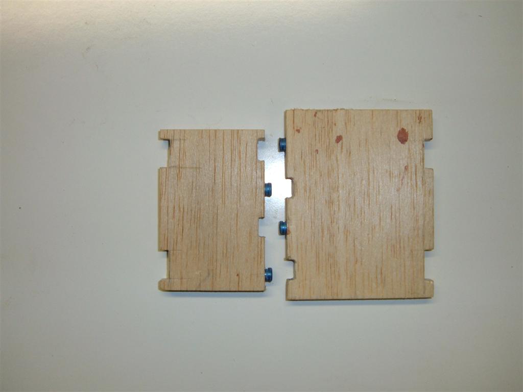

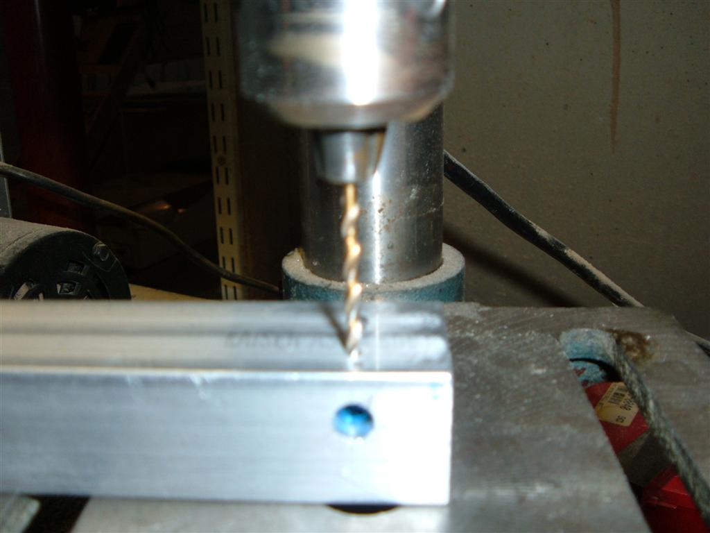

Hinges and covering a plane is not a fun thing for me, building is. Now I am an old guy of 70 so I try to make my building as easy as I can. I cover my planes with vinyl because it is easy to do and strong. Now to the hinges. After playing around with these home made hinges I found this one to be the easy one to make. The hinge is made from an aluminum 8-32 X 3/4 socket head screw. About $8 a pack of 25 from Mcmaster Carr, they have some in nylon also $6 per 100. I made a drill gage to drill a 3/32 hole through the head for the 3/32 music wire hinge shaft done, now was that not easy. Drill a hole in the balsa with a 1/8 brass tube drill. Don't try to push the screw into the hole screw it in, I did one and did not put glue on it and it never came out. Now you will need a short piece of music wire about 2 in. to line up the screw with the hinge line and to make sure it is screwed in so the shaft is flush with the balsa I use a slow cure CA glue on the treads, any kind of slow cure glue will work. You will see in the pictures there is no gap on the hinge line. No V on the balsa, if you need more throw sand the edges a little. Put the screws were you want no hole to line up with on the other piece. I am going to try 1/16 music on my next plane.

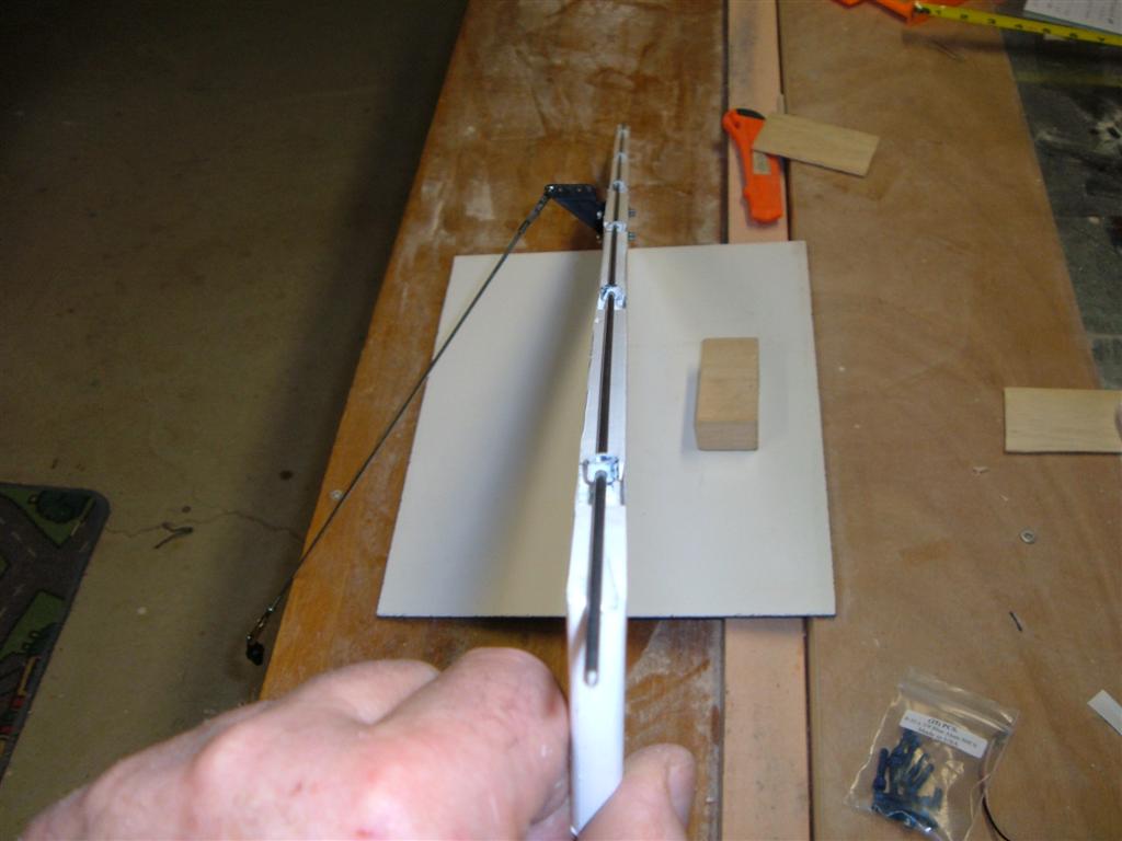

I did check that out Vicman but could not find any in aluminum. On bad balsa I did put thin CA in the hole and then slow cure CA on the threads. Here is a picture of a rudder with my no gap hinge.

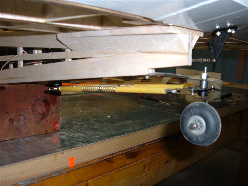

Another thing I have done is made push-pull controll rods for the tail wheel spring loaded.
Ken

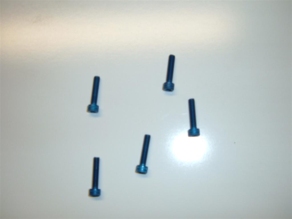

I got the nylon socket head screws today. I got 100 6-40 for $6 and 100 8-32 for $6, now that is a lot of hinges. The one on the left is the 6-40 next to it is the 8-32. To night I will make a mock-up and post pictures . I am going to use 1/16 music wire for the hinge shaft to see how that works.
