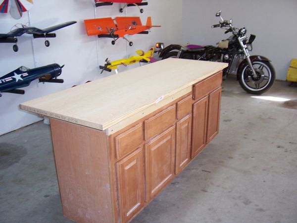

I built this one using a couple of free cabenits and a $2.00 . 36in door slab . My shop is pretty good size , which makes it nice for walking around.

Insanemoondoggie,
I am planning the same thing only while Lams mounted on casters to make it mobile,, I'm banished to the basement for now unfortunately
Maybe next year when I get Garage heat thing will change

Default RE: Workbench layout
Thats a good idea. I should have made a frame to set the cabinets on but since it's rarely moved it works out O.K
I had to buy a new slab this year ,as I split the cases on a motorcycle on it and the wieght warped the door a smudge . I should have known better. but another $2.00 door slab , fixed her right up.

ORIGINAL: Insanemoondoggie
Cabinets like that work great. In my old house (when I was single) I got several kitchen cabinets for free that were pulled out during remodeling jobs and put them around the perimeter of the garage. I made wood tops for them banded with oak. Once they were all painted to match, it looked great. I even had a rolling bench that was stored against a wall but could be pulled out into the center of the room. I had to build my upper cabinets though but that was no big deal. I just did poplar face frames held together with pocket screws on plywood boxes, adjustable shelves, etc. I miss that garage. My current one is actually a little bigger but the wife's car is in there.

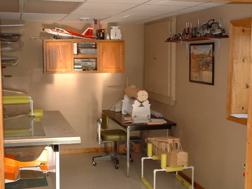

I have 4 benches in my shop. Building bench which is an island, power tool bench, glue and misc storage bench then a finish table or just crap storage. I like to have the build and power bench close to eliminate steps. Setup is the general rule of a kitchen-Triangle shape-this helps in overall steps.
