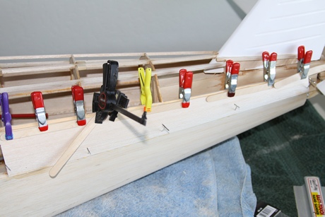

FYI, titebond works on clothes pins too.

You didn't. Please tell me you didn't.
Ah, memories. Clothespins, hobby pins, weights, clamps, even rubber bands. Assembling an entire wing, then gluing the whole thing and waiting overnight for it to dry.
Remember the dope smell, too? Tissue, silk - brushing coat after coat while you got high.

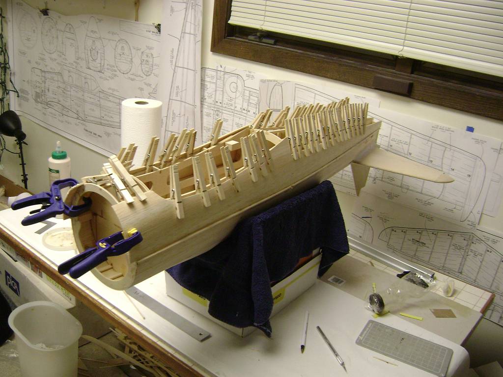

When using clothes pins, run a line of popcycle stick along the outside (exterior) of the wood and that will prevent the clothes pin dents!
I'm doing somewhat the same thing...

The popsicle sticks is a good idea. I am just trying to think how I could make them look like part of the plane once I glued them on along with the clothes pin. I now use wax paper to cut down on the clothes pins sticking to the wood. The wax paper does come off easier and it does sand off with the excess glue. Good Luck, once again, Dave

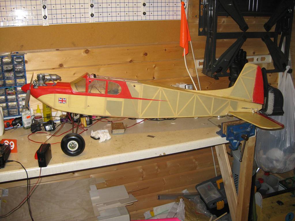

Warburtons bread still comes in waxed paper. Eee it's reet gradely for cutting into little squares to put beneath each joint in a Wakefield or similar.
I used Warburtons to make my Super 60
