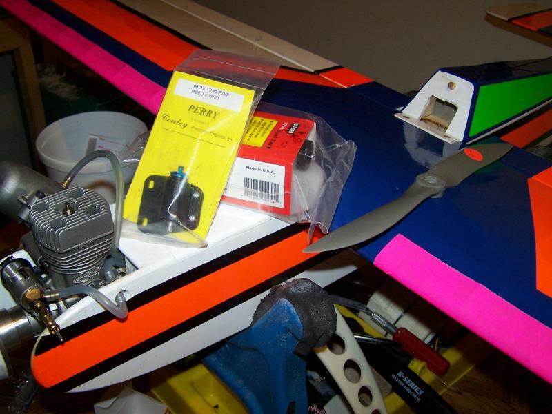

I enlarged the ailerons on my midstar to 2" tapered to 1.5 at the tips. I used 2 servos instead of one. She was A LOT more fun with the larger aileron!!! Yes lots of neon, this was from my earlier days of flying. Neon calmed me down. I powered the midstar with a supertiger g61. It was CRAZY!!! I loved this plane. I bet she got 1000+ flights
