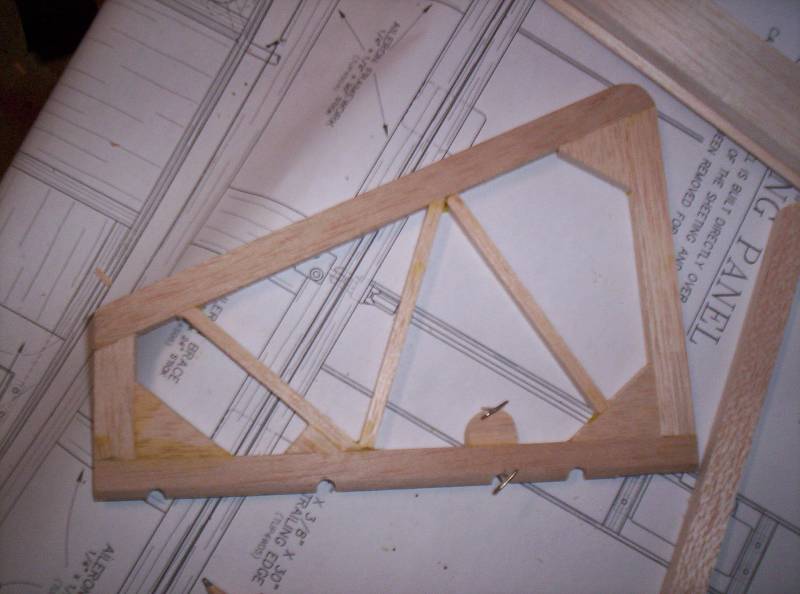

I like Robarts as well, as long as you are working with thick enough control surfaces. Some planes use 3/16" flat sheet for their stabilizers, rudders and elevators. I mostly use 1/8" hinge points, which would leave very little material on either side of the hinge. There are smaller hinge points, but for smaller surfaces, I just go with CA hinges.
In addition to using the Robart drill jig to make your holes, I also like to use a 1/4" round file, run across the leading edge of the control surface, to create a pocket for the hinge. I used to try and make a countersink with a phillips screw driver, but that didn't give me very tight hinge lines.
Also, if you are hinging a stick-built surface, you want to make sure that you have at least 2 ridges of the hinge within the wood. If not, just add little blocks of balsa behind the hinge to give the hinge something to bite into.
