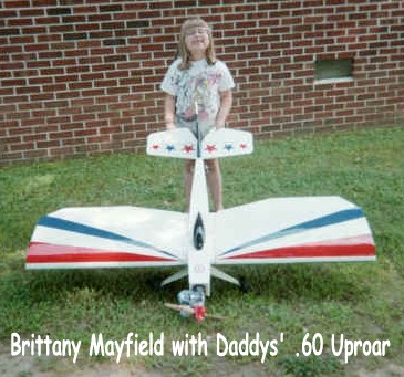

Iam building a tower uproar .40 was wondering if there are any good mods our good building tips thanks

Great chioce ! I would throw the stock main landing gear away and get a more durable set such as aluminum or the composite type. Sheet the wing where it joins the fuse instead of just placing capstriping. It will be more durable and make covering alot easier. Reinforce the landing gear area with some scraps of plywood. If you mount the engine on its side it will be alot more cleaner. Paint the inside of the canopy with black paint from Wal-Mart for the cool factor. Drill 2 small holes in the canopy to allow heat to escape. Check my gallery for my old Uproar .40. I also added my new Uproar .60. Good luck.
