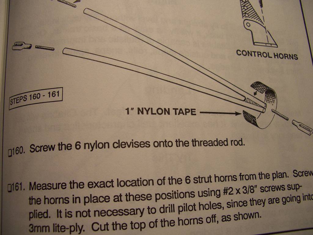

I have yet to get any detail information on the wing struts and tail brace wires for my Midwest 80 inch Citabria, although most of you have said they are required.
I have the article and plans for the RCM 1/3 scale Champ 7AC. Is the strut and brace wire detail the same (in detail, scale is different of course) for the Citabria as for the Champ, from which it was derived? Thank you in advance.

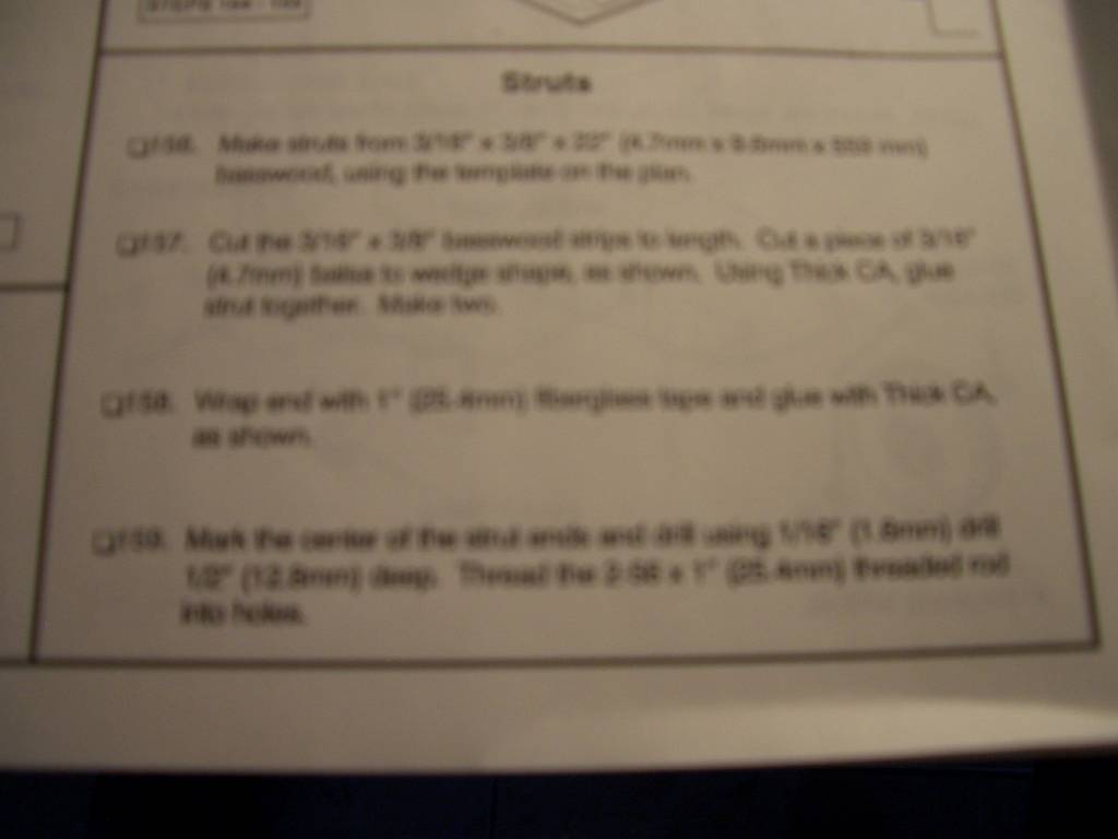

I just got back from climbing into my warehouse containing a New in Box Midwest Citabria.
There is no evidence of wires on the tail either in the plans or the construction manual or the pictures on the box.
Regarding the struts. They are made from 3/16" x 3/8" x 22" Basswood.
Threaded rod 1" X 2-56 in all three ends.
Nylon clevises in all three ends that connect to Control horns on the Fuse and the wing.
The control horns on the wing are located on top of the rib that holds the aileron servos.
These control horn hard points measure 3/4"x 3/4" square.
One is 1 and 1/2 inches in from the leading edge and the other is laocated 6 1/4'' in from the leading edge.
The control horn on the fuse is located At the back edge of the landing gear.
Hopefully the pictures of the construction manual come out as this is a first time effort for me.

#30
RE: Midwest Citabria wing struts and tail braces
Thank you, thank you ver' much. The timing is very good, as wind and wet have kept me from maidening the Citabria. So, I can do the struts and make it look right.

Spaceworm , who requested the info, wanted to know what the actual plans called for and that is what I sent him. The drawings were actual photographs of the Midwest Citabria model that Spaceworm is building. There is no call for or plans for wires on the tail for the Midwest Model.
