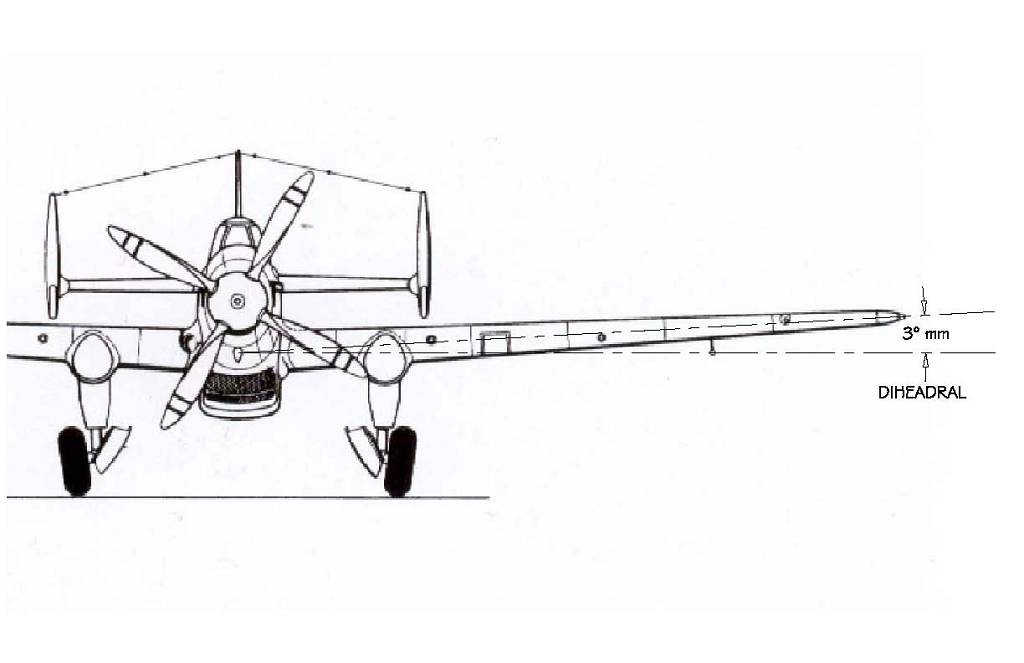

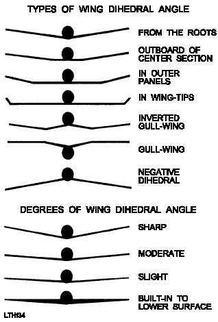

Old 07-23-2010 | 07:38 PM
ByLoudDesign's Avatar
Joined: Sep 2005
Posts: 1,456
From: Mesa, AZ
Default RE: dipheral??????????????
HERE YOU GO!!!
Old 07-23-2010 | 07:39 PM
Joined: Sep 2005
Posts: 1,456
From: Mesa, AZ
Here you go!

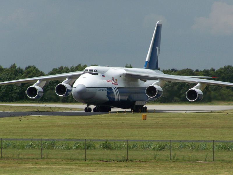

Old 07-23-2010 | 07:52 PM
Lnewqban's Avatar
Joined: Apr 2007
Posts: 4,057
From: South Florida
http://en.wikipedia.org/wiki/Dihedral_(aircraft)
Old 07-23-2010 | 08:29 PM
Joined: Jan 2008
Posts: 278
From: El Paso, TX
excellent. pictures are worth alot of words, got it totaly different then what i was thinking or previously told. thanks

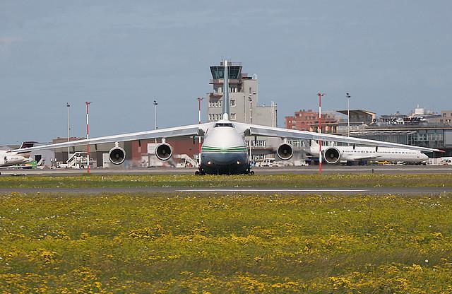

Lnewqban's Avatar
Joined: Apr 2007
Posts: 4,057
From: South Florida
The negative dihedral is also known as anhedral.
This is used for airplanes that are so stable in roll, that need some help from a wing with anhedral (opposite to dihedral).
