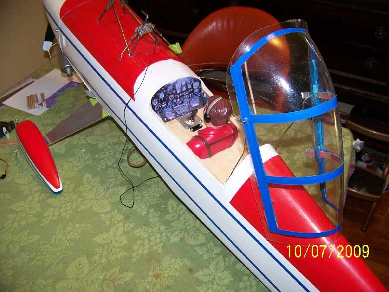

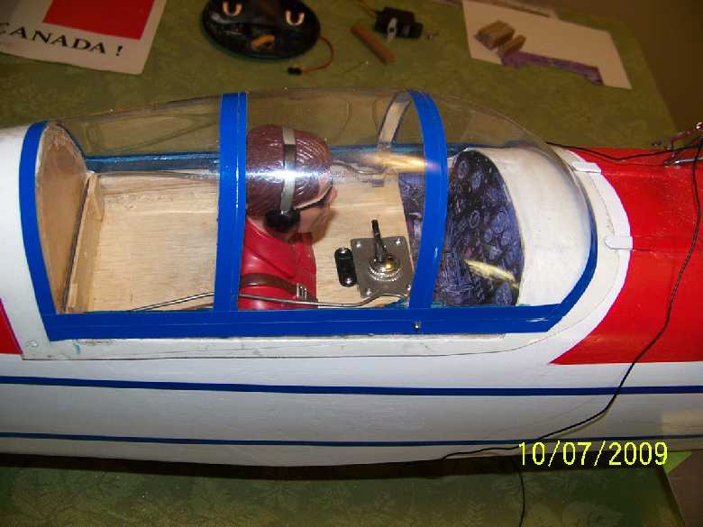

Here is another idea that woked very well
Zor

I do not have much to add to this topic else than many canopies are held by a couple of little dowels at the front and a couple of little magnets at the rear.
Zor
