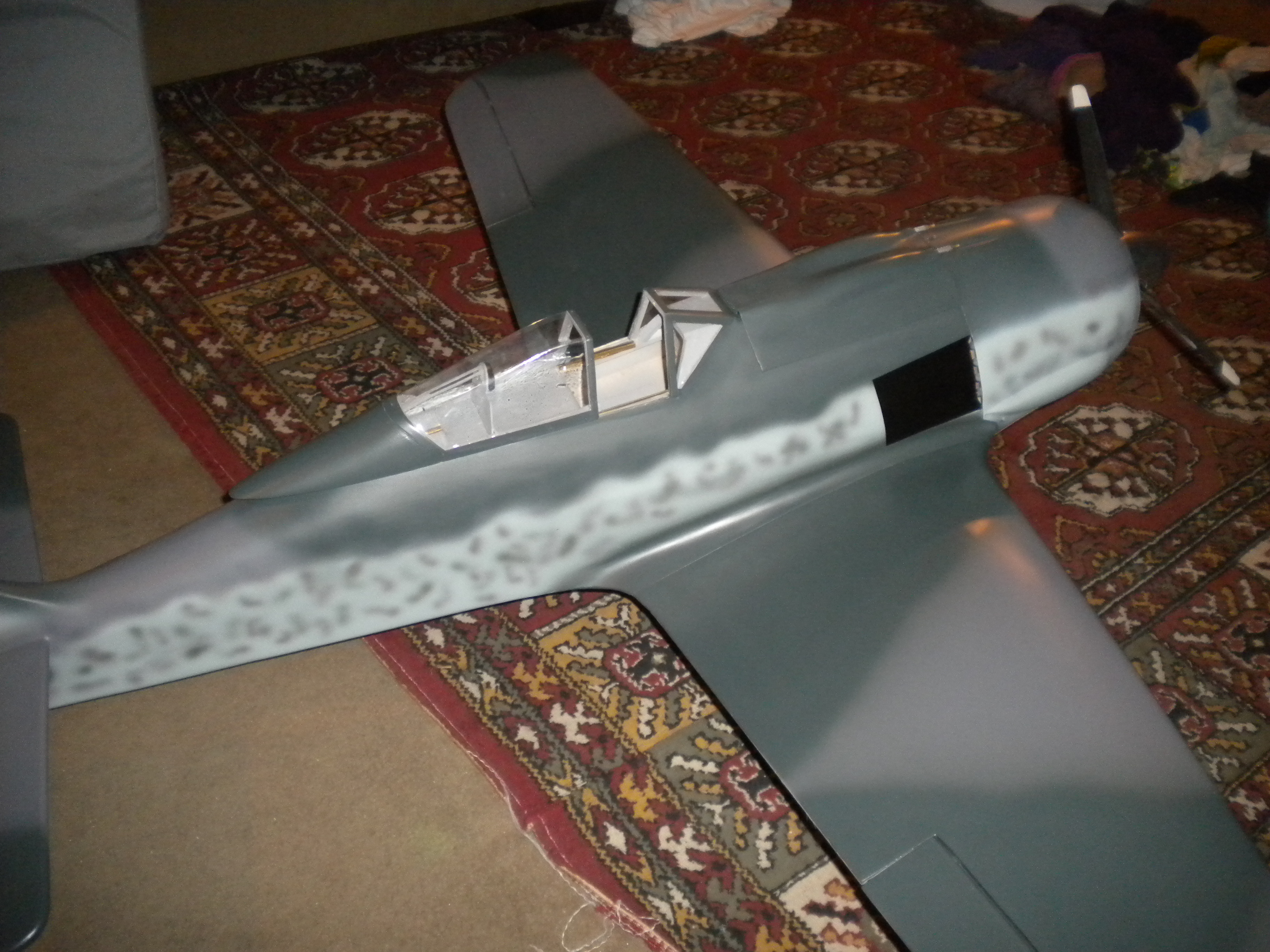

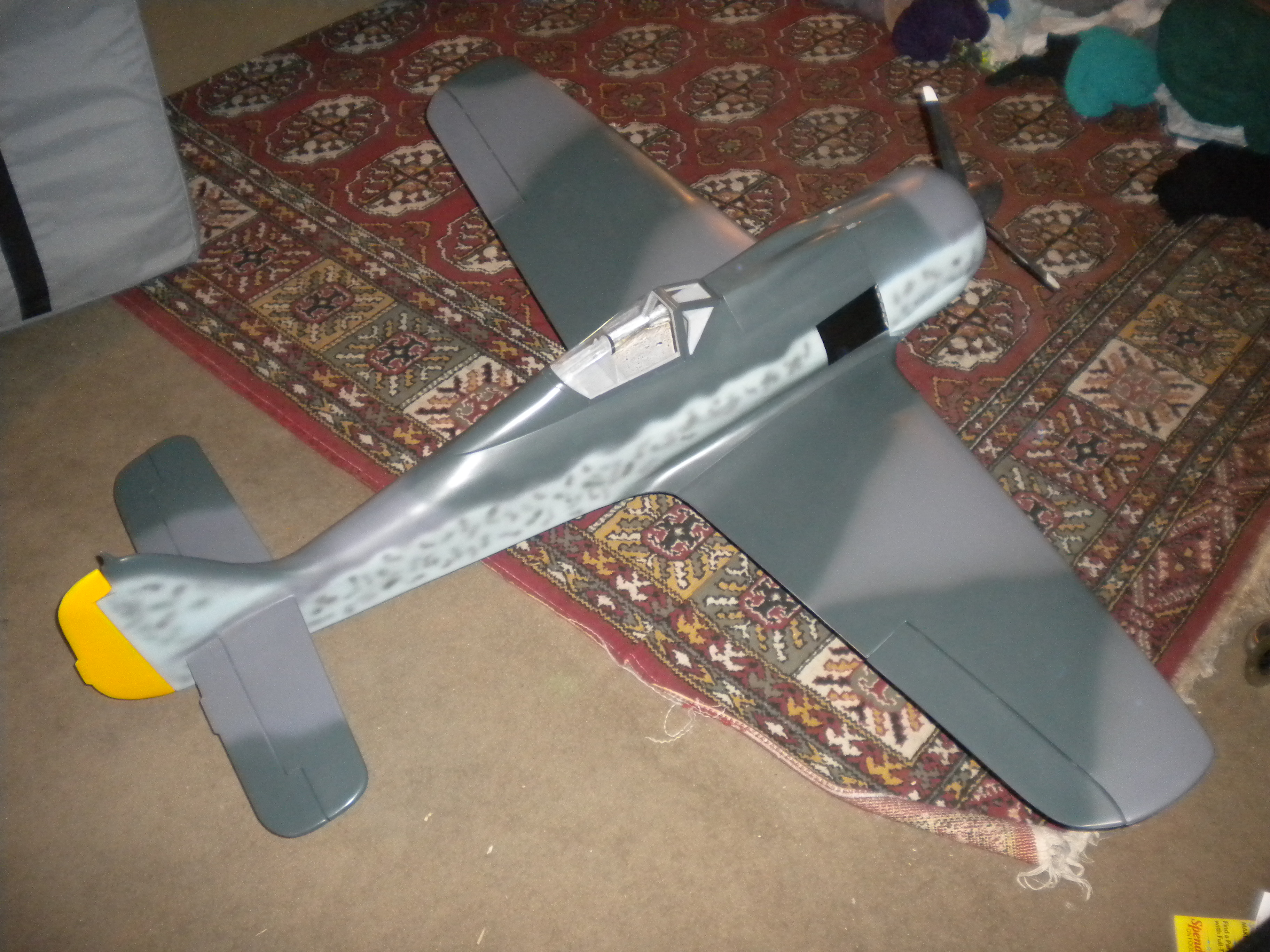

bigtim 03-19-2014 10:30 AM
2 Attachment(s)
you don't want to paint dope over rattle can primer the dope works like a stripper and will just make a mess, you can spray the primer over dope if you like but not the other way around I have done several models the way gene6029 described with great results using Deft as a sealer and water based products like Varathane poly as a resin for bonding the light weight fiberglass to the surface.
my latest project a FW190 ready for insignia's was glassed using this method there are other threads covering this method here is mine for this model http://www.rcuniverse.com/forum/rc-w...l-fw190a8.html .
http://www.rcuniverse.com/forum/atta...mentid=1979525 http://www.rcuniverse.com/forum/atta...mentid=1979526
