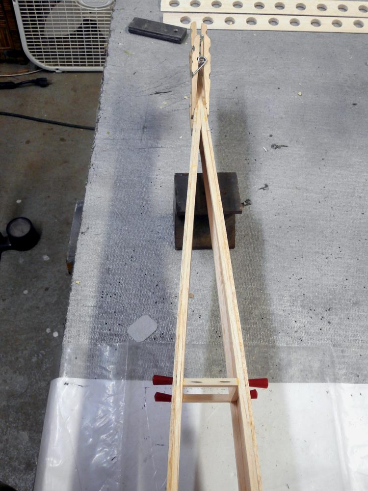

The instructions say to start with the wing, but I am intending to build a special jig for building that so I decided to start with the tail feathers instead. Nothing in their basic construction requires that something else be built first, and seeing as they are the simplest part anyway, it seems a good route on the way to getting my hands dusty again.

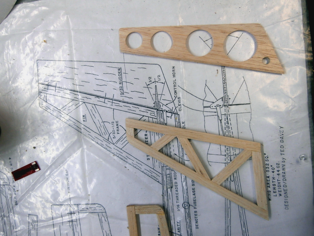

First thing I did was to plane the TE taper in the rudder and elevator pieces. Then I got the hole saws I bought and start drilling them out. I found the hole saws worked best when I screwed the pilot drill into the proper size and then used them as hand tools, twisting them back and forth slowly boring until I was halfway through one side, then turning the piece over and using the same pilot hole to cut the rest of the way through from that side. Doing it this way resulted in a nice clean hole with a minimum of feathering left in the wood, What little there was was easily sanded away with some 220 grit sandpaper.
http://www.rcuniverse.com/forum/atta...mentid=2085323
Unfortunately the hole saw set I bought only went down to 1" diameter, which was too big for the elevator pieces. So I am going to have to find something smaller. Say 1/2". I didn't get to the 1.25" tapered TE pieces drilled out; I'm really not sure if I should use the 1" hole saw on that anyway (perhaps a 1/2" or 3/4"?). Or for that matter if I should even drill those out at all! The full span of the 'CambFlexer' pieces are over 31" long, and even with the control horn mounted at the center that makes for a long span to be full of holes.
I did get the horizontal and vertical tailfins built up though. Once they are cured i will sand them to shape. Last thing I did was to put the elevators together with the bent music wire connector piece. I could have used CF, but after weighing the steel piece and a short piece of cf tubing that was even bigger that what I would have used i found both weighed less than 1 gram (the least my postage scale could detect), so I figured any weight difference would be so negligible as not to be worth the effort. So I epoxied the music wire in place.

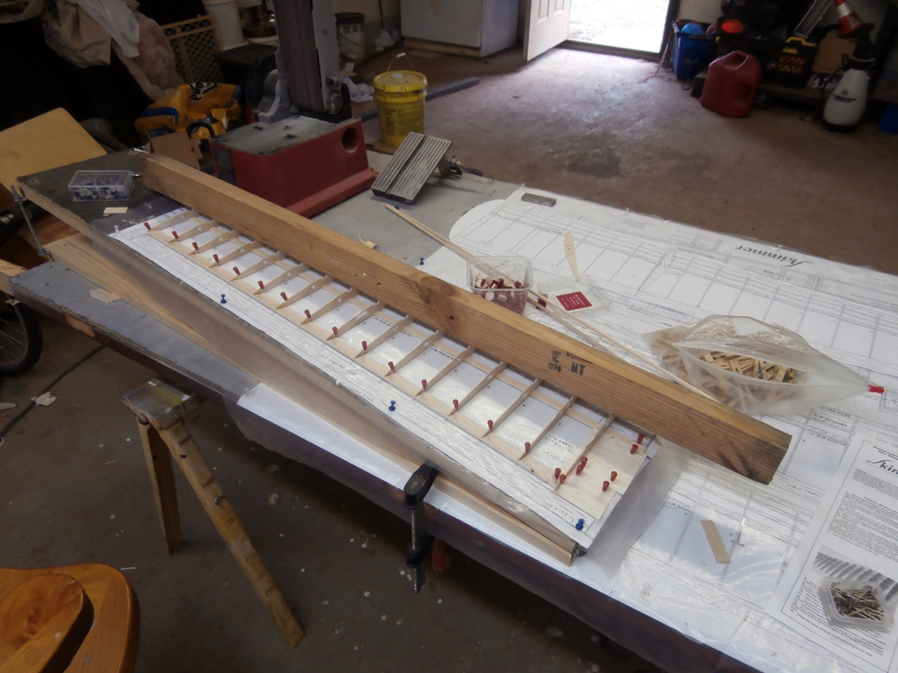

Built the WashBoard
This will not only let me construct the wings with washout built in, but will also let me accurately set the dihedral angle. I made it a bit bigger than necessary for this bird so it can accommodate larger wing sections in the future. Each side measures 10" x 48" and can be unfolded (completely flat if necessary) to accommodate two wing sections. It was fabricated from two 1" x 10" x 48" pieces of pine, a continuous hinge cut to 10", four 1/2" corner brackets, Two 1/4-20 x 8" carriage bolts, six 1/4-20 nuts and of course the pin-board and assorted wood screws. Construction is simple and straightforward enough that anyone should be able to copy the design from the photos.

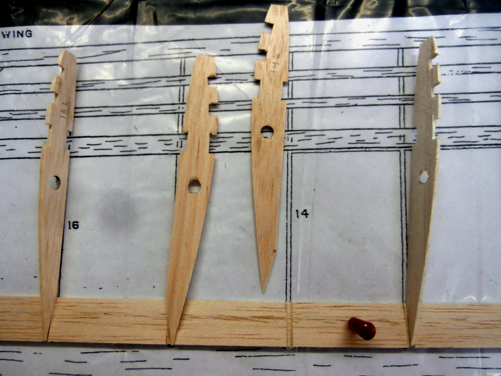

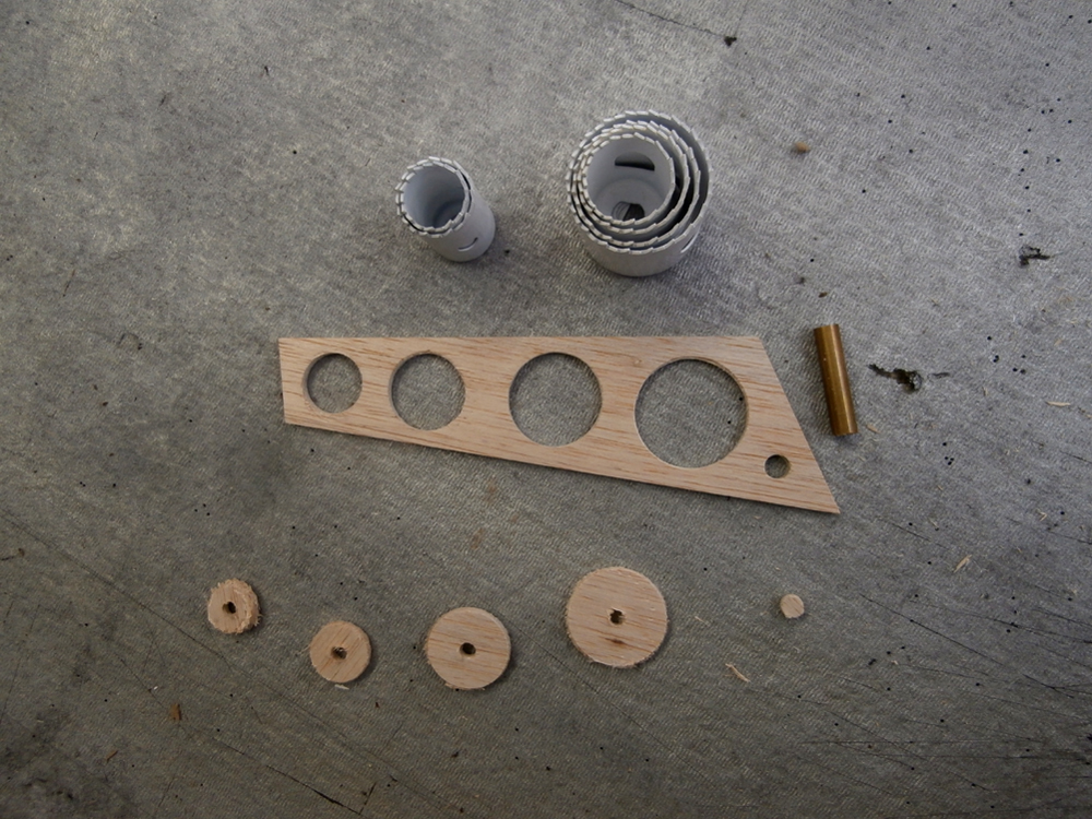

I used a round file to sharpen one end of both the .250" and .625" TW tubes. I cut the .250 into a shorter piece as it was small enough that it could be chucked into my drill. I used it to bore the holes for the servo wires through the set of ribs with the spar slots lined up with a short piece of spruce. I will have to widen some of these to allow the plug to pass through, obviously. Once drilled I used that hole to clamp them all together with a 1/4-20 bolt and wing-nut so I could shape and sand out the irregularities of the die cut (which were rather nice, I might add, I guess the dies were sharp for this batch of wood).
http://www.rcuniverse.com/forum/atta...mentid=2086067http://www.rcuniverse.com/forum/atta...mentid=2086068
I then marked the 1.250 cambflexers and used the .625" TWB tube as a hand 'hole saw' to drill it out. When I was finished I didn't notice any significant lessening in stiffness, so I guess with the covering they should work fine. Exactly how much lighter they will be I have no idea, all the 'holes' didn't weight much. Then again 1 penny isn't that much either, but enough pennies all together will buy you a house, right?

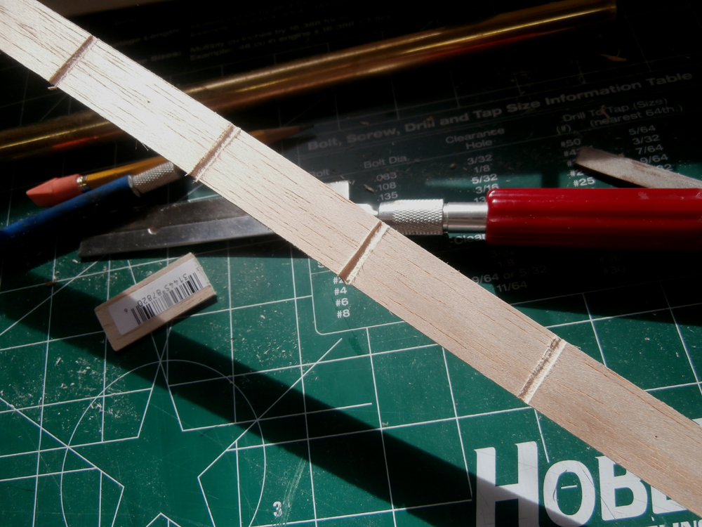

Last thing I did was to cut and file notches into the .750 TE and cut and trim the ends of the ribs to fit. At least those for the left wing.

Ok, First there's maybe a little more cutting, drilling, shaping and sanding that needs to get done before I can get out the glue. First thing I did was to get out my 5/8" TWB hole saw and put some holes into the elevator (forgot to do that the other day when I did the cambflexers :o ).
http://www.rcuniverse.com/forum/atta...mentid=2086636

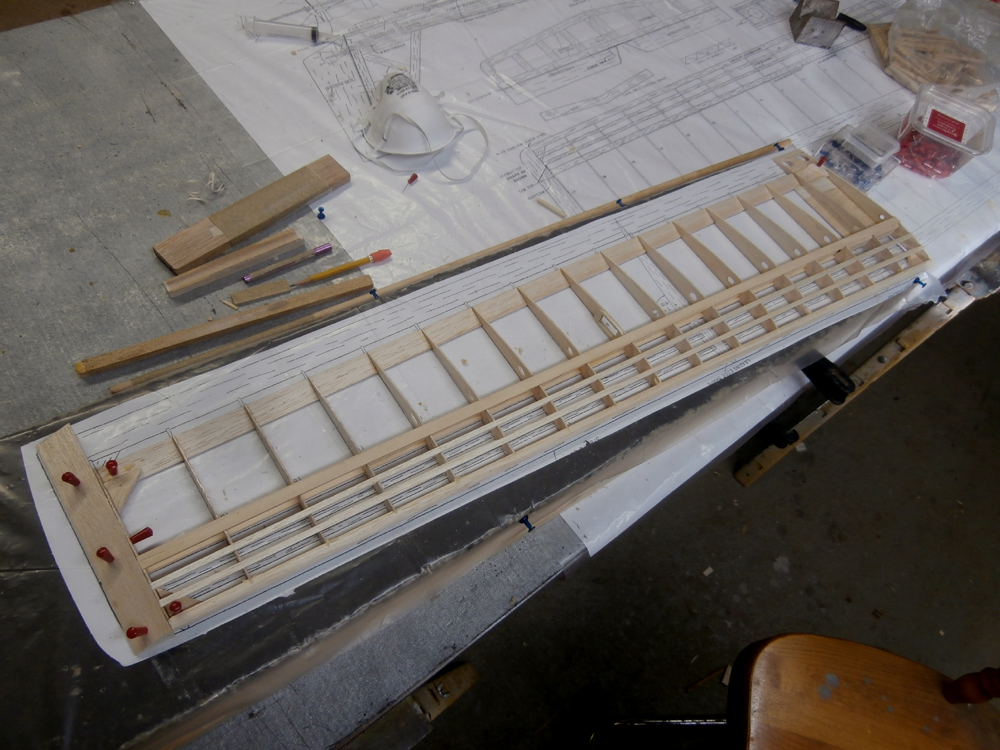

Also used the #1 rib that came with the kit as a template to make a pair of light ply copies. Normally the two 1/16" balsa ribs at the wing center get laminated together in the construction of the wing as a single piece. But I'm not making this wind as a single piece, so those two ribs are not going to be laminated. Therefore I'm substituting light ply to make up for the lack of strength.
http://www.rcuniverse.com/forum/atta...mentid=2086634 The violet tube is the substitute for the plywood dihedral brace (also shown) that would have been glued in place. Most people use brass for this, but I found an alumini(u)m Heli boom that is just as stiff, if not stiffer, and it's also much lighter than brass. Heck, it's even a whole gram lighter than the plywood brace it's replacing.
I had a little trouble with the wing, my fault really; I pinned the rear spar too far back and didn't realize this until everything was pinned in place and the glue had almost dried :( So I had to remove it, shorten the back end of the ribs while still glued to the rest of the structure, re-notch the spar and re-glue it all back together. As such I was only able to get the bottom half of the left wing done.

Here is the glued wing. The instructions say to attach the top spar and glue the shear webs onto the side of the spars, but I'm doing things a bit different. on this page at http://www.airfieldmodels.com it is claimed that the webs fit between the spars is stronger than when glued to the sides.it makes sense so I'm going to cut and fit each web on the center of each spar before gluing the top spar on. At the very least it will lighten the wing an itty bit because there will be a wee bit less glue and wood.

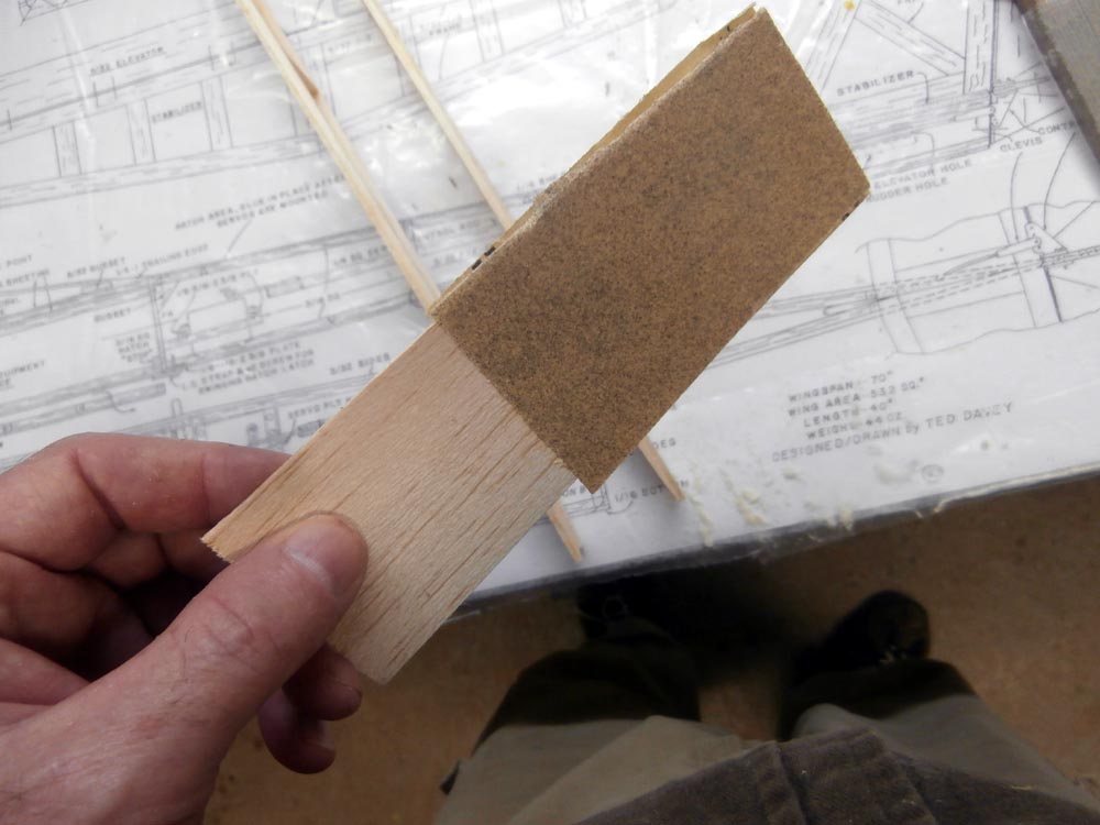

Once it was dried I sanded it to shape using my belt sander, razor plane and sandpaper http://www.rcuniverse.com/forum/atta...mentid=2087555

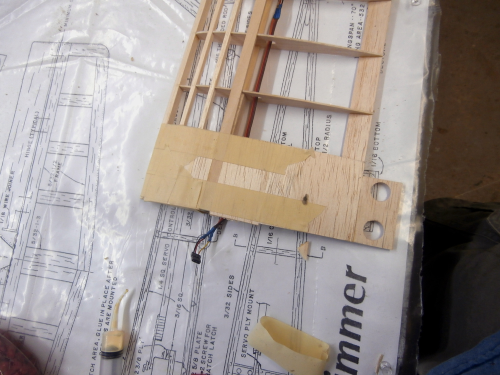

Today I soldered the extension wires onto the servos, fed them through the holes in the wing ribs and screwed in the servos. A drop of CA on the sheeting at the root holds the wires straight. I didn't bother with the soda straw trick, this looks Just as clean and I didn't have to figure out how I was going to solder the extensions on through the straws, as the joint is about halfway along the line (I couldn't find any straws wide enough for the three wires anyway :rolleyes: ). I also installed a locating pin on the root rib to keep the two wings from twisting Re: to each other and sheeted the root section. Lastly I planed/sanded the 'leading edge' of the cambflexers. I'm going to use a 'UltraCote hinge' to hold them on the wing.

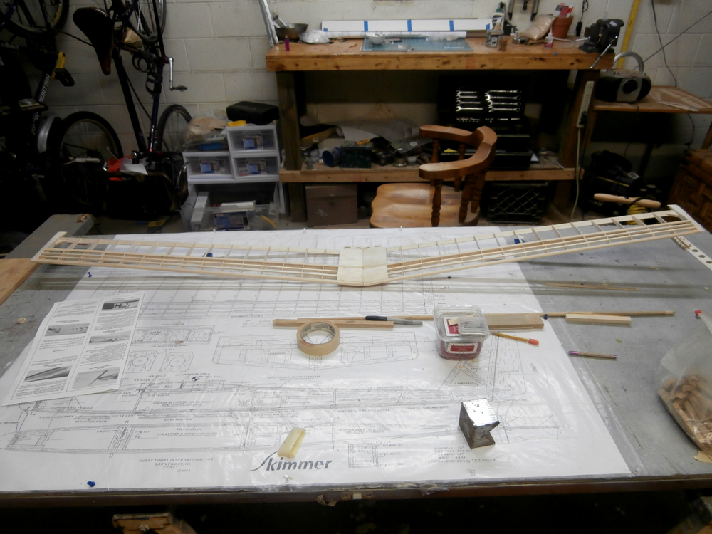

Finished the wings, sanding the sheeting down smooth with the root ribs. When I put them together they fit together nicely enough, with almost no gap, and after weighting one tip so that wing laid flat on the table the other tip measured at 8.125" from the table top. That's measured from chord center, I built in the washout, remember? :D Normally they would have been epoxied together with each tip elevated 4.125", so it seems I'm off by about .125" (0.0625" per side). Close enough; I guess my dihedral fixture works. :):cool:

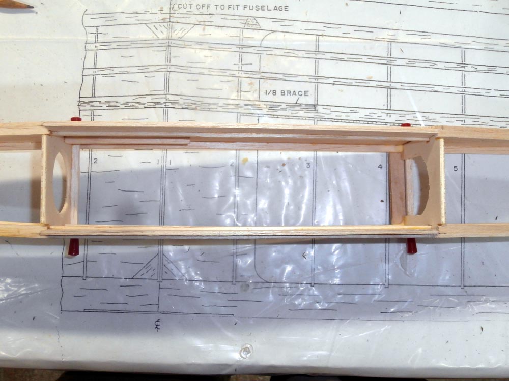

Construction of this starts with the large angle pieces at the nose. Normally these form a backing for the firewall which is mounted at the very front of the plane with the motor mounted behind that, the shaft sticking through. However I know from experience that not only does this leave damn little shaft left for the prop/spinner to grab onto, but it also makes for a fragile front end once all the shaping is done. So I am moving the firewall further back into the fuselage and mounting an outrunner to the front of it. This will make for a stronger mount, give the prop more shaft to clamp onto and as an extra bonus it will alleviate the problem of routing the wires around the spinning motor's bell housing.
http://www.rcuniverse.com/forum/atta...mentid=2089654 The rest of the triangle stock will be behind the plywood firewall, which obviously I will have to custom make as the pieces that came with the kit are now too small; these will be sandwiched in between the front and back pieces. I'm using plywood instead of an alumin(i)um 'X' mount so I can blend the front of the fuselage to match the round shape of the spinner. The remaining fuse section in front of the firewall will basically be a cowl.
http://www.rcuniverse.com/forum/atta...mentid=2089652 The rest of today's construction consisted of adding the 0.1875" Sq. stock that makes the inside corners of the fuselage, the wing cradle doublers and the two 'formers', which I personally think should actually be called bulkheads, as they don't 'form' anything; they only hold the two fuse sides apart and separate it into sections. You'll notice I have changed these slightly, the bottom of the front one has been removed as I will probably have to move the battery pack to balance the plane. Normally it sits under the wing right at the CoG, but because I'm not using the brushless outrunner I will probably have to move it forward.
I did this -> http://www.rcuniverse.com/forum/atta...mentid=2089651
because this -> http://www.rcuniverse.com/forum/atta...mentid=2089655...is being replaced by this -> http://www.rcuniverse.com/forum/atta...mentid=2089653
Removing the lower portion of the bulkhead will make balancing the plane easier in case the proper balance point puts the pack partway 'through' it. This section is not really needed as the latch for the removable bottom panel sits here and it will make up for the missing portion of the bulkhead.

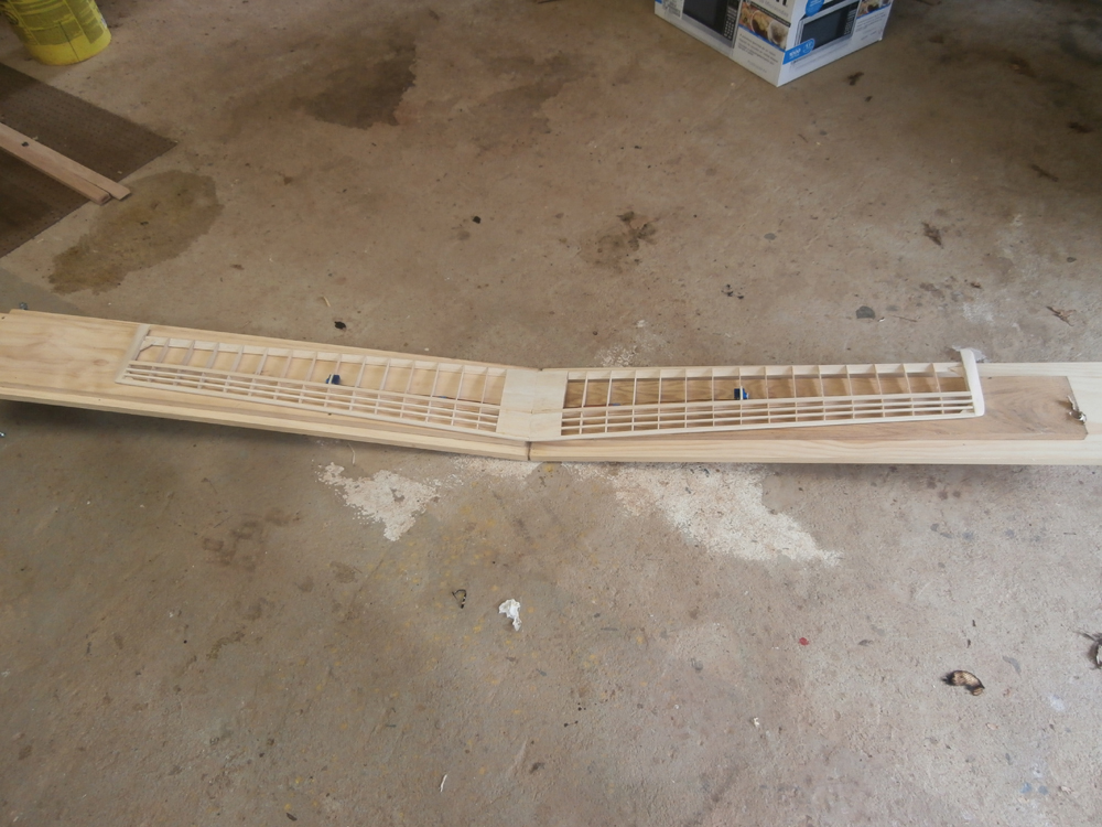

Set up the dihedral table to the proper angle, mixed up some 20 minute epoxy and glopped some into one wing side, slipped the connector in and twisted it in to spread the epoxy. Then used the table to hold the wings at the proper angle while it cured. This will hold the tube in place and at the correct angle. making assembly of the wing halves at the field a lot easier.
http://www.rcuniverse.com/forum/atta...mentid=2090592
Finally I trimmed the hatch, tack glued the canopy on and skinned the bottom of the fuselage with the 1/16 balsa sheet. I'm going to replace the drilled TE pieces at the wing root with something solid, which I will then have to glass (note to self: Get some finishing epoxy!). So since I'm going to need the wing to determine where the turtle deck will start I didn't skin it yet.
