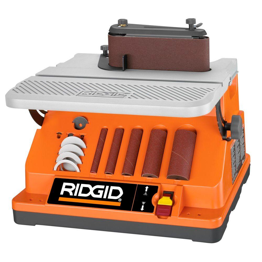

I have three tools that are "Go To" in my shop. I use these more often than many of my other tools as they are more versatile or easier to use in my model building:
1) I've found this sander to be my most used tool in my shop. It's great for sanding out lightening holes and is better when sanding long straight areas than a vertical belt or disc sander.
https://www.homedepot.com/p/RIDGID-5...4424/202459151
Attachment 2268017

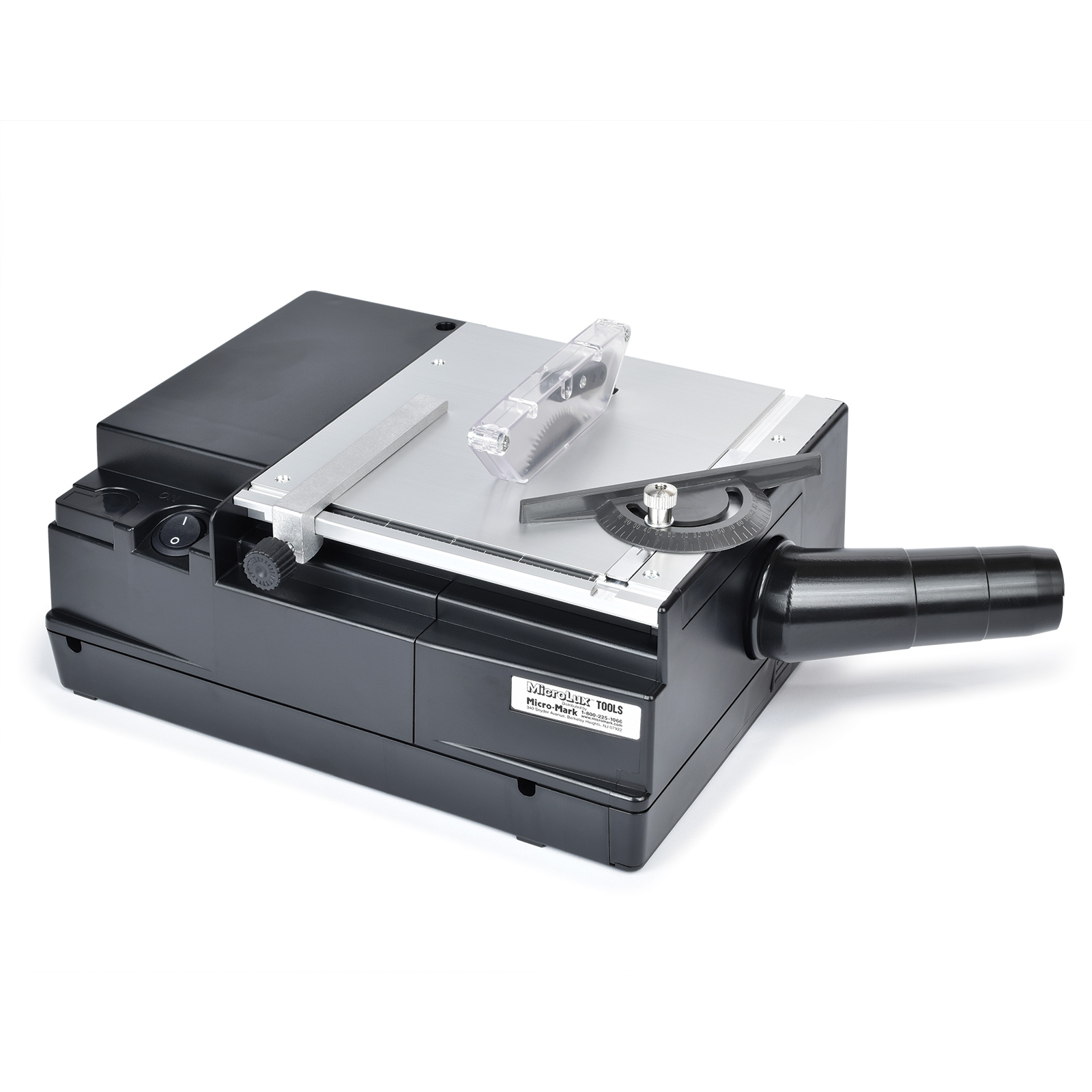

2) I've found this little gem to be great for stripping wood for stringers and gusset blocks, more so than my scroll, band or 10" table saws
https://www.micromark.com/MicroLux-M...op-Hobby-Use_2
https://www.micromark.com/Web Store .../80463_R-1.jpg

^^ Thanks for that post. I've always wanted a tiny tablesaw. My ancient 10" Delta gets used often for other things, but extremely rarely for models. A 3/32" blade kerf eats up way too much balsa.

I bought the table saw for one main reason, cutting strip stock down to the widths I need. To save from wasting a bunch of wood, I also bought a.025 kerf blade, 230 tooth IIRC. I had ordered a bunch of strip and triangle stock from Aircraft Spruce but had to get stock larger than I really wanted or needed, hence the table saw.

An option for you would be a less expensive version that's got a fixed angle blade and a bit smaller.
https://www.micromark.com/MicroLux-M...re-Table-Saw_2
Attachment 2268019

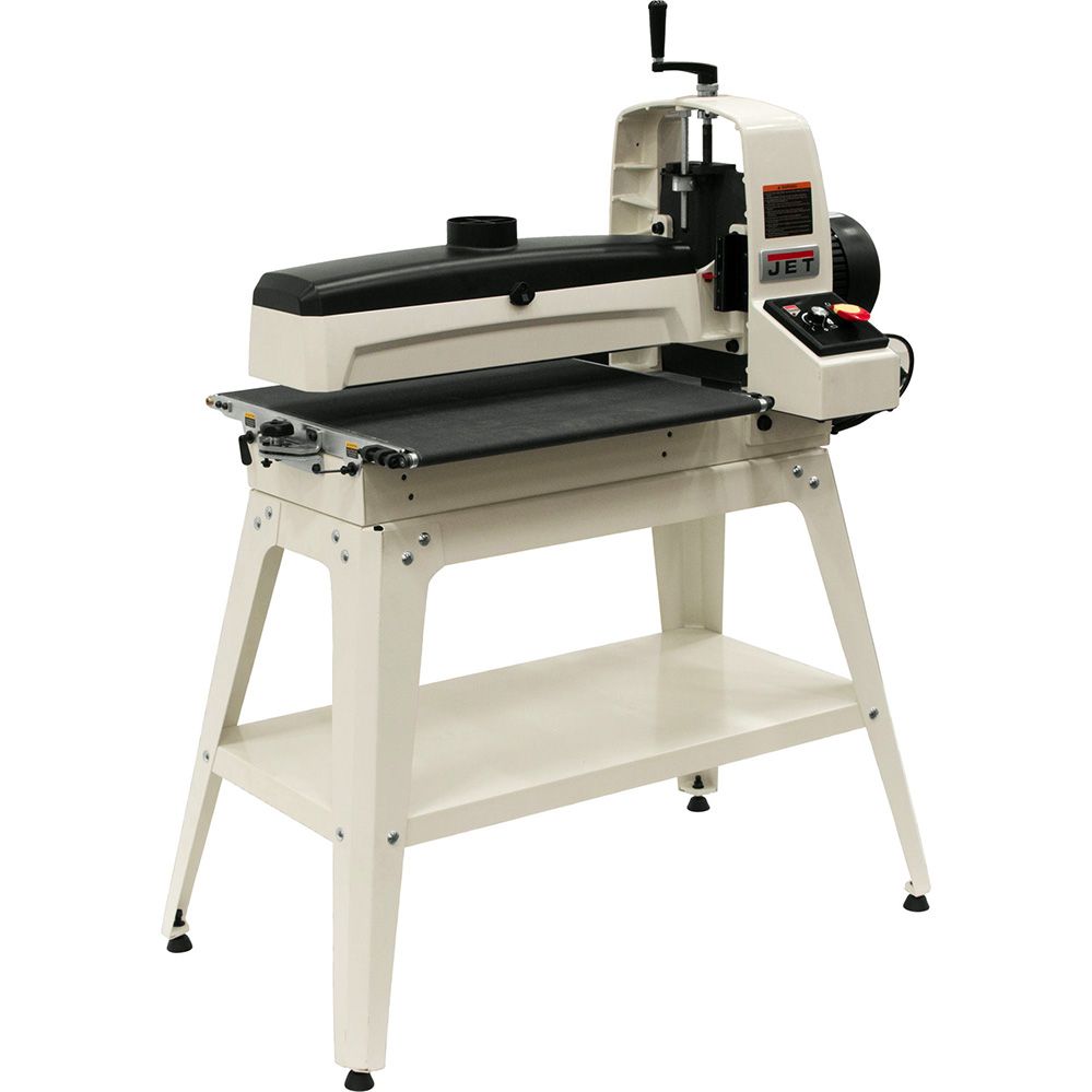

If you really want to get "heavy duty" in your model building, you could go this way, but it's spendy
https://www.rockler.com/jet-2244-22-...ith-open-stand
Attachment 2268020

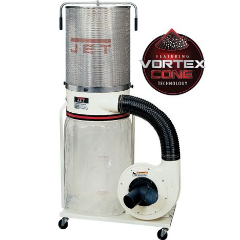

What makes this thing even more expensive is that you need a dust collector that can handle 550 CFM through a 4' hose, kind of like this one
https://www.rockler.com/jet-vortex-d...r-dc-1100vx-ck
Attachment 2268021
