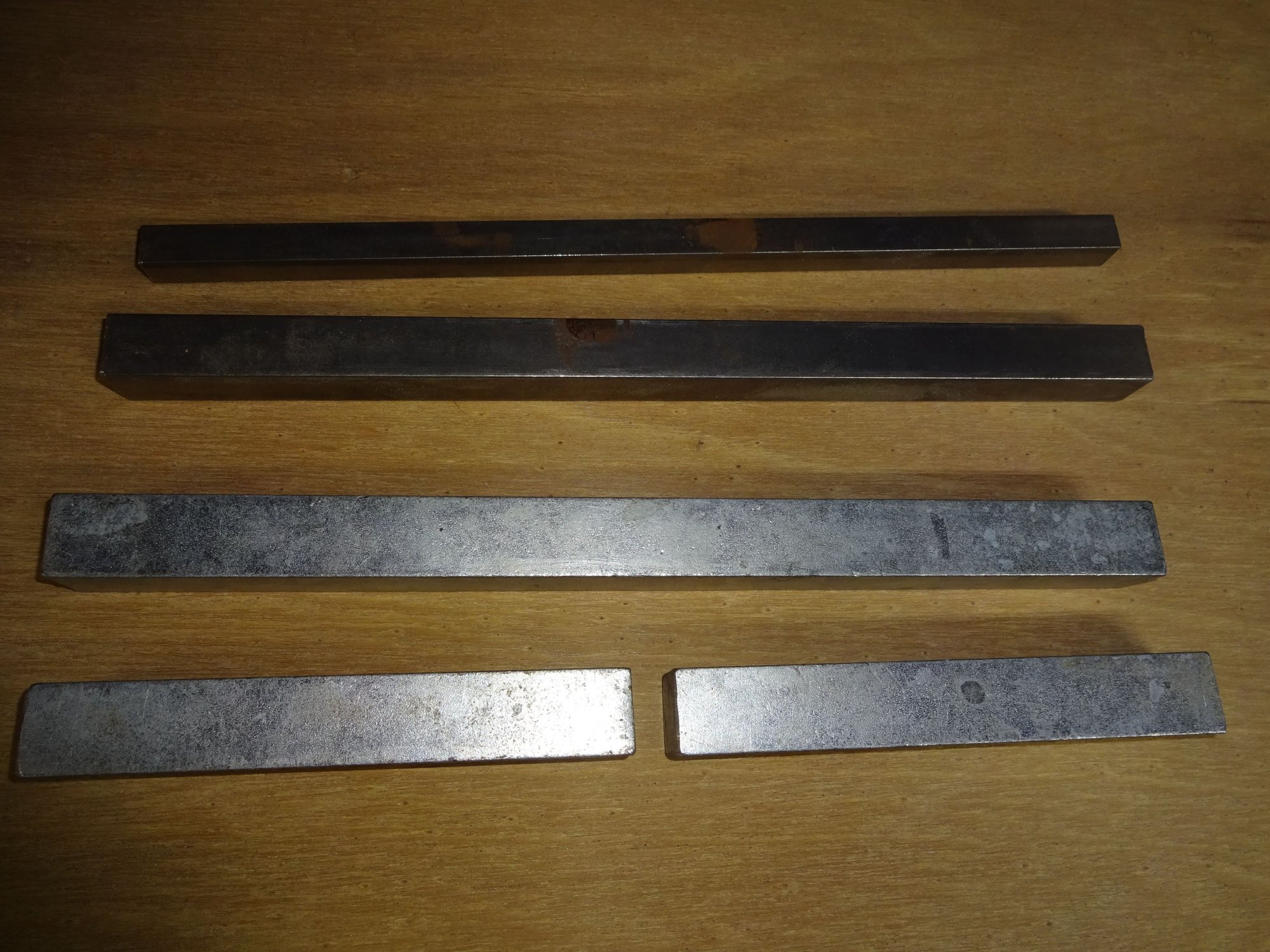

Bar stock. Used in similar ways as 123 blocks, but I use them mainly for straight weights when gluing things. You also get known sizes, like 1/2", 3/4", 1", etc.

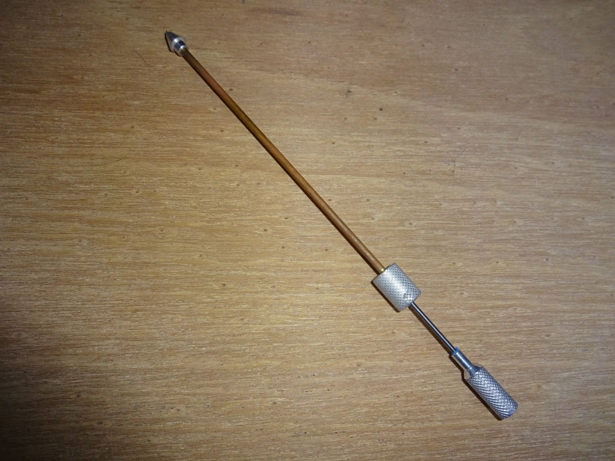

Great Planes drill (the exact name escapes me). Extremely handy for marking engine mount holes, or getting into tight places inside a model. I have had this particular one for probably 20 years.

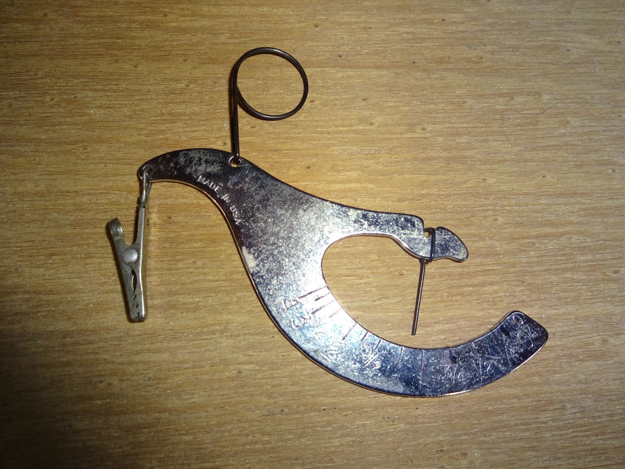

Small scale. Not used often, but comes in handy when you are trying to shave grams on small parts. Grams add up to ounces, and ounces matter.

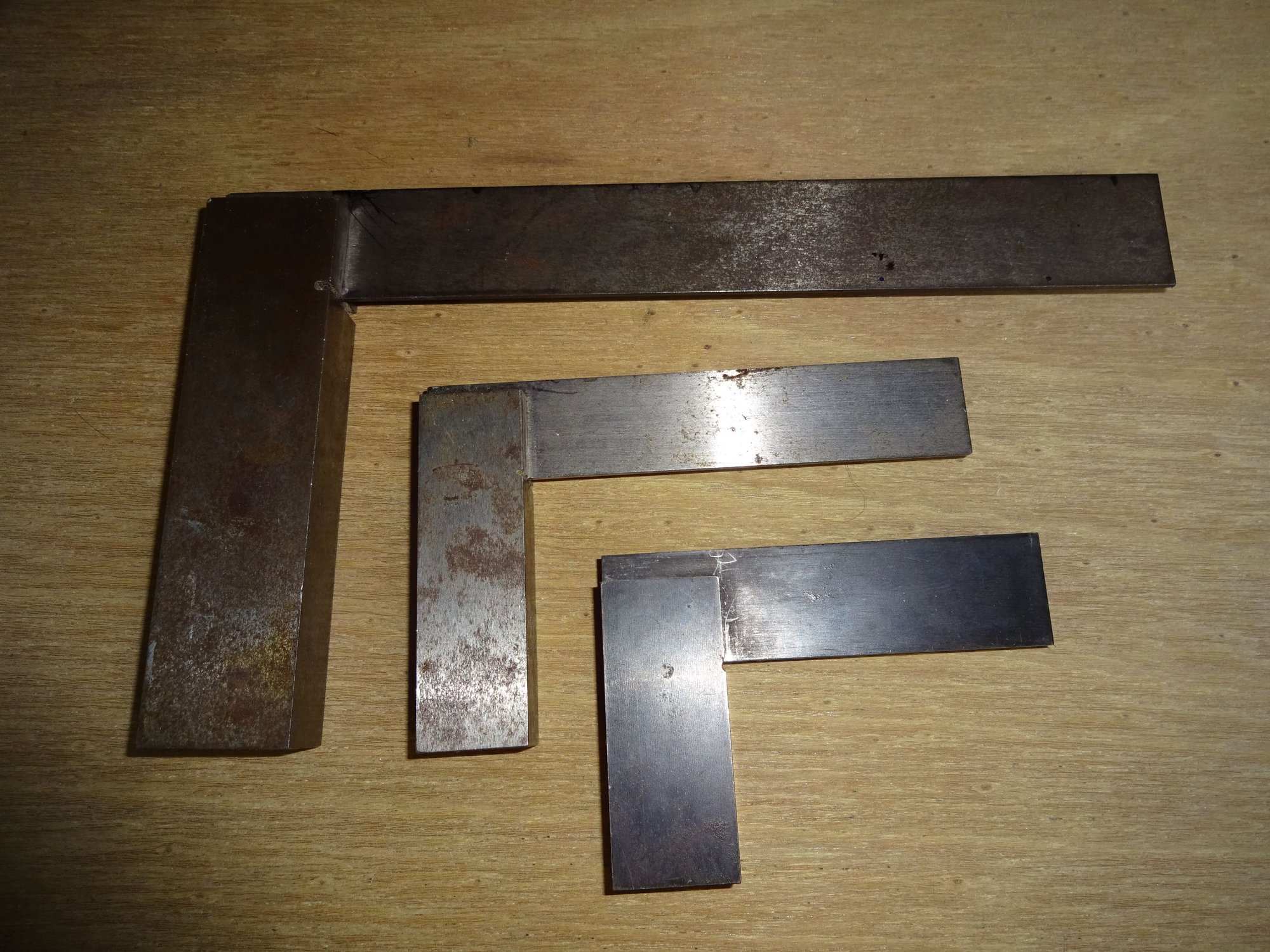

Engineer squares. No explanation needed.
45" "square". No explanation needed.

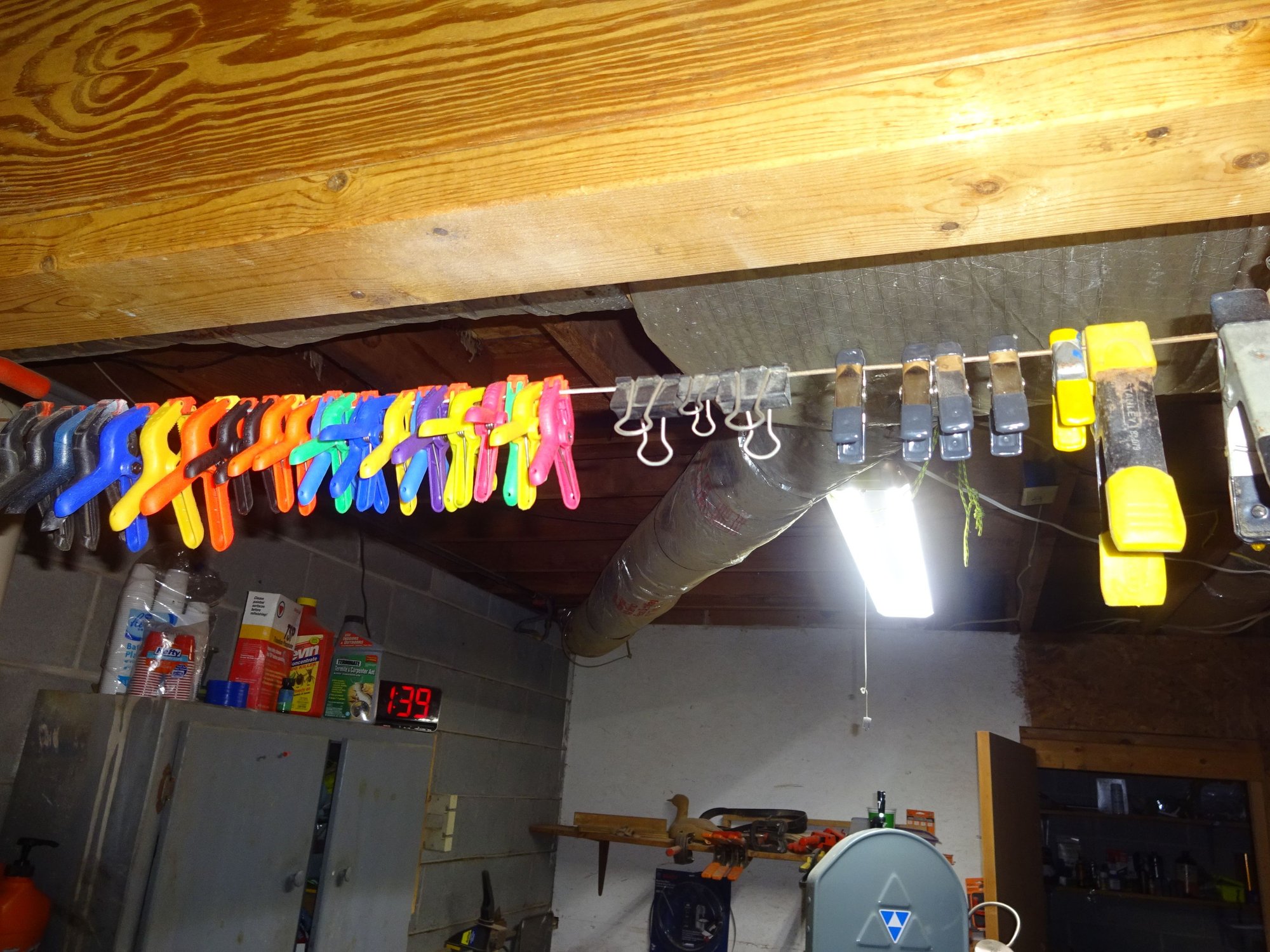

My selection of clamps, hanging from a beam in my shop. You can never have too many clamps.

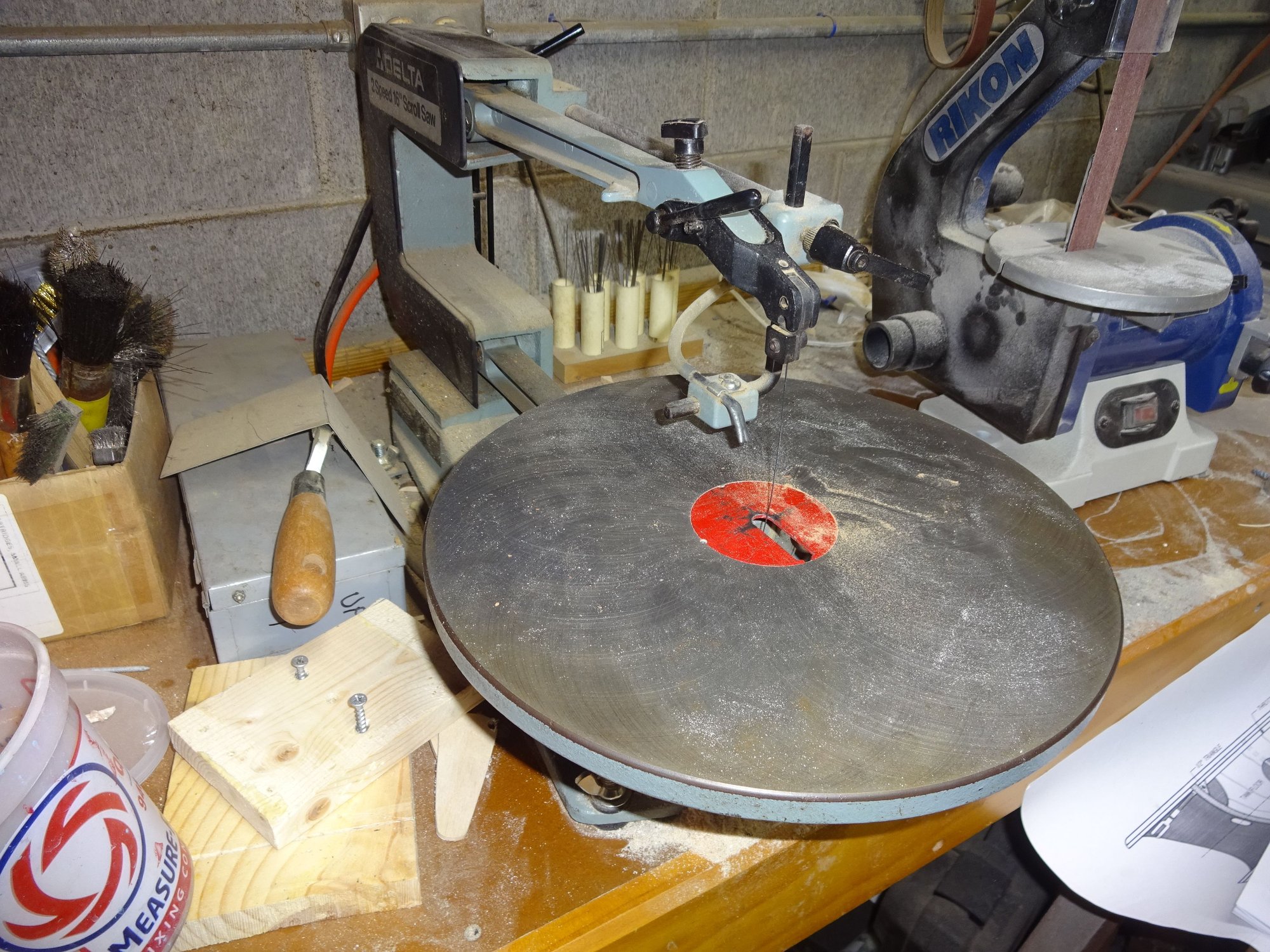

I use my 30 year old scrollsaw very often in building models. You can also cut thin metal with one, as well as drill a small starter hole, then cut out an opening inside a part. Draw a straight line, follow it carefully, and you can have surprisingly smooth and straight cuts.

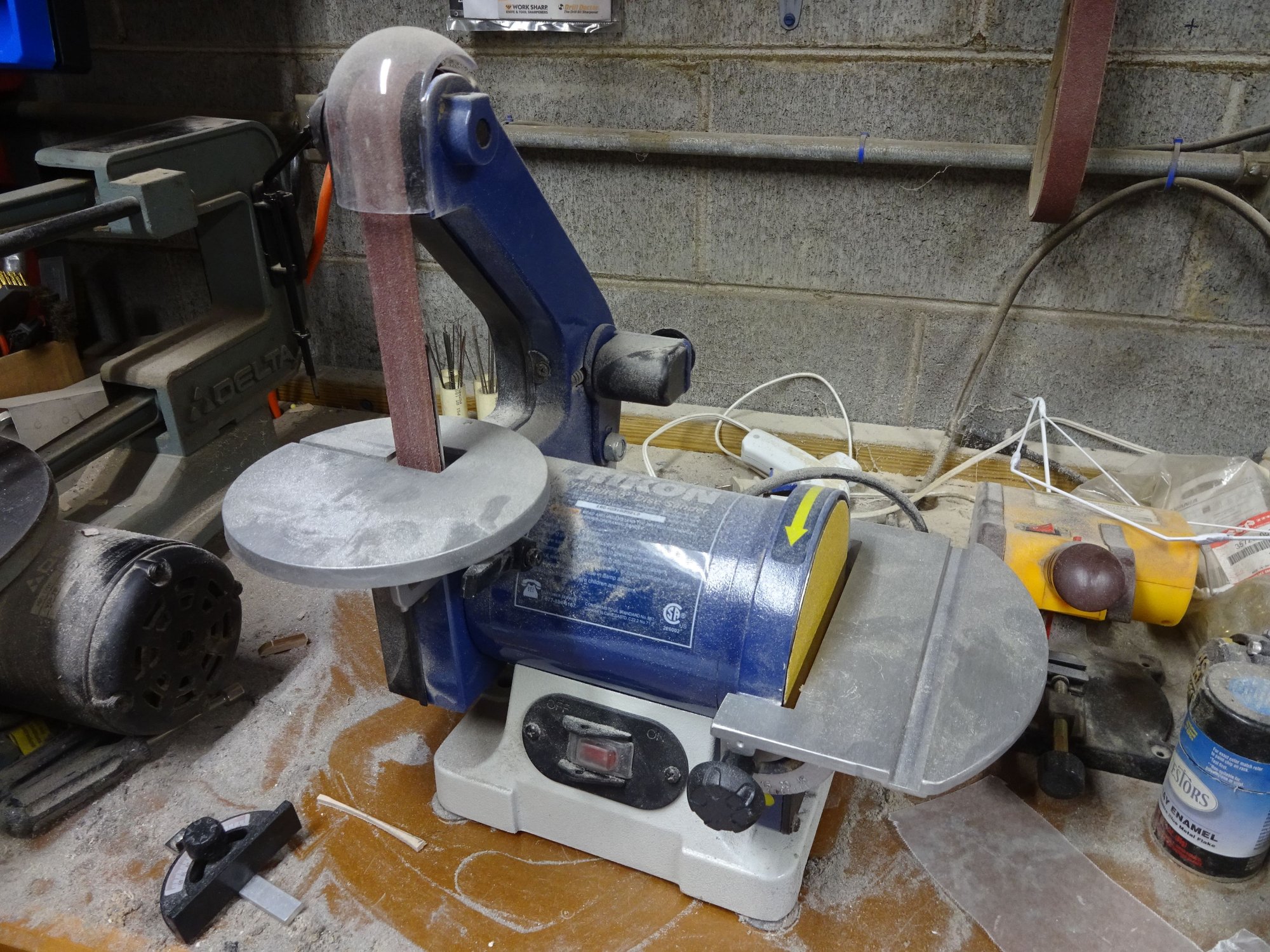

I use my small disk/belt sander very often in building models.

1) I've found this sander to be my most used tool in my shop. It's great for sanding out lightening holes and is better when sanding long straight areas than a vertical belt or disc sander.

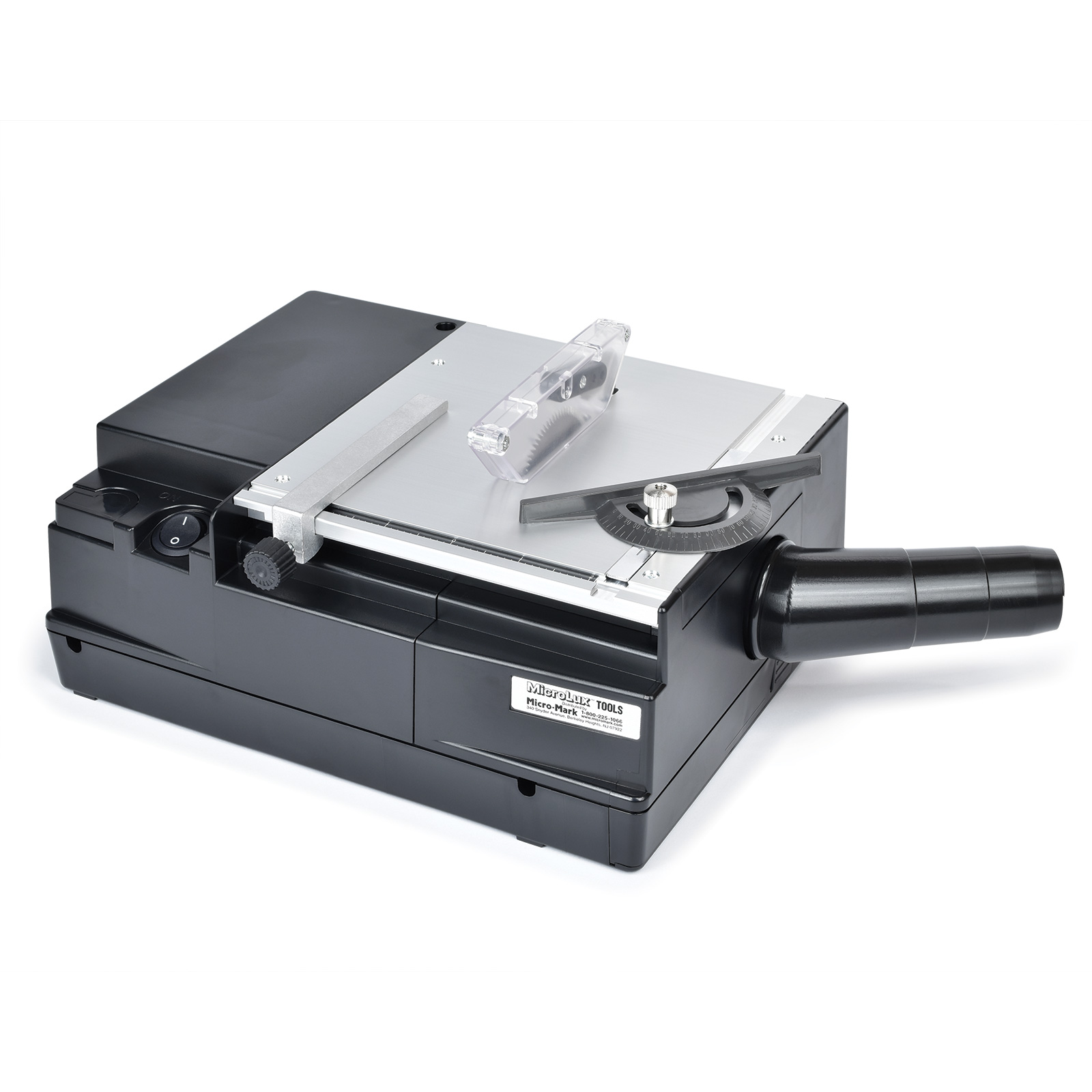

2) I've found this little gem to be great for stripping wood for stringers and gusset blocks, more so than my scroll, band or 10" table saws
https://www.micromark.com/MicroLux-M...op-Hobby-Use_2

^^ Thanks for that post. I've always wanted a tiny tablesaw. My ancient 10" Delta gets used often for other things, but extremely rarely for models. A 3/32" blade kerf eats up way too much balsa.
I made a sander kind of similar to that Ridgid, but it only has a spindle, and not a belt.

I bought the table saw for one main reason, cutting strip stock down to the widths I need. To save from wasting a bunch of wood, I also bought a.025 kerf blade, 230 tooth IIRC. I had ordered a bunch of strip and triangle stock from Aircraft Spruce but had to get stock larger than I really wanted or needed, hence the table saw.

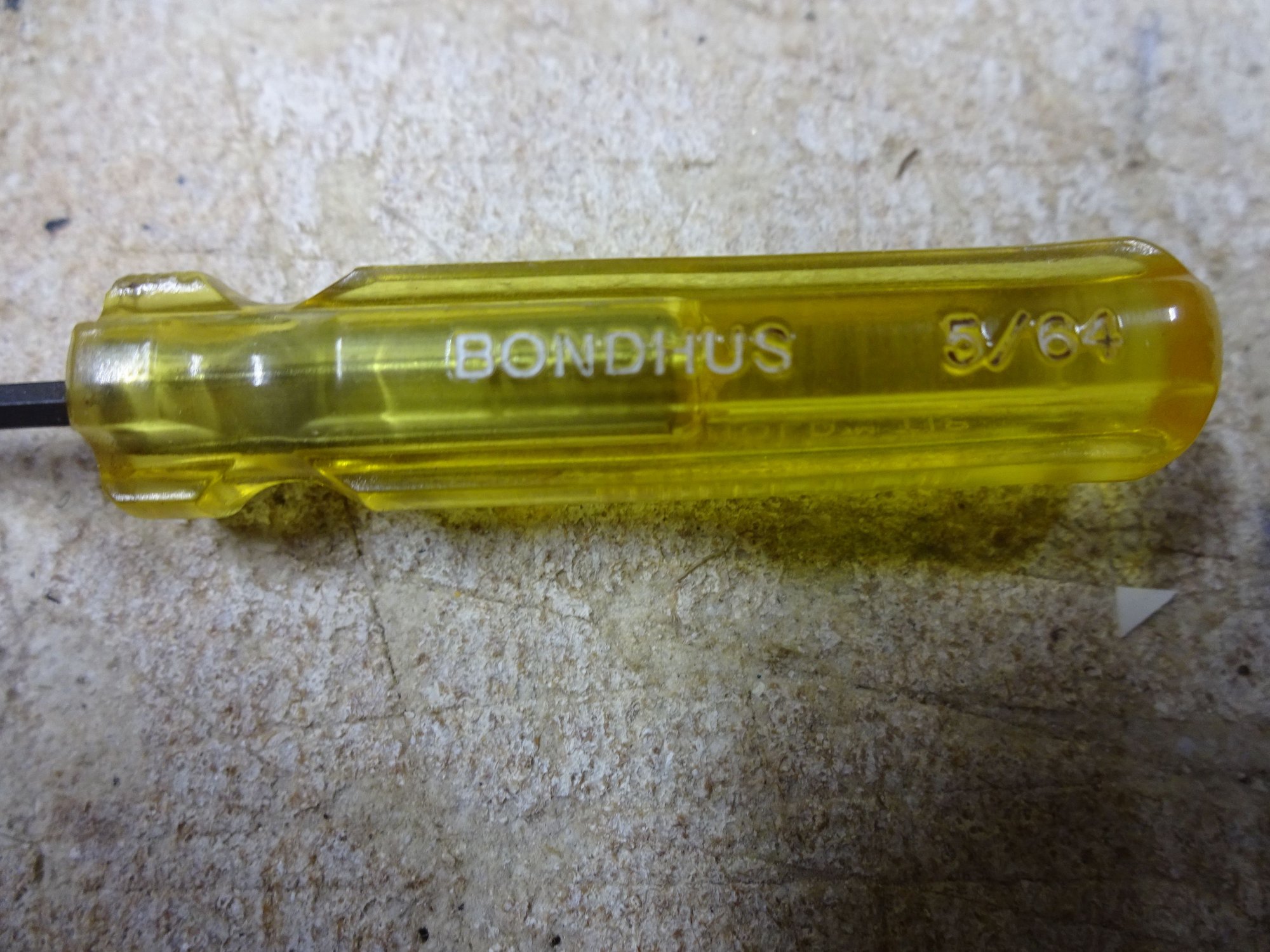

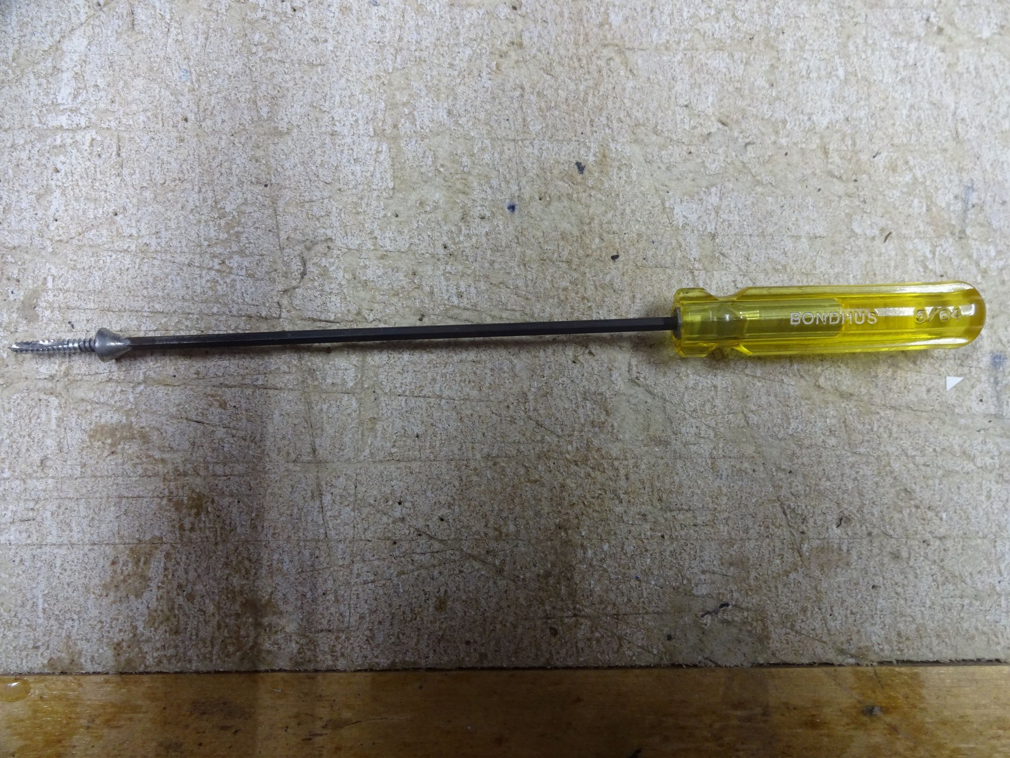

I wanted to add this tool, which I use every single time I install new servos. I always us "servo screws", which are SHCS's with a "washer" built into the head. Normally I drill a 1/16" or 5/64" hole, tap the hole with this tool, then drip a little thin CA into the hole, to solidify things, especially for the cases when the screw cracks the wood around the hole a little, which is common.

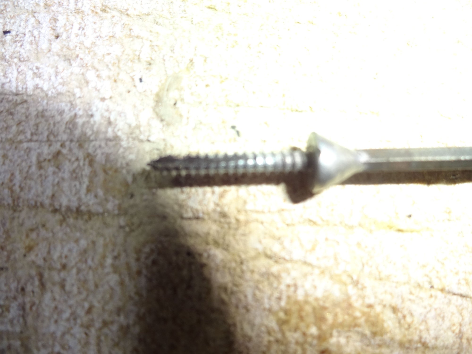

I soldered one of those servo screws onto a ball driver, then gut a shallow groove along the threads with a Dremel cutoff wheel (difficult to see in my blurry close-up picture). I had used this for many years without that groove, but after splitting more wood during my last build, decided that I needed to actually kind of tap the threads, instead of just pressing them into the wood, like a bare screw does. I use this technique in my workshop to chase damaged screw or bolt hole threads. Sometimes that works better than running a tap through the hole, plus sometimes I don't happen to have the exact tap that I need. Cut a groove along the threads, and that lets chips and material removed come out, plus the edges of the groove do some cutting in the material. That's a mechanic / machinist trick.
This tool is easier and faster that just threading in / out a loose screw that you may drop down inside your plane.

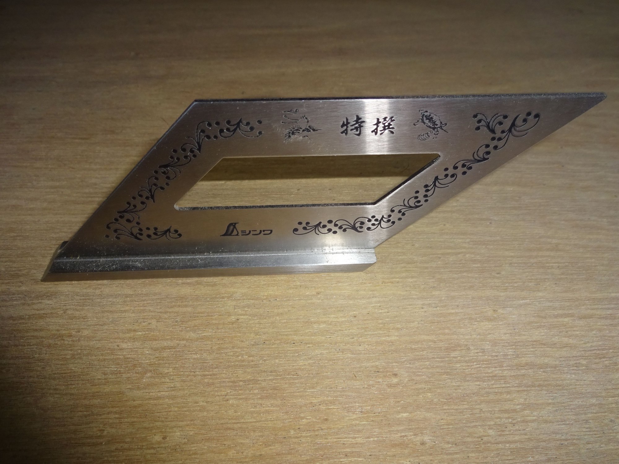

A year or so ago I bought a digital protractor for doing cabinet trim work and baseboard miter cuts. Then when I started my latest short kit build I found that the protractor was a great tool to accurately measuring both stick and sheet pieces from the plans. Once measured, I just set up my miter saw and made very accurate and square angle cuts. This was particularly useful if you have similar angles on multiple pieces. I found that the parts fit perfectly, making tight gluing joints. The results were that I had an accurate and strong framework with no need to have the glue gap filling under the wood joints.
But wait, there’s more.....I also used it for finding where to position my engine mounting. I knew the angle of right thrust I needed and was able to accurately position the offset mounting hole pattern
required on the firewall.
It was good value too, about $12 on Amazon.
