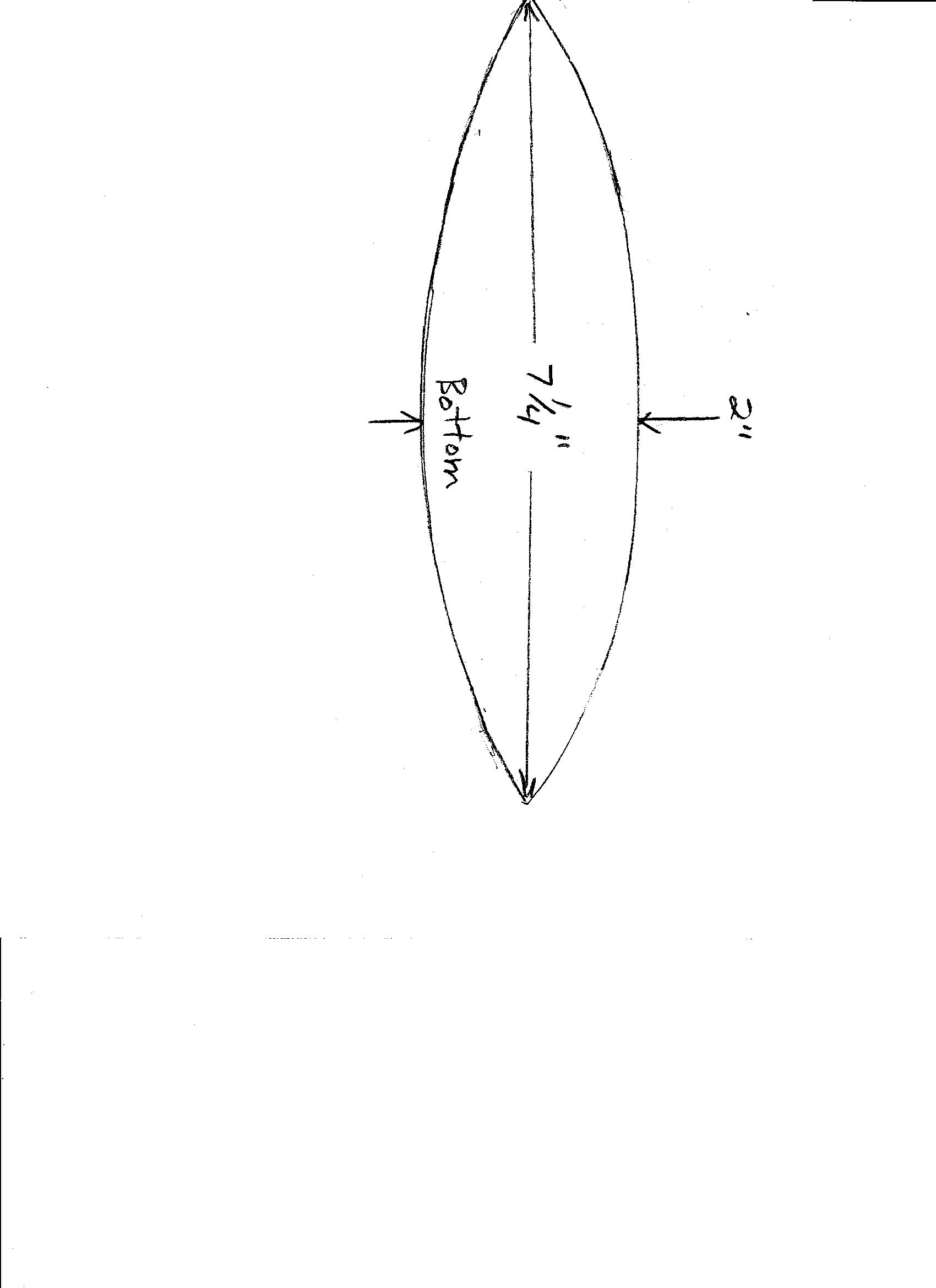

1 Attachment(s)
I managed to copy the windshield today. My Smith has been setting in my basement for the the last 25 years and when I went to copy the windshield it was very brittle. I took it off from the plane and laid it on a piece of paper and traced it out. Time to recover mine and get it into the air after all of this time.http://www.rcuniverse.com/forum/atta...mentid=1985629
