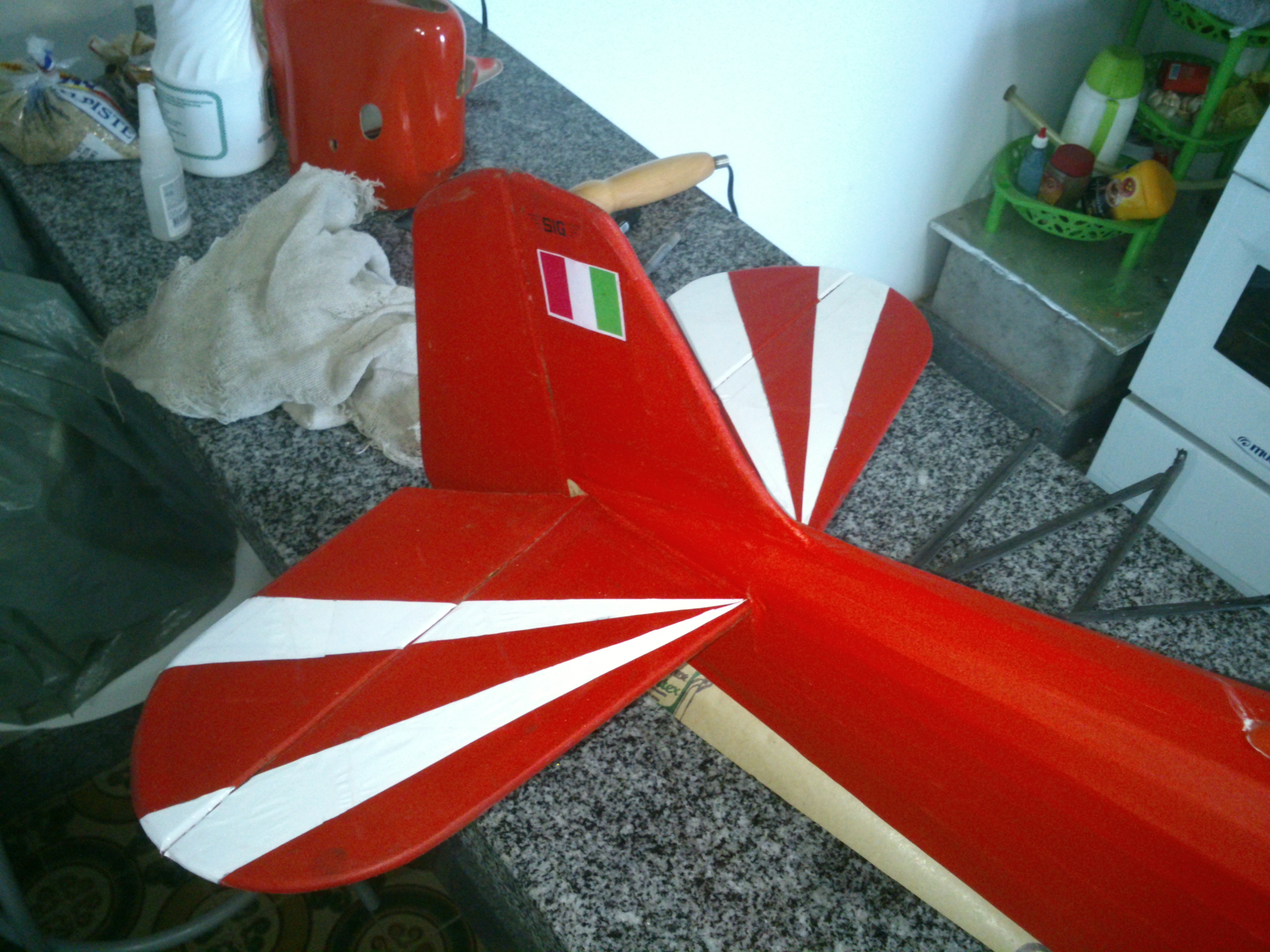

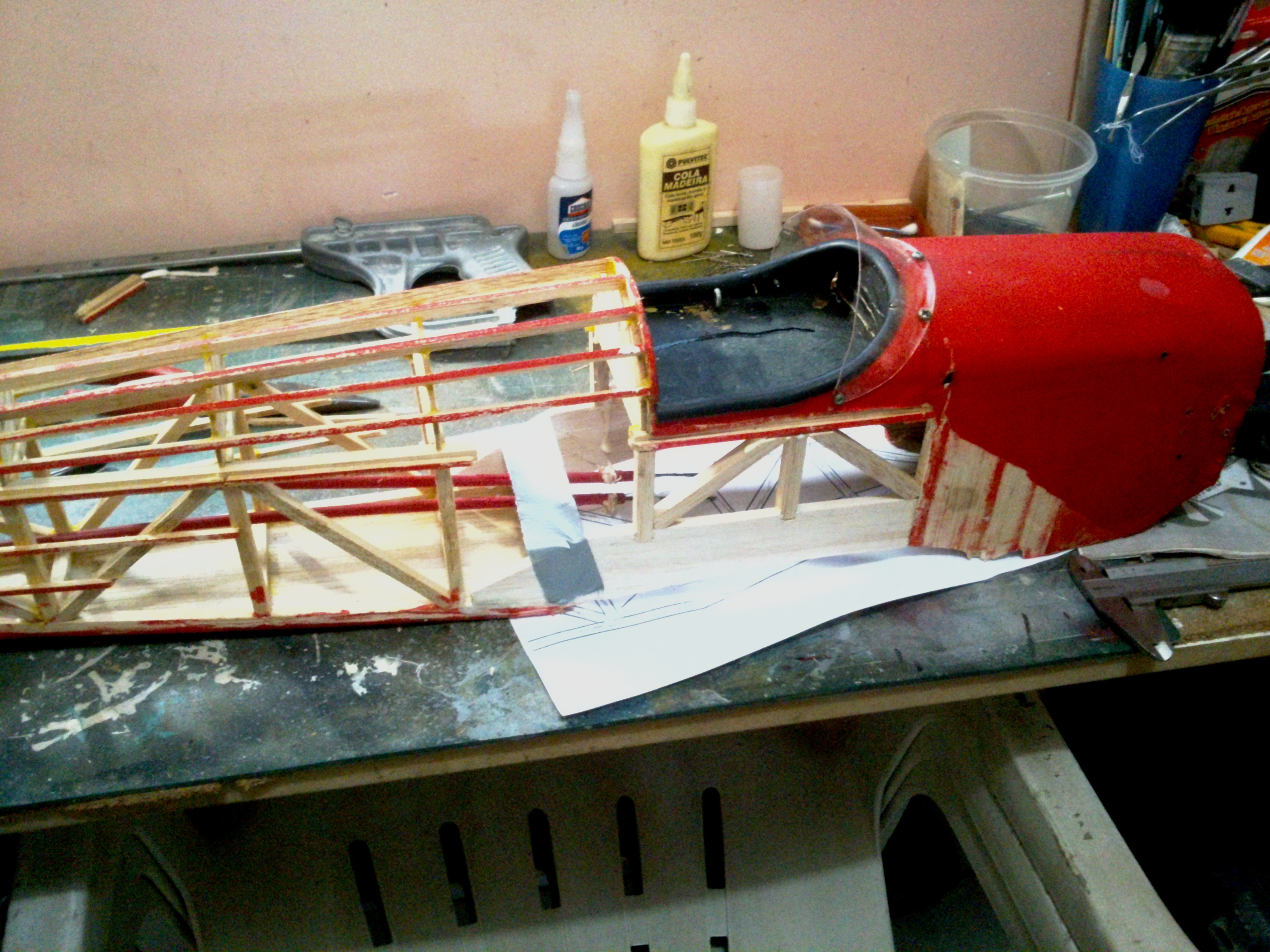

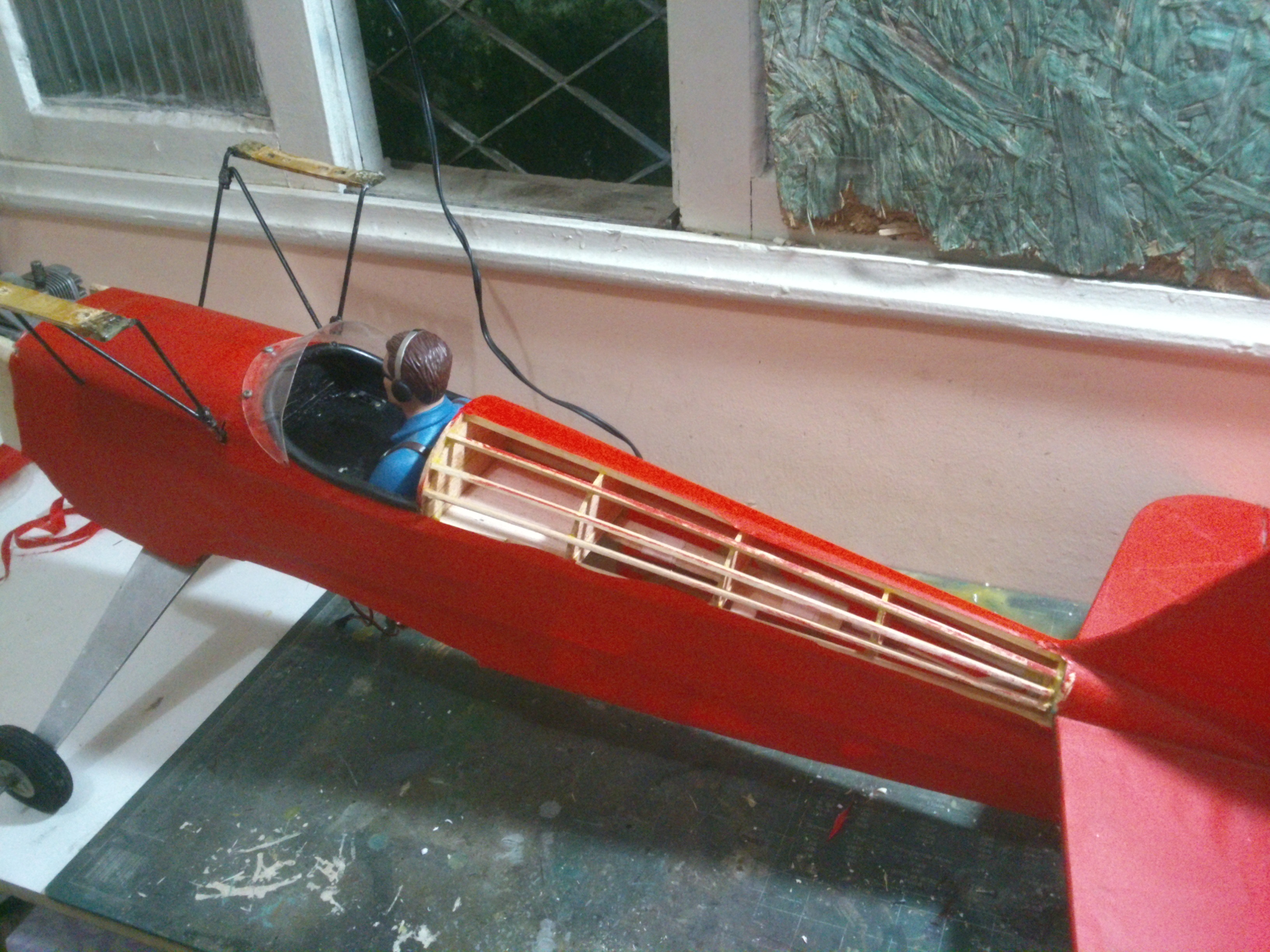

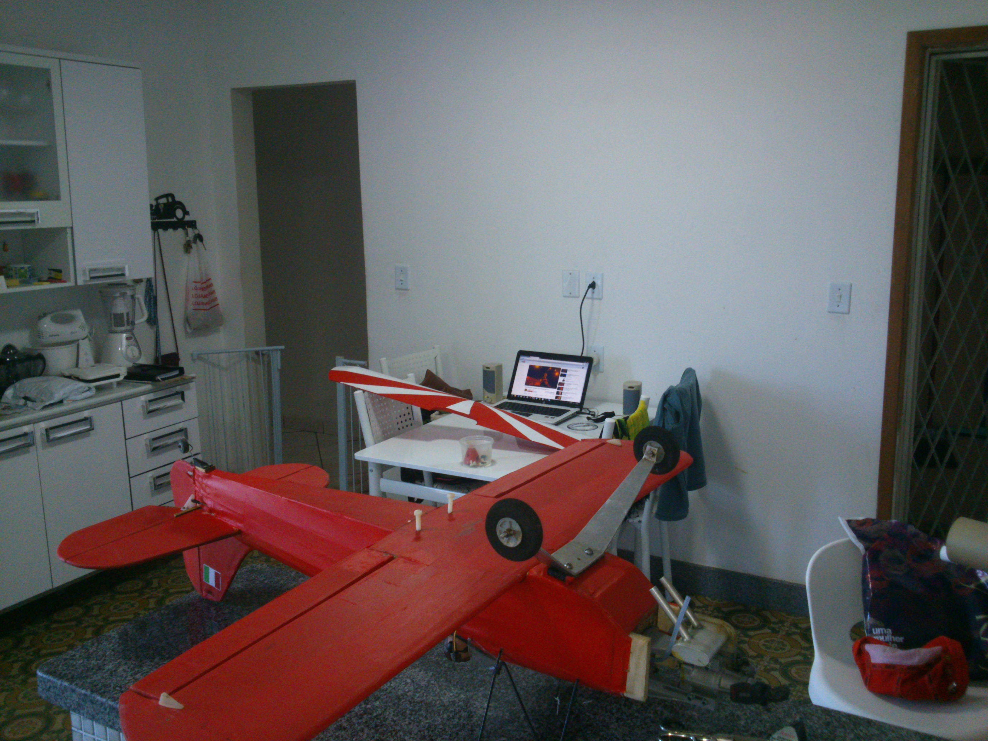

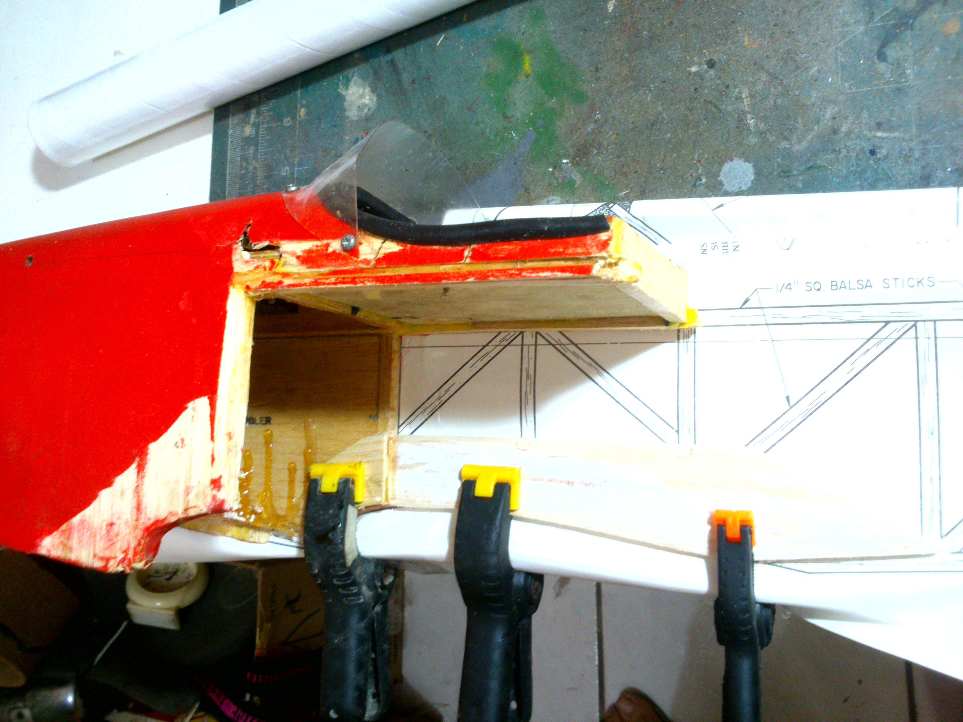

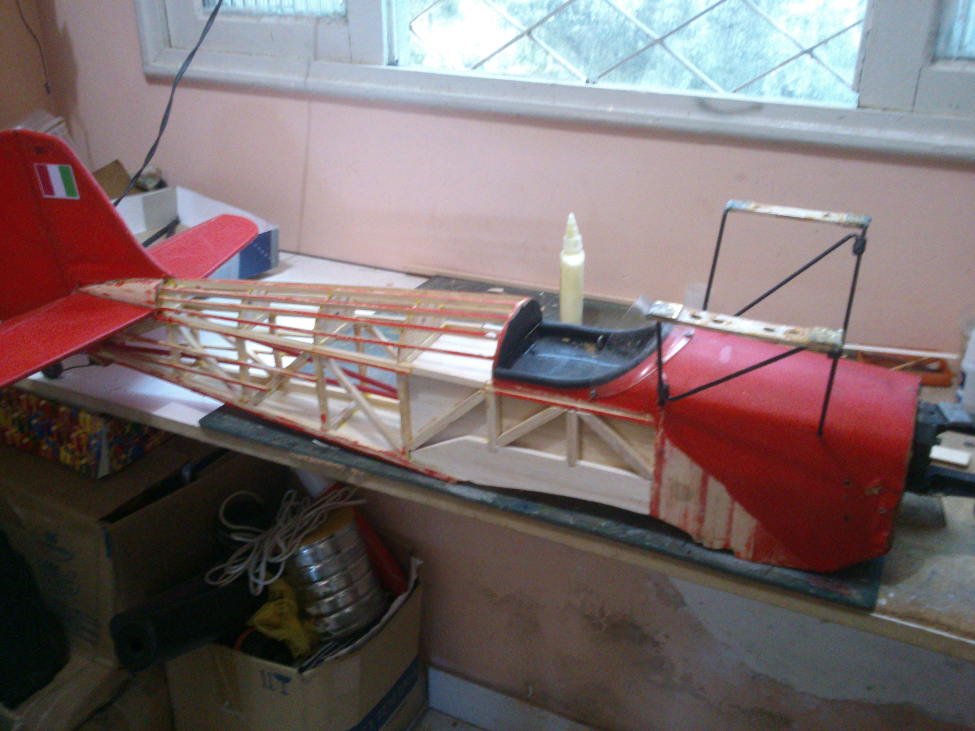

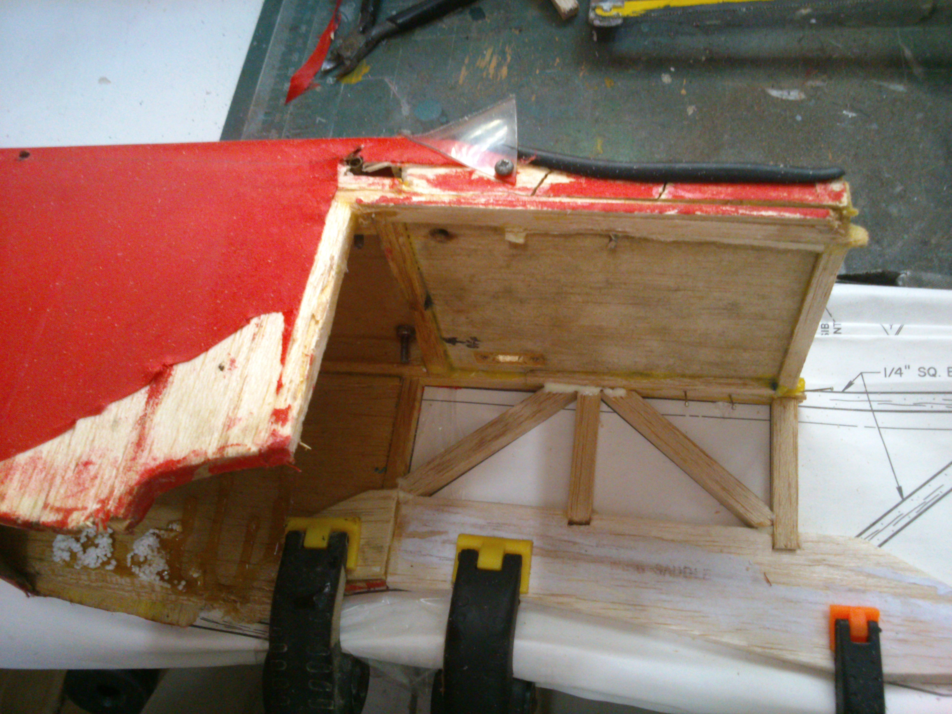

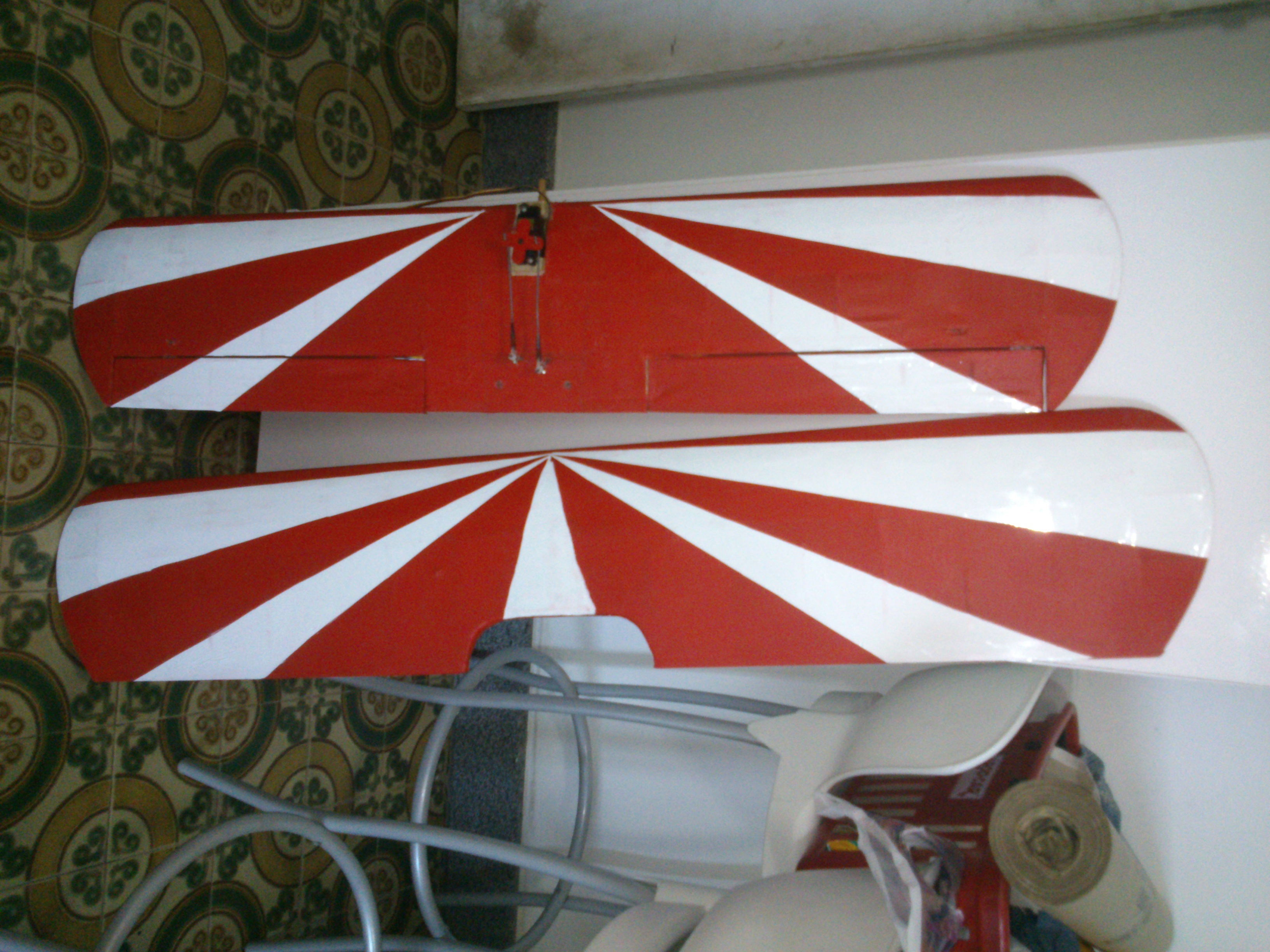

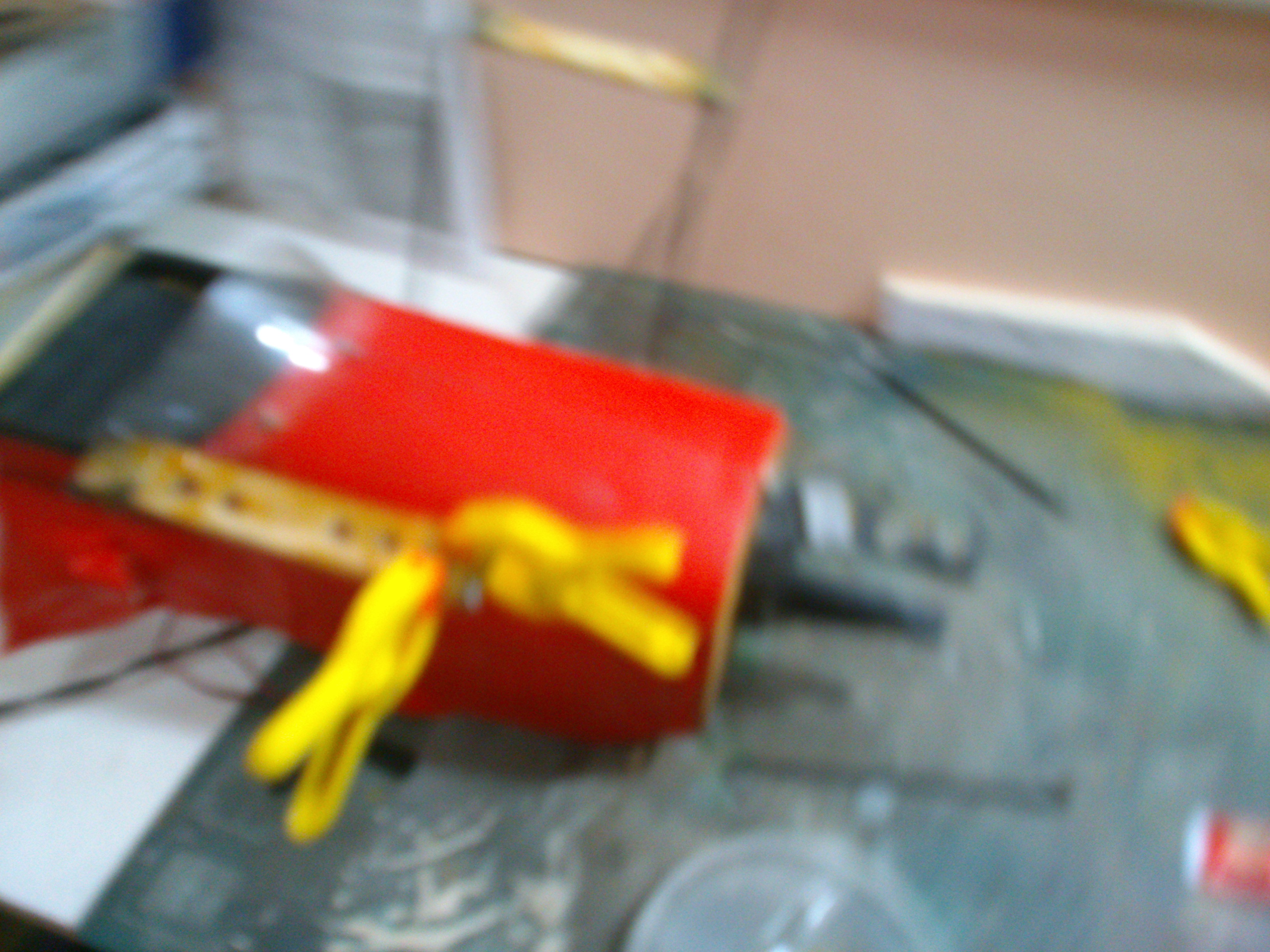

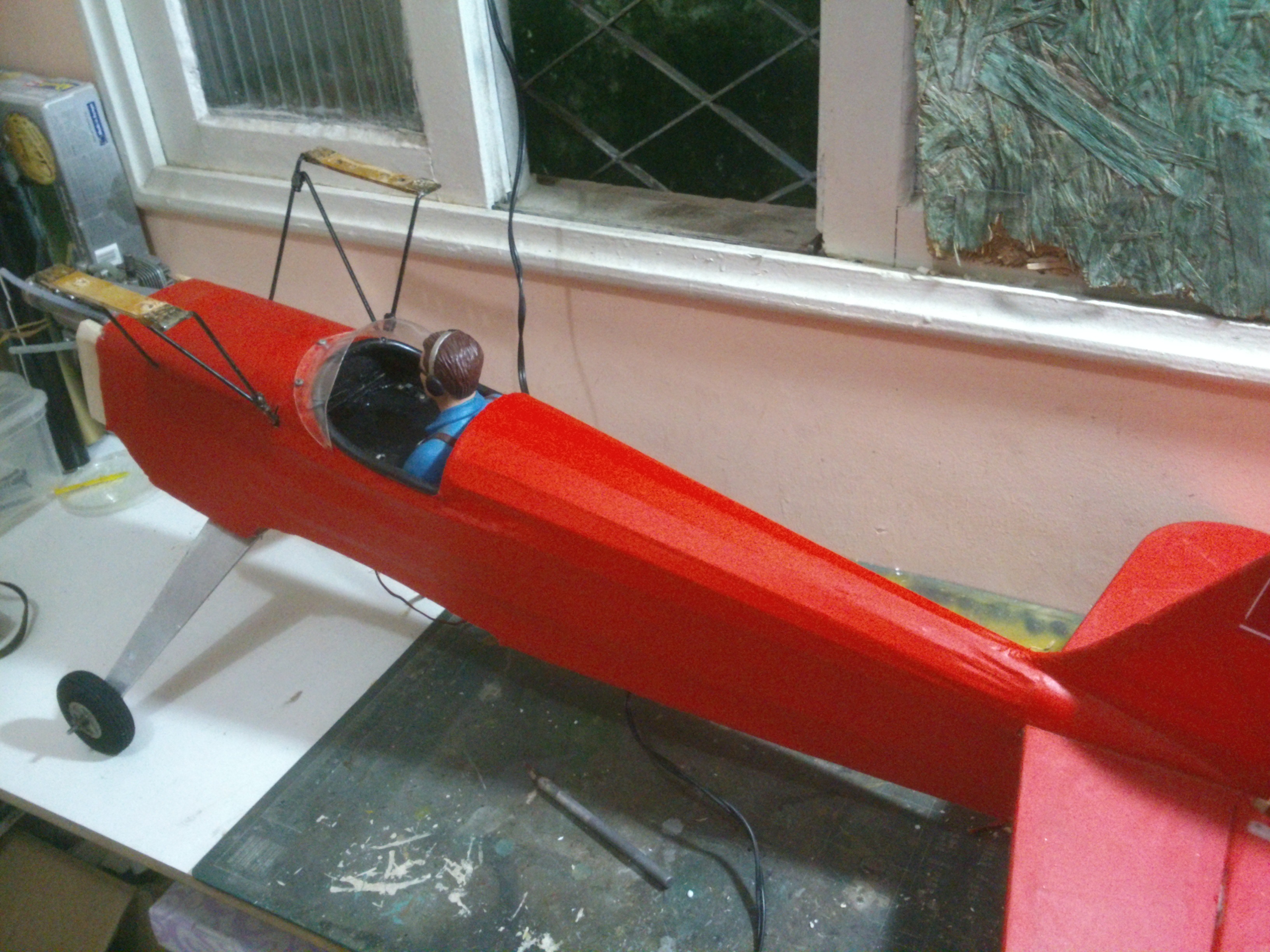

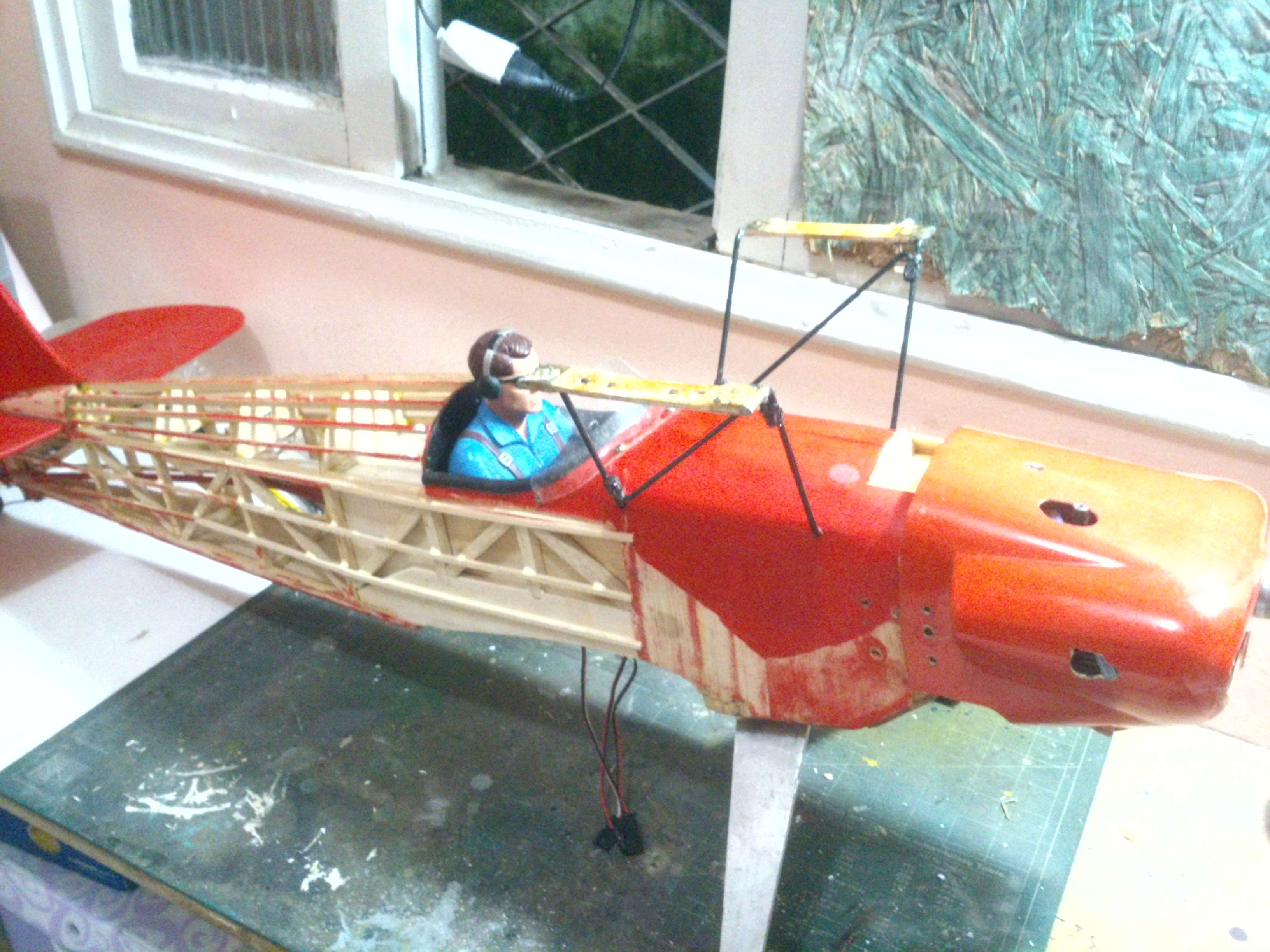

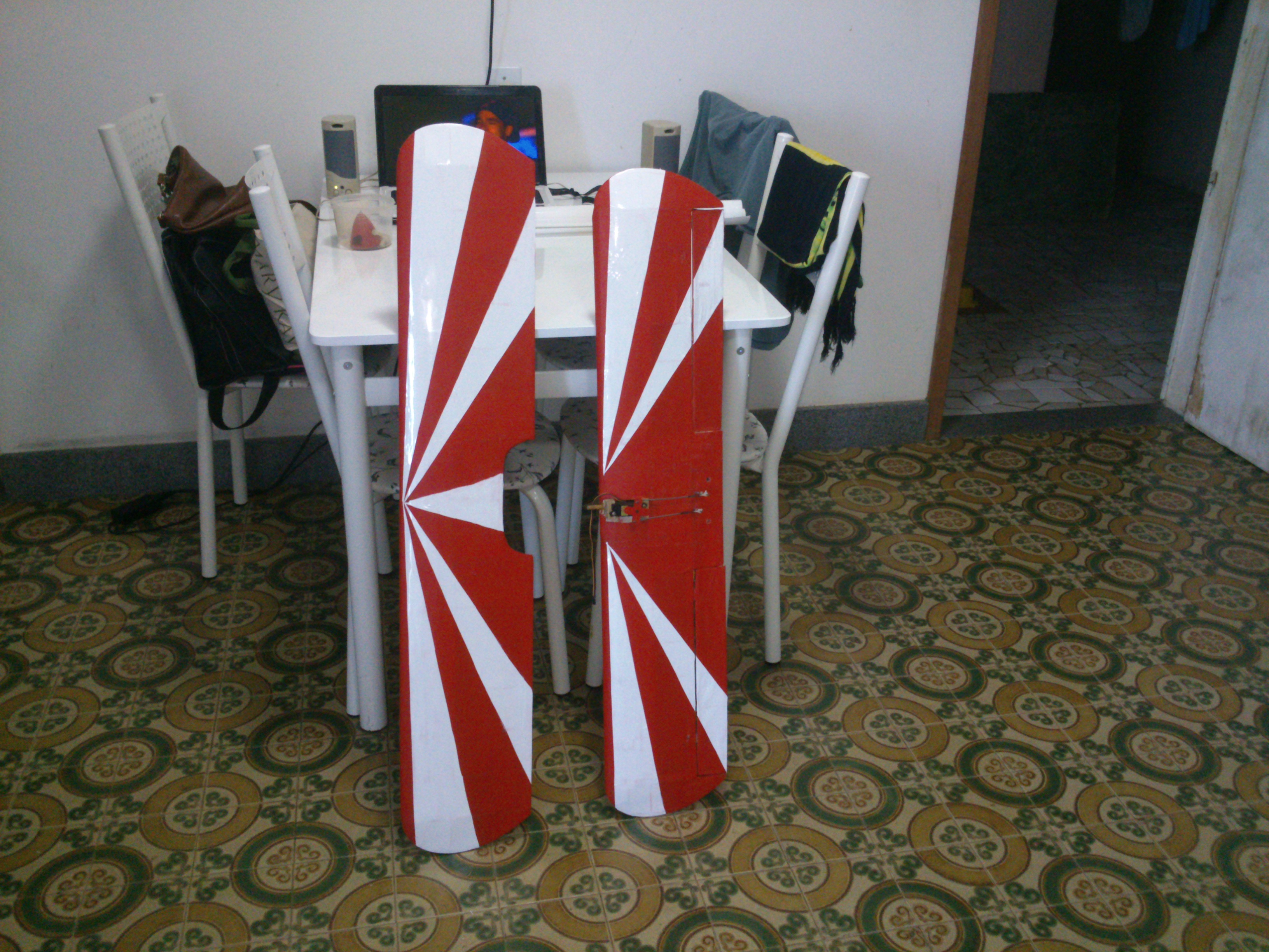

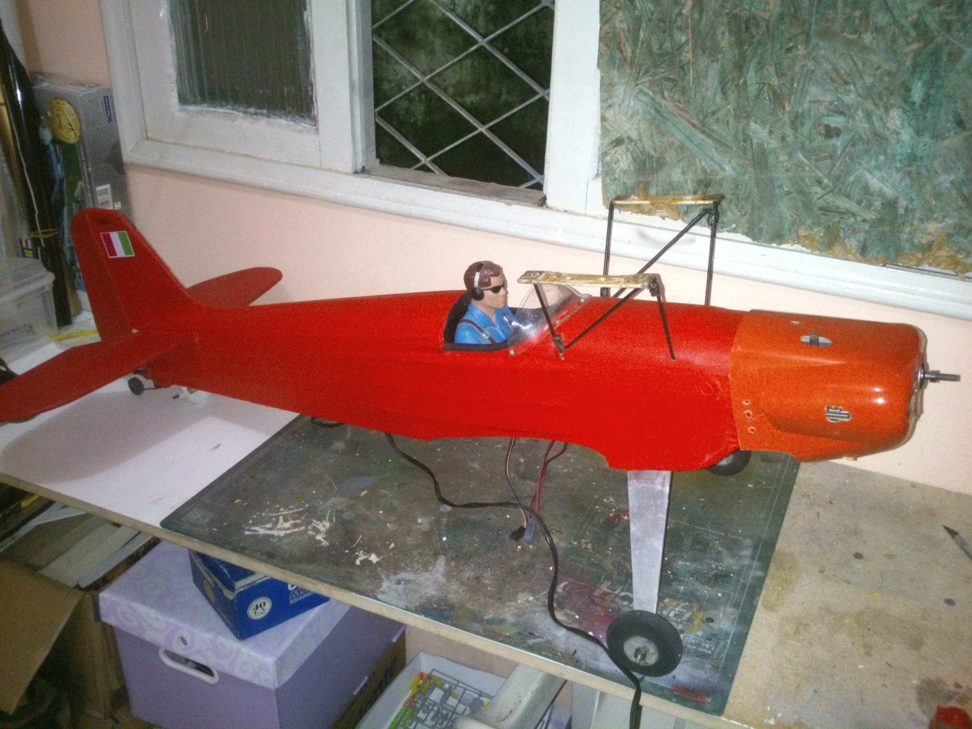

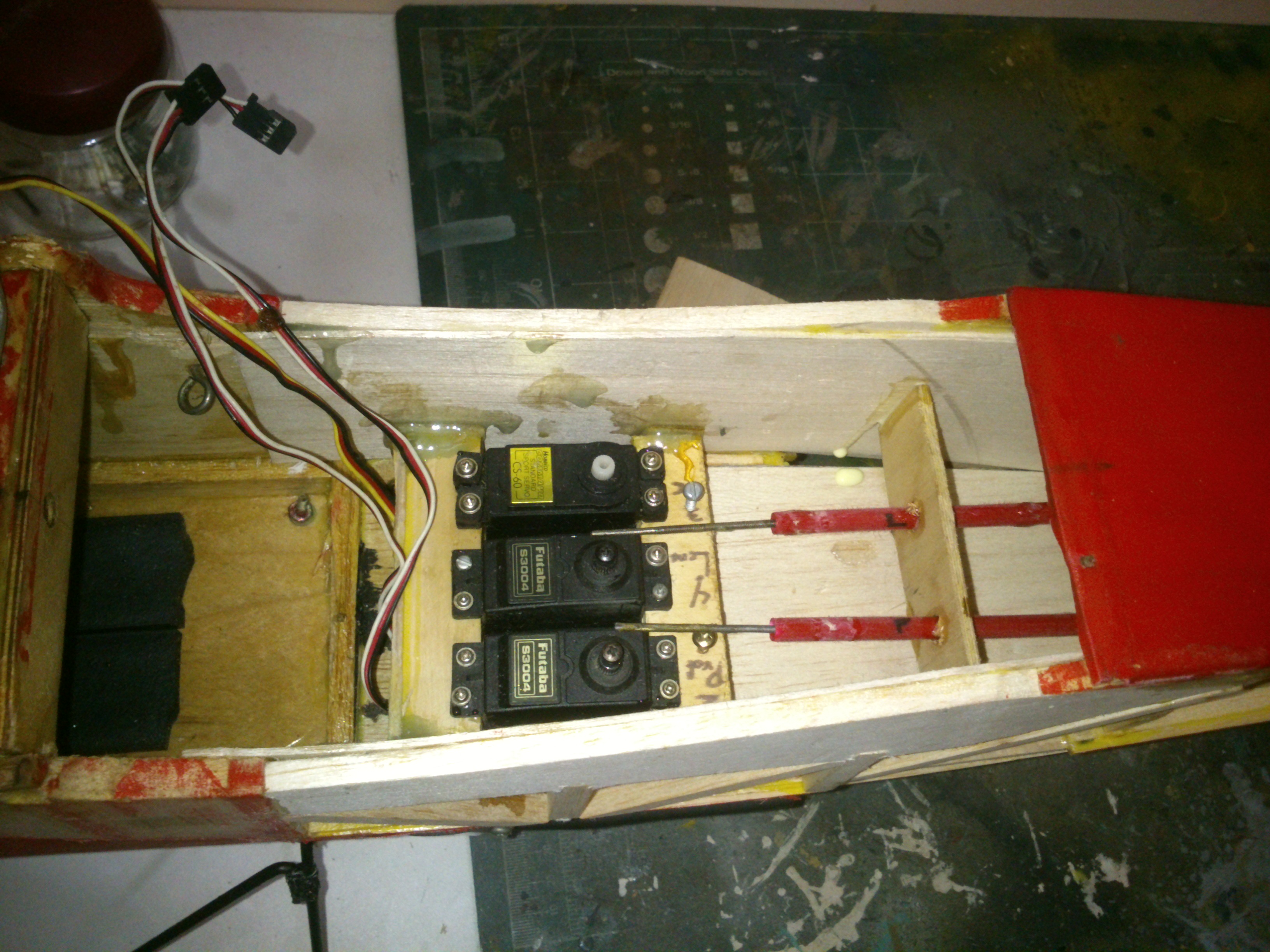

Tiffoso 11-27-2014 07:57 AM
8 Attachment(s)
Oh, well. Rebuilt my beloved 'rosso', will fly soon.
Pics will tell the story...
http://www.rcuniverse.com/forum/atta...mentid=2050490http://www.rcuniverse.com/forum/atta...mentid=2050491http://www.rcuniverse.com/forum/atta...mentid=2050492http://www.rcuniverse.com/forum/atta...mentid=2050494http://www.rcuniverse.com/forum/atta...mentid=2050495http://www.rcuniverse.com/forum/atta...mentid=2050496http://www.rcuniverse.com/forum/atta...mentid=2050497http://www.rcuniverse.com/forum/atta...mentid=2050498
Tiffoso 11-27-2014 08:00 AM
7 Attachment(s)
And a few more to tell the hole story...Not a problem this rebuild.
Seems like it was meant to be easy to repair...http://www.rcuniverse.com/forum/atta...mentid=2050499http://www.rcuniverse.com/forum/atta...mentid=2050500http://www.rcuniverse.com/forum/atta...mentid=2050501http://www.rcuniverse.com/forum/atta...mentid=2050502http://www.rcuniverse.com/forum/atta...mentid=2050503http://www.rcuniverse.com/forum/atta...mentid=2050504http://www.rcuniverse.com/forum/atta...mentid=2050505
TCraft Lover 12-14-2014 02:30 PM
Hi Tiff!
Sorry to see the crash damage on your SMP. The repairs look fantastic. What covering material are you using? I will be starting a build on my Sig 1/4 scale Cub shortly and I still have not decided what I'm going to use for covering.
Tiffoso 02-24-2015 11:46 AM
sorry I'm late!
Just saw your message, TCraft Lover, sorry.
My Smith was covered with Oratex.
It's a bit heavy but gives a real scale look, adds some structural strenght and it's aplication is absolutely straigthforward.
For your1/4 scale Cub I believe Oratex will be perfect and I believe they have in the right yelow color for it.
Best regards
Tiffoso

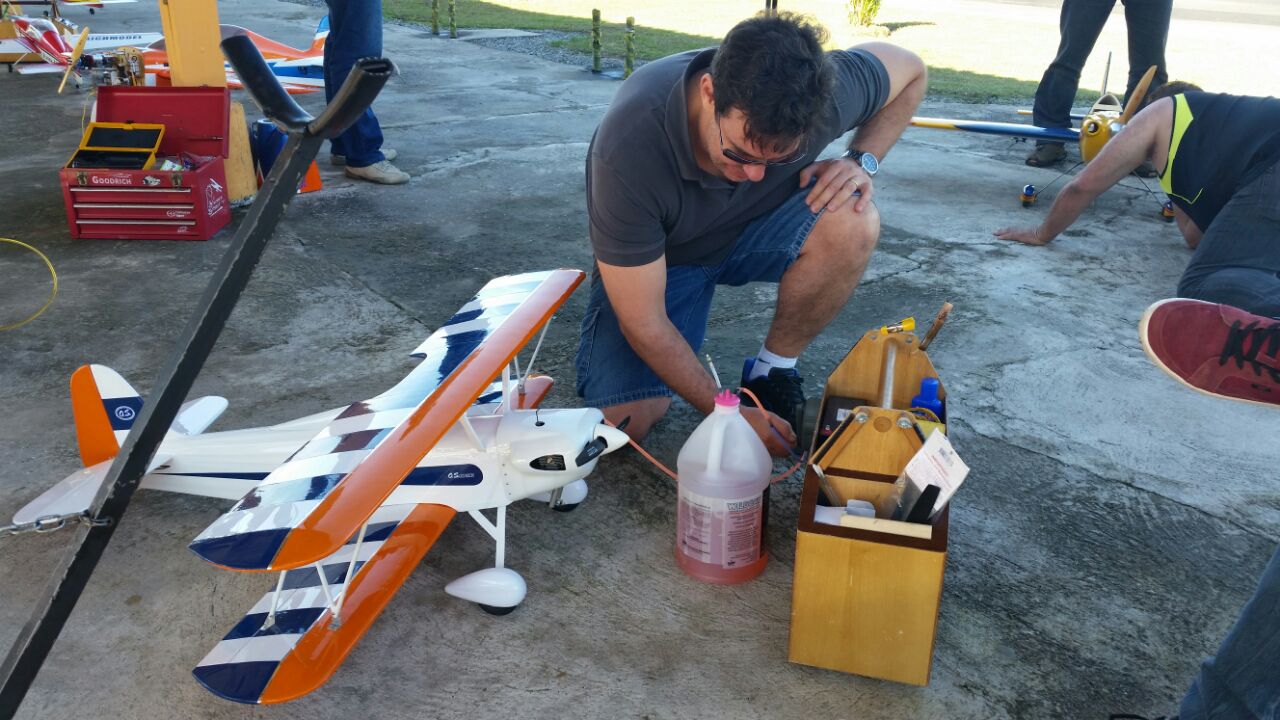

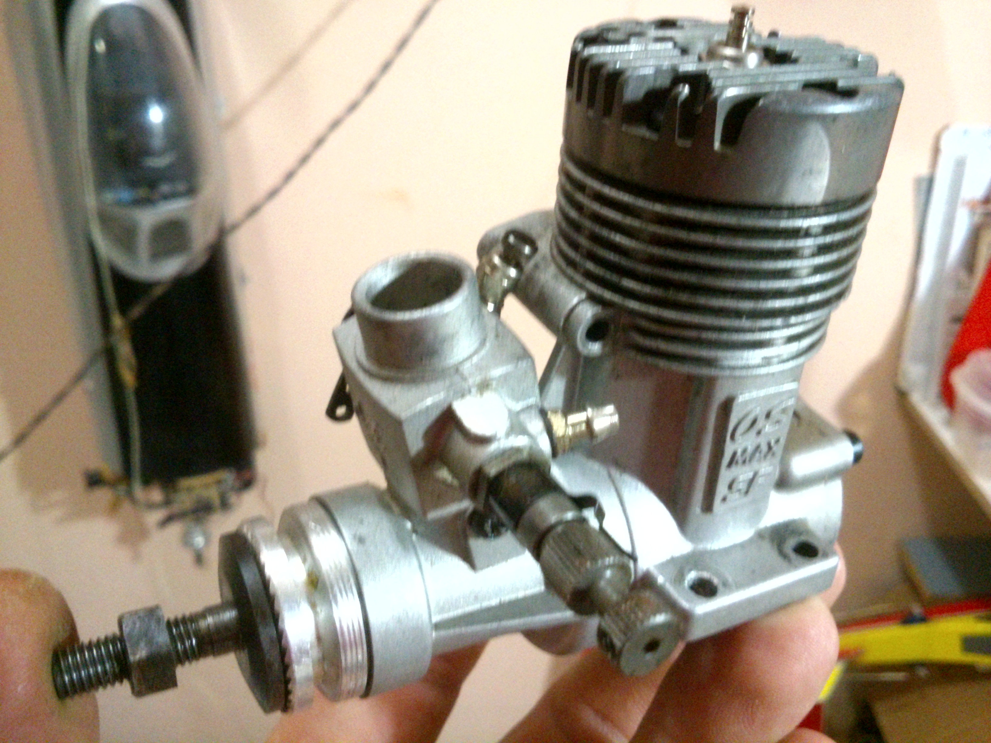

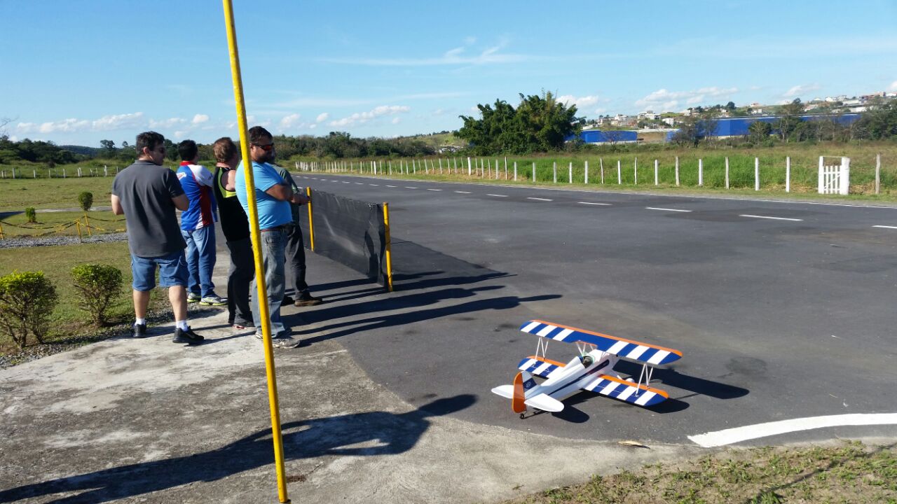

leojzamboni 06-11-2015 10:23 AM
2 Attachment(s)
I enjoyed very much reading this thread about one of my favorite planes. My Smith Miniplane had a re-maiden this weekend after 15 years. It was completely destroyed in 2000, and a friend of mine rebuilt it beautifully. Despite the terrible pilot, the biplane flew great. It is powered by an OS 46AX using 11x7 prop. The only problem is the tendency to climb whenever I add power. I think IŽll add a little down thrust.
Regards.
http://www.rcuniverse.com/forum/atta...mentid=2102012http://www.rcuniverse.com/forum/atta...mentid=2102013
