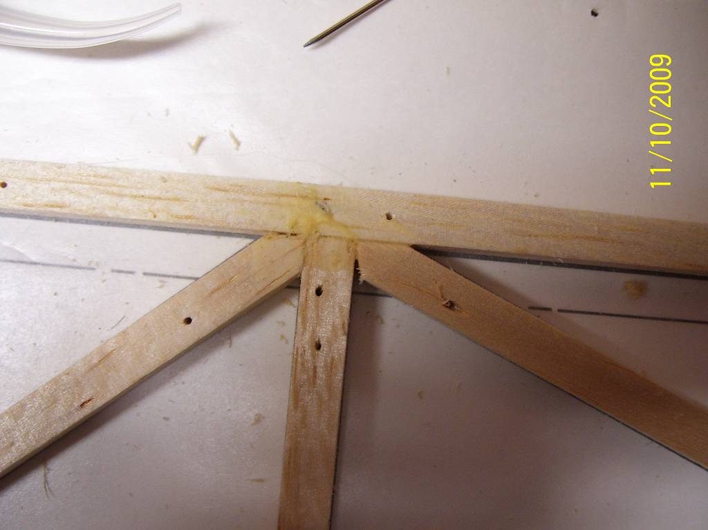

what I was really asking was how to get theangles on each end of the short braces that are in the fuse sides.

Can you take a picture for clarification? I don't think I know what you're asking.

My problem is that when I try to sand the joint angles by hand sometimes they don't fit so very good.I started the fuse assembly last nite and will probably get the second side done today. Hope the photo explains it better than my poor verbal efforts.
Dave</p>

Regarding the fuse joints:
This is where it is a builder's kit for sure. I would lay the 1/4 square stick on top of the plan, use a straight edge and mark the angle on the stick. Then I would either cut it with my exacto knife, or better yet if you have one, use a disk sander with the table at 90 degrees to ensure a perfect angle.

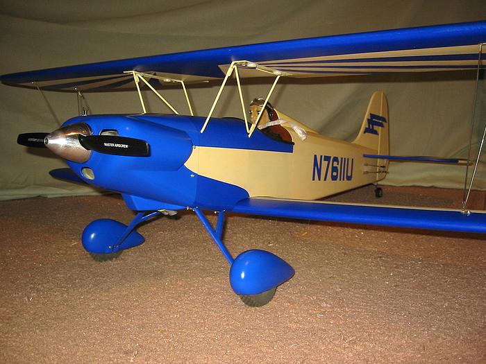

As usual, if you just stab that throttle stick to full, you will have a handful on takeoff, I never got that chance to do that here in CT. Our runways are almost all grass, and unless you get there the day they mow the grass, power management is a must. I did splay the gear a few degrees and set my tailwheel as far back as possible when building it. But I never noticed any bad ground handling issues due to feeding in power smoothly and letting it build ground speed before pulling back smoothly on the stick. It's a scale plane, why would you want to yank it into the sky like a 3D machine anyway? I powered mine with a Magnum 45 abc and it flew fine, not unlimited vertical, but plenty to do anything it was asked of to do.
