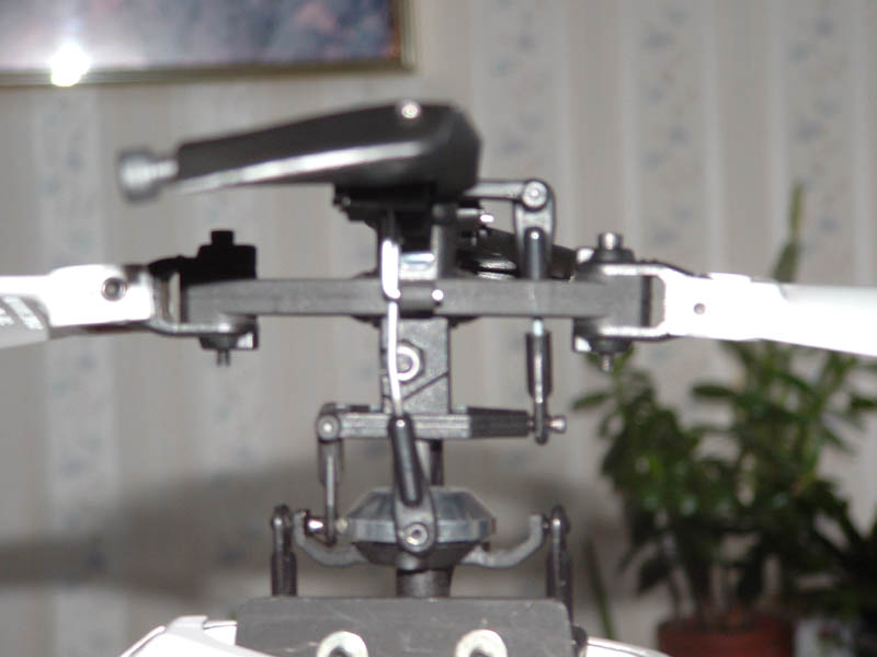

I am talking about the hub. It has a slight tilt to it that was noticed during initial assembly. Not knowing anything about helis at the time I was building it, I ignored it. Now, however, I wonder if it should be replaced. It causes the feather plate to be slightly tilted.
The heli flys ok, but could it fly better with a new hub. You can see what I mean in the photos if you look at the left side of the nut in the hub. The blades track well....
What do you think.
Dick
P.S. The crutch poking thru, is an extention that raises my rotors by 1"...

It may be my failing eye-sight, or it may be an optical illusion . . . . but to me it look as though your main shaft is just a little bent. But if it flys ok I'd "leave it alone" - seeing as how I never fix anything unless it's well and truly broke (now that really is "just me!")

I had a hub that appeared "warped" sometime ago. Mine was due to crash damage however.....it was actually cracked.....you had to look really hard to see the crack. It did cause vibration so I replaced it. If it is much off center it would act the same as a bent M.R. shaft.

I raised it an inch, because everyone tells me it makes the heli fly better. So far, I have noticed no difference with the stock length, or the one I made out of music wire. The boom strikes are the same too.
I still have the stock 4/6 grips, maybe it might be more stable with two 4's. I don't know.
The main shaft is straight as I can easily roll it on a glass surface.
The hub came that way....it looked peculiar, but hey, I never built a heli before.

Dick , My hub has looked like that since day one , kinda cocked looking . Just assumed it to be correct , never had a problem though .

my corona looks the same as well. I think its in the design. Plus if you notice that the sub-rotor stablizer is very flexible I havent noticed this with larger helis. I think this is the norm for the corona.
