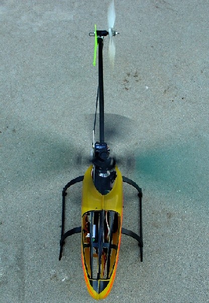

FYI Here is how I cut my canopy to provide the awesome cooling I've obtained right now. It won't win any prizes but it does help me more with orientation vs. not having a canopy at all.
[sm=rolleyes.gif]
Ron

Hey, that's a nice looking bird you got there. When you said swiss cheese, the first thing that popped in to my head looked like something the dog got a hold of. I ordered darthdrk's hughes 500 d body this morning, and if the temp is to high when it goes on the heli, I might duplicate those slots you have on the bottom of your body. Right now I use an old beat up LMH body. Probably will for a while.
