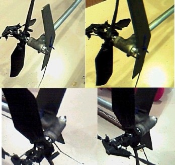

Tail rotor gearbox on LMH cracks and breaks on tail strikes: Tip- try putting a couple layers of fiberglass over the gearbox. No more buying a gearbox. Note: do this before it break and rough

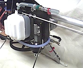

When you decide you need a new crutch think about building it backwards. I did this so that the exhaust dose not hit the main gear or spur throwing fuel everywhere. Its almost ready.
If I get a camera for Christmas I will post some pictures.

Well I Hovered the heli with the new cruch built in revers, and it works I only had to clean off the back of one skid.
No more fuel mess!
The only down side I see so far is that the glow plug is harder for me to get to it is on other side. But I don't care it is worth it.

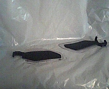

I wanted to try the bigger blades on tail of my lmh have (LMH 110 BLADES), BUT thought I had nothing to lose buy modifying the old ones. They work great much more response.
I just glued on some clear plastic to blades. Made them a 1/4" bigger all the way around.

Ok, heres a pic of my gearbox. I never did paint it. I was going to. If and when you do this, make sure you rough up the outside a little so the resin would adhere better. I figured on this fix after loosing about three gearboxes in a short amount of time. Dont use the fiberglass cloth you get at the autoparts store. You have to use some finer cloth. Wrap the gearbox several times. This has been a real cost saver for me. Get an old tailboom and rub candle wax on the end or a fiberglass form release agent and insert that end in your gearbox. gives you something to hold on to when doing this. Im getting ready to do another gearbox. but going to add a plate to the gearbox so I can bolt my tailfins to the gearbox. Hey, this is fun.
