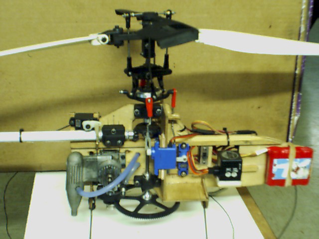

JR man my self.
331 on my tail at the moment will replace as they go.

CrocEnd, Ive seen some interesting Lmh rigs but I think yours has got most of them beat. What size engine do you have mounted in your LMH and i noticed that you have it on the otherside of the crutch. Is that a pressurized tank? How did you tap the muffler?Looks like there is a linkage missing from your swashplate assembly. How well does you heli fly ? I notice that one of your cyclic servos is mounted different too. Does this work better? Clue us in. Did you do a collective pitch modification on this?

I bet it's a collective pitch Mod.
Hey CrocEnd tell us more about your set up, And please put some Pic in your gallery

yeah lets see a pic of the other side of that rascal...Rog

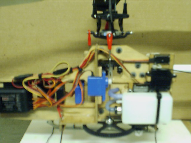

Joe k Yes a mod., it is and colective ccpm.
Darthdrk A reverse crutch the engine OS fsr10 very old
and tied, pressure by normal nipple but at the back of the
muffler easy to feed from tank or to tank. The fuel tank is
2 oz header tank.

So, how does it fly ? performance? What did you do to make the .10 work? Longer shaft? drill out the clutch shoe...?

Like I said .10 old next to compression will not sustain full power longe enough to get a circuit in. the hover not bad
rpm 1850 not high enough. Tens to sag when hot.

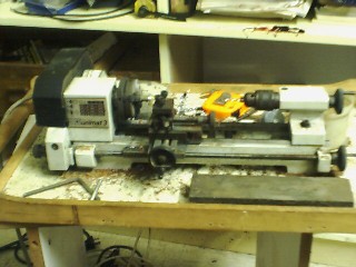

Clutch is .061 and threaded shaft. I cut the .10 crank close to end of thread off, drilled and taped crank with
5/40 tap set. Took aprox. 5 hours steady.. steady drilling
(in lathe EMCO 3) Tapping same . oh lathe not running all
by hand turning

Shaw did.The main shaft is 3mm bought 3 old dot matrix
printers at ametur radio clear out sale.I bought them to
get the stepper motor's for cnc machine. (got 6) The sharft is the bit that keeps the paper down while printing.
The raptor parts work well. Turned down some acrylic plastic to fit in as bushings.
