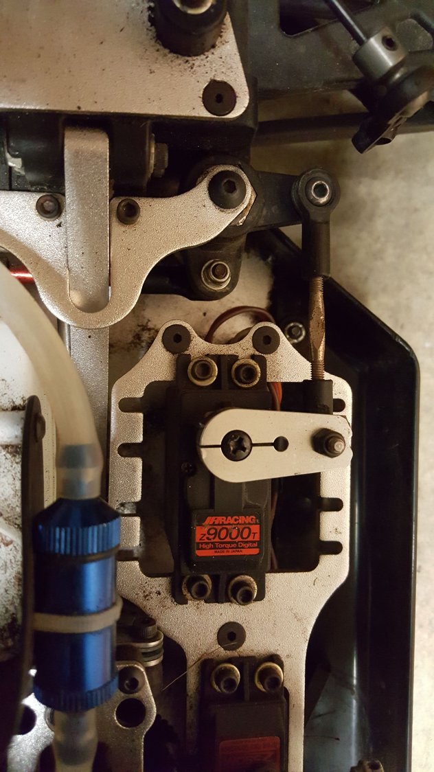

As for how a single servo is done. Like this

Thanks for posting that. I see there is nothing connected to the other side which is what my concern was about this "mod". I could see this mod being possibly necessary in a racing environment, but since nobody races LST trucks anymore (competitive racing, not racing your buddy on a Friday night) so I don't really see the need to do it. Dumping the servo savers would omit a lot of the slop, as will other things. I learned something new, sorta, but I will keep my tandem servos. I'm running a pair of 166oz/in servos in mine.
My Feedback: (11)
As far as not having anything connected to the other side, it's really not a concern. If you hold the tire on the side not connected to the servo yes it will lag behind the side connected to the servo every so slightly. The reason is because the drag link connecting the bellcranks flexes slightly and whatever slop there is between the bellcranks and the drag link. I had this and another LST setup with dual servos with similar overall torque and speed specs and I still feel this single setup has less slop, flex and is more responsive than a dual setup with stock LST servo savers. Never upgraded the dual servo truck to MGT savers before I sold it but both had new bellcranks and rod ends to eliminate slop from wear.
Whether its it's necessary or not is open for debate. I don't think it's necessary, I did it as an experiment on a truck that needed servos anyway and I'm very happy with it and like the feel better but that's me. Ideally the truck would have a bellcrank setup more like a 1/8 buggy with built in servo saver but that's not the case unfortunately. I was also concerned with the servo surviving despite others who came before me breaking aluminum servo horns and the servo being fine. That's why I initially went with heavy duty plastic horns to provide a sacrificial part but got tired of replacing them and went aluminum. Btw my Hitec is 333oz on 6v but with the external bec cranked to 7.4v it's 416oz.

Muggy single servo mod
Necroing an old thread because I'm bored. I went with a single servo setup in my Muggy. It was an extremely popular mod at the time and greatly improved the steering (along with a tire change). I used a JR Racing z9000t, which was a pricey high torque servo back in the day. No servo saver.
