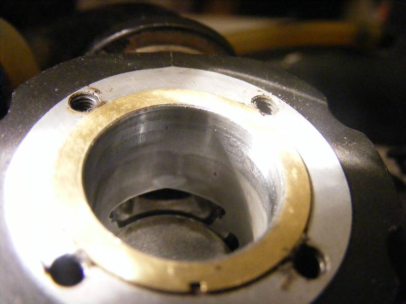

How do you know when you've lost the compression so much that the engine won't run? My LST2 won't stay running for very long... I had it running today... ran it for about 10-15 seconds, and it died.. and never started again. I pulled the head and peeked in... it looks like the piston is pretty loose in the sleeve... and when it goes up and down, I notice a layer of fuel/oil on the sleeve.... I would think that this layer would be wiped from the piston... am I wrong? I can also see a visible line where the piston stops in the sleeve. None of my other engines has that... think I may need a new p/s? It only has 1/4 - 1/2 gallon through it... was broken in per LOSI instructions... anyone know if it's still under warranty?

Here is a pic of the sleeve... unfortunately, it doesn't show much... but it does seem to have less compression than my TM323...

here is something i tried .... with the head on take the engine off the truck turn the flywheel till you get resistance, holding it by the flywheel tilt the engine to the side with compression and see if the compression will hold it up or will it fall over if it holds up then more than likely its not shot if it falls then it may be gone but on a 1/4 to 1/2 gallon it should be fine unless it was ran extremely lean ....300+ degrees,................mine did the same thing but after about 7.5-8 gallons of fuel

take the piston and sleeve out, see hwo far into the sleeve the piston will go before it stops form the pinch, there should be about 1/8th of an inch gap, if you have 1/8th gap then the pinch if okay, next step is, is the head button stripped? if no try replacing the shims, still no go see if you can get it warranted, should conk out the quickly.

my glow starter has a gauge on it to tell me my glow plug is bad. The engine runs so rich for the first few tanks that it could be a glow plug that's the first thing I check. The top of the piston will tell you if you over heated it and look on the skirt of the pistons from the exhust port that will let you know if the piston is loose. I have about 3 gallons on mine and runs great and replaced the glow plug 4 or 5 times.
