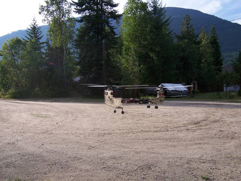

pics.
Tandem

Is that the Hirobo kit or the T Rex version? I am so wanting a Chinook but the Hirobo pricetag is a bit out of my range at the moment. I look forward to seeing more pics. What plans do you have for the body, paint sceme wise?

NO its scratch, fits in Vario chinook fuse. runs at 28A. 600mm blades 22 lb. weight

I now have 42 8-9 min flights on it , look in RunRider under tandem rotor helis vertol chinook

There seems to be no tilt on the masts, as in the 4.5 and 8.5 degrees. Do you plan on tilting the whole assembly inside the body?
