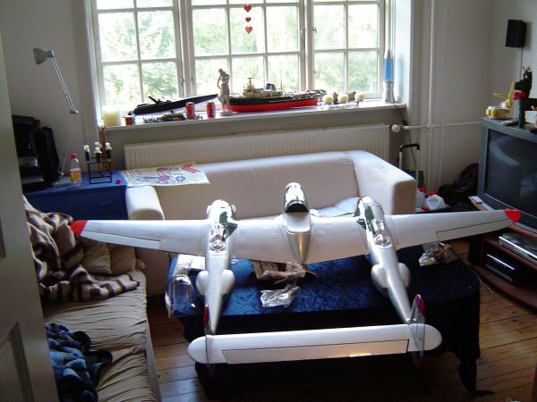

I have bougt this large p-38 that weighs 5kg un-assembled. Im guessing with 12 servos and 2 motors and glue, it will be around 7 kg`s
Do you think the MVVS 49`s and standard silencers and 11/6 props will fly my plane ok ?

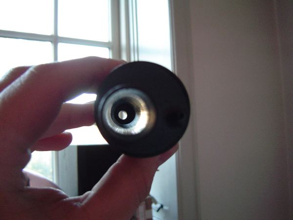

The MVVS .49 is at its best when equipped with the #3248 tuned silencer.
When using the #3245 silencer it is a standard .46-.50 sport engine, as far as power is concerned.
Its timing and compression are designed to utilize the most the tuned exhaust system can give it.

Your estimate of 7 kg seems scary.
I now have a 1.92 m plane, that I am powering with a 26 cc MVVS glow, with the MVVS tuned pipe. It only weighs about 4.5-5 kg.
If your intentions are to fly this P-38 in a scale manner, not expecting it to pull up too steeply, it would fly with the standard silencer and will need a considerable runway length to take-off. The tuned silencers will give it a respectable boost.
With the #3245A silencer, as we talked in previous threads (and see in one of the photos), it will suffer from a power shortage, with this much weight to haul; to the point of being under-powered.

With the tuned silencer, this engine is capable of spinning an 11.5x6 Bolly prop, at 13,600 RPM.
For this specific model, I would recommend switching to an APC 12x5 prop, which will be spun at nearly the same RPM, but the thrust will be about 15% greater.
From a power POV it will have more than a .70-.72 four-stroke engine.
Cooling is very important for the engine, but the tuned silencer will not be harmed by extra heat (within reason).
So as long some airflow is also available for the mini-pipe, it should be OK. You will have to replace the silicone coupling, every now and then, however.
But the engine, if cowled in, must have sufficient cooling, with a large enough exit behind it and possible with baffles that direct cooling air onto the cylinder and the head. There must be a sufficiently sized, direct flow path for cooling.
