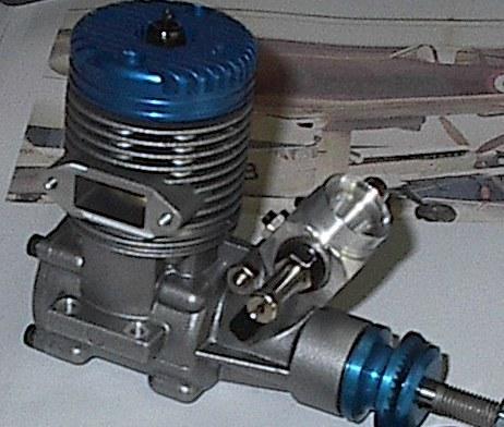

Seatonflyer,
If it is the blackhead .40/6.5 GFS/R, the carburettor is by all chances one of the older styles.
It could either have the springy main needle, or a solid one.
The older carburettor had a simple air-horn and an idle-stop screw on top.
The low-speed needle is blunt ended and adjusting this engine for a perfect part throttle mixture may prove difficult.
The engine will load up somewhat, when run for more than a few seconds, at 1/4-1/2 throttle.
MVVS offers a partial solution, with a new tapered low-speed needle and nozzle set, but despite its higher cost, only upgrading to the new #3219 carburettor works well.
The new carburettor does not have an idle-stop screw (just a locator) and the air-horn is elaborately shaped, allowing better suction of fuel, even with a larger bore.
Here is a photo of the new .49/8.0 GFS/R with the new carburettor.

Dar,
The carb has the "springy" main adjust. I will contact MVVS Canada to see if I can get the newer carb to replace the old one on the engine.
