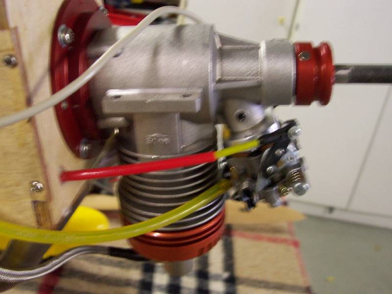

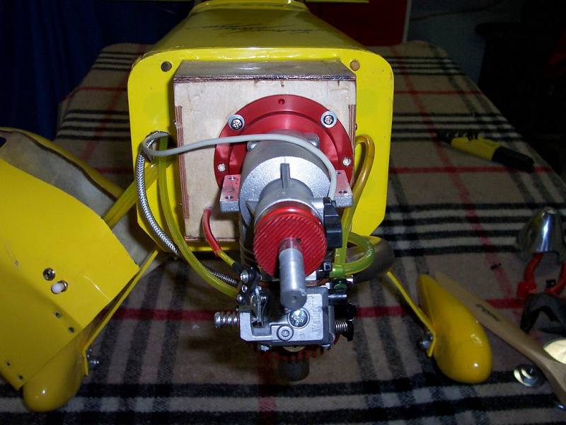

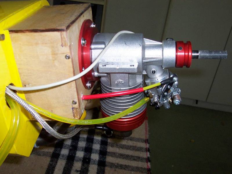

I have recently purchased an MVVS 35 gas motor and also got a round backplate mount for this engine. But I have a problem with the screws that came with it to replace the screws that hold the engine backplate. The problem is that they seem to be a little too long and with the mount on there is a small gap between the engine and the mount, about 1/16". Am I doing something wrong? Is this a common problem? Whould the original screws that came with the engine be ok to use with the mount?

Serafim,
Please measure the original back-plate bolts and the bolts included with the backplate mount.
The length difference should be roughly the thickness of the back-plate mount.
If about 1/16" is left unscrewed, they must be a bit too long.
Use an extra 1.6 mm thick washer, between the bolt's head and the back-plate mount and make sure the bolts all tighten properly on it. Alternatively, grind the threaded tips of the bolts by 1.6 mm, so they would engage to the same depth as the original bolts.
Using the original bolts would have them under-engaged in their thread, in the engine's crankcase, which may lead to the thread being pulled out...
