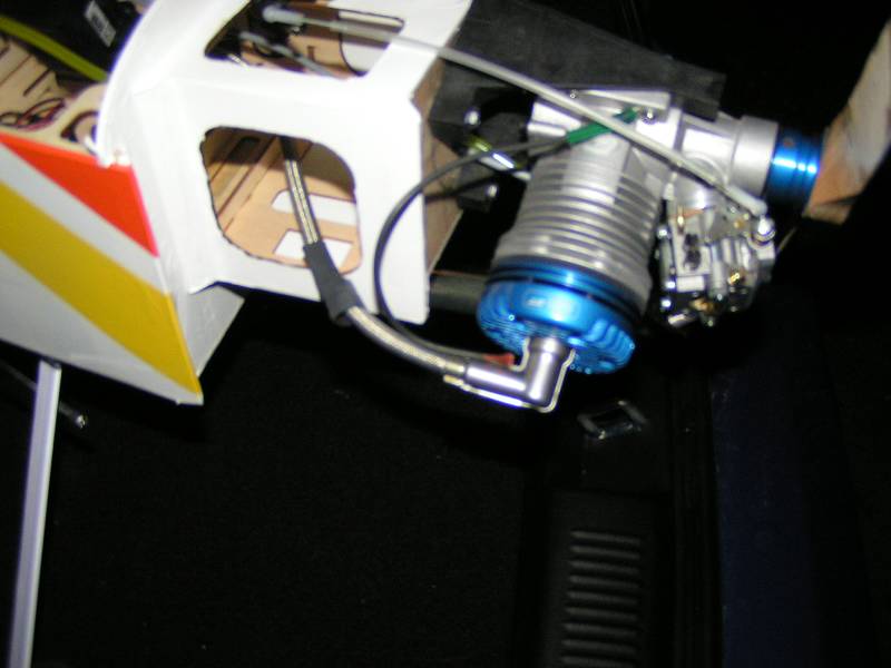

I have a question on the ignition because the instructions don't say. The plug wire has another wire that seems like a ground coming out of the cap. Is this wire needed to run? It seems like the cap should be the ground for the plug but I'm not sure. Also, do you know if this connects to the shielding on the wire as I accidentally ripped it off.

Its on the wire to the spark plug where it meets the metal cap. There is a smaller gauge wire coming out of it with an eyelet on it.

Here is picture of the broken wire where it was attached. I have it connected to the engine mount because I wasn't sure what its for.

The extra wire is an insurance, that a mass connection for the high tension spark voltage is available at all times. It may save the day for your ignition if the plug cap makes intermittent contact with the plug body.

Thanks, now I can reconnect it to the correct place and solder it instead of just a crimp

A good crimp is better than soldering. A copperstrand wire will break at the end of the solder zone when subjected to vibration.
