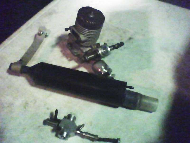

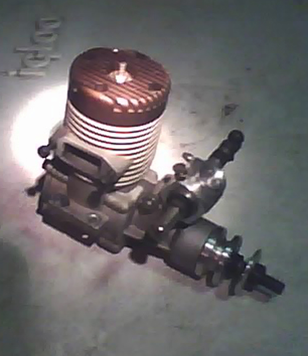

These are taken with my cell phone inmy truck so are probably not the best. I will take some with my digi cam when I get home and post them.

This seems to be the standard .40 engine.
The tuned silencer seems to be the mid-RPM #3248 (the #3246 is shorter and is intended for much higher RPM on the Quickie).
The carburettor on the engine is the older #3216, or #3219 (use a pair of vernier calipers to measure the internal diameter of the barrel... 7 mm is the standard size for the .40).

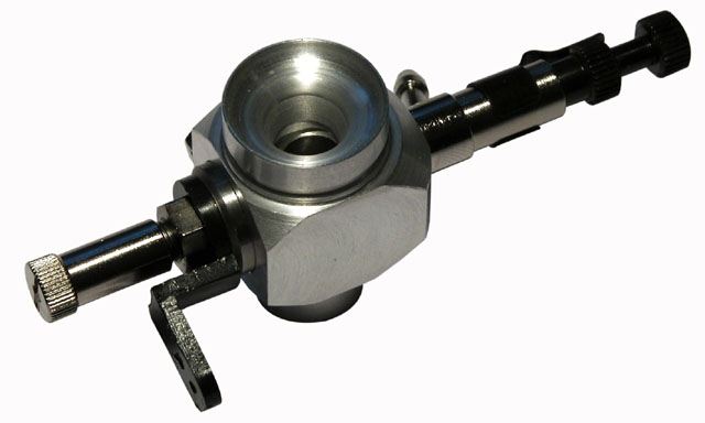

This carburettor may give you a pretty rich mid-range... MVVS replaced it with the new model that has an elaborate intake 'trumpet', a linear fuel-curve and no idle-stop screw. MVVS carburettors are rather inexpensive from abroad...
See photo.
An upgraded low-speed needle/nozzle set is also available for this carburettor, but it does half the job... The new carburettor is immensely better than the upgrade.
...The other (springy needle) carburettor is much worse and there are no parts...
It needs an [link=http://www.rcuniverse.com/forum/m_1850473/anchor/tm.htm#1850473]ABC type break-in[/link], with a lot of castor oil.
Use fuel with no nitro, or up to 5% max.

The new carburetor has the same number as the old one; #3216.
The #3226 carburettor is intended for rear-mounting in the rear intake GRRT engine.
This engine is no longer made and MVVS may still have some of these carburettors in stock, but it will not fit onto your engine anyway.
MVVS dealers who respond in this forum have some new #3216 carburettors in stock, however.
